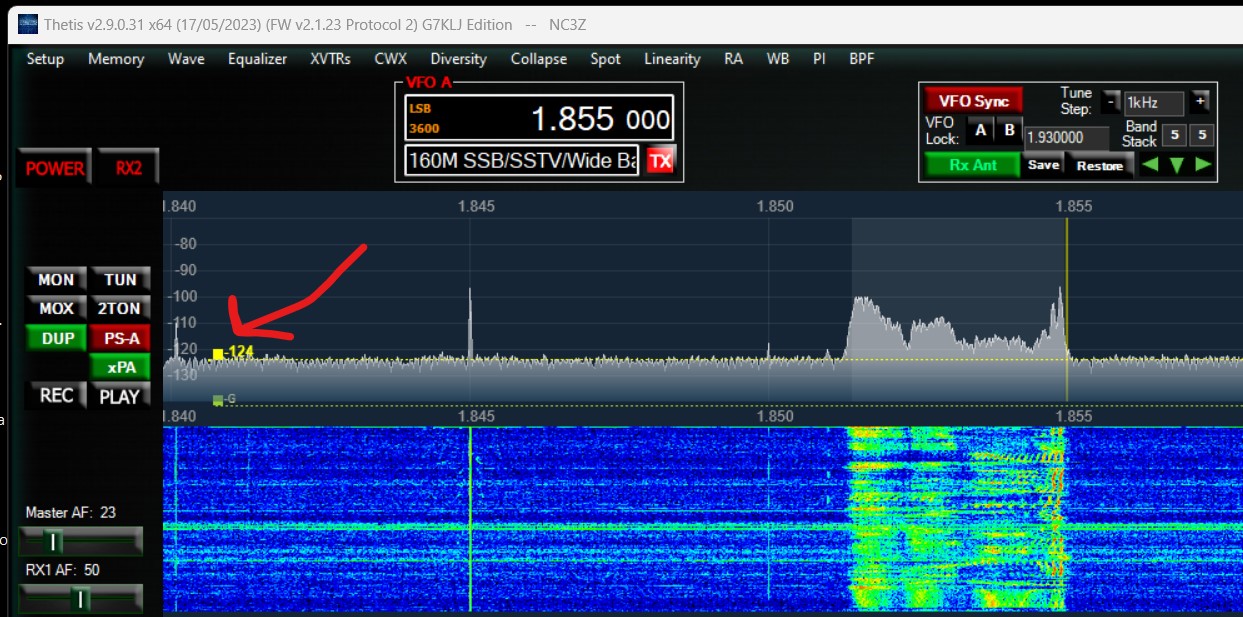

Even though the various settings for the nose floor line persist, the noise floor line seems to gone from the display.
When did this happen?

Without having a refence for your issue without some screenshots I am going to take a guess at what you are trying to ask:
Are you talking about this line:
Screenshot 2023-06-07 203608.jpg (238.74 KiB) Viewed 2605 times

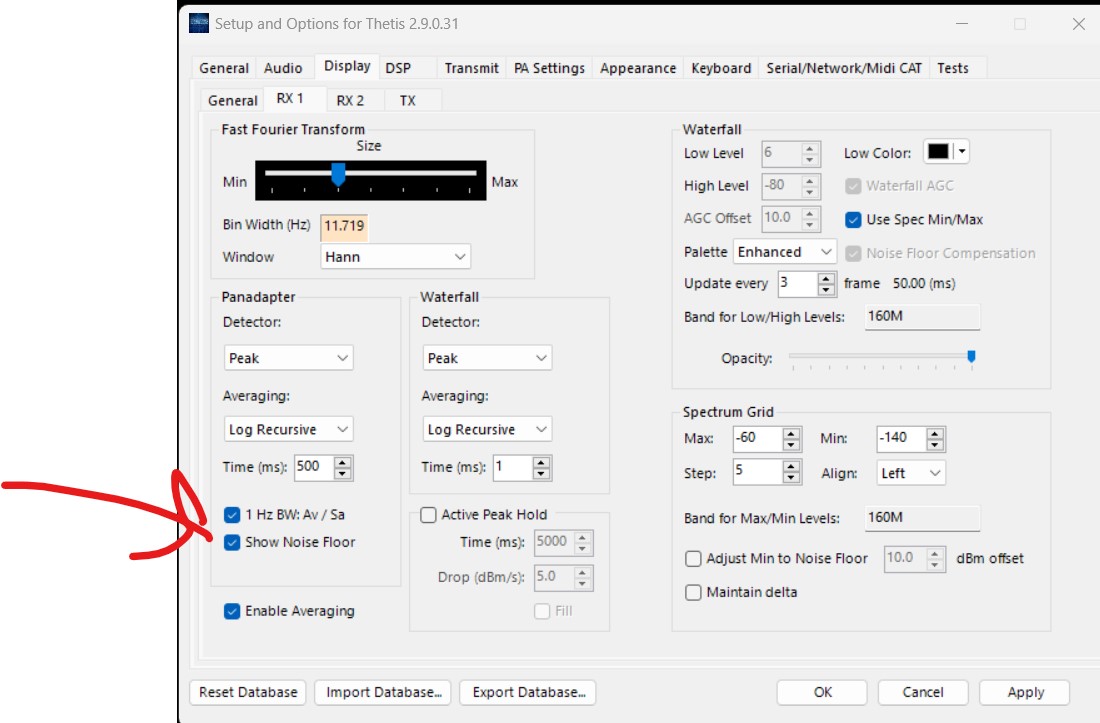

If so do you have this set?:
Screenshot 2023-06-07 203634.jpg (118.58 KiB) Viewed 2605 times

Thank you! Clicking the check box found bottom-left in the Display>Rx1 fixed it.
