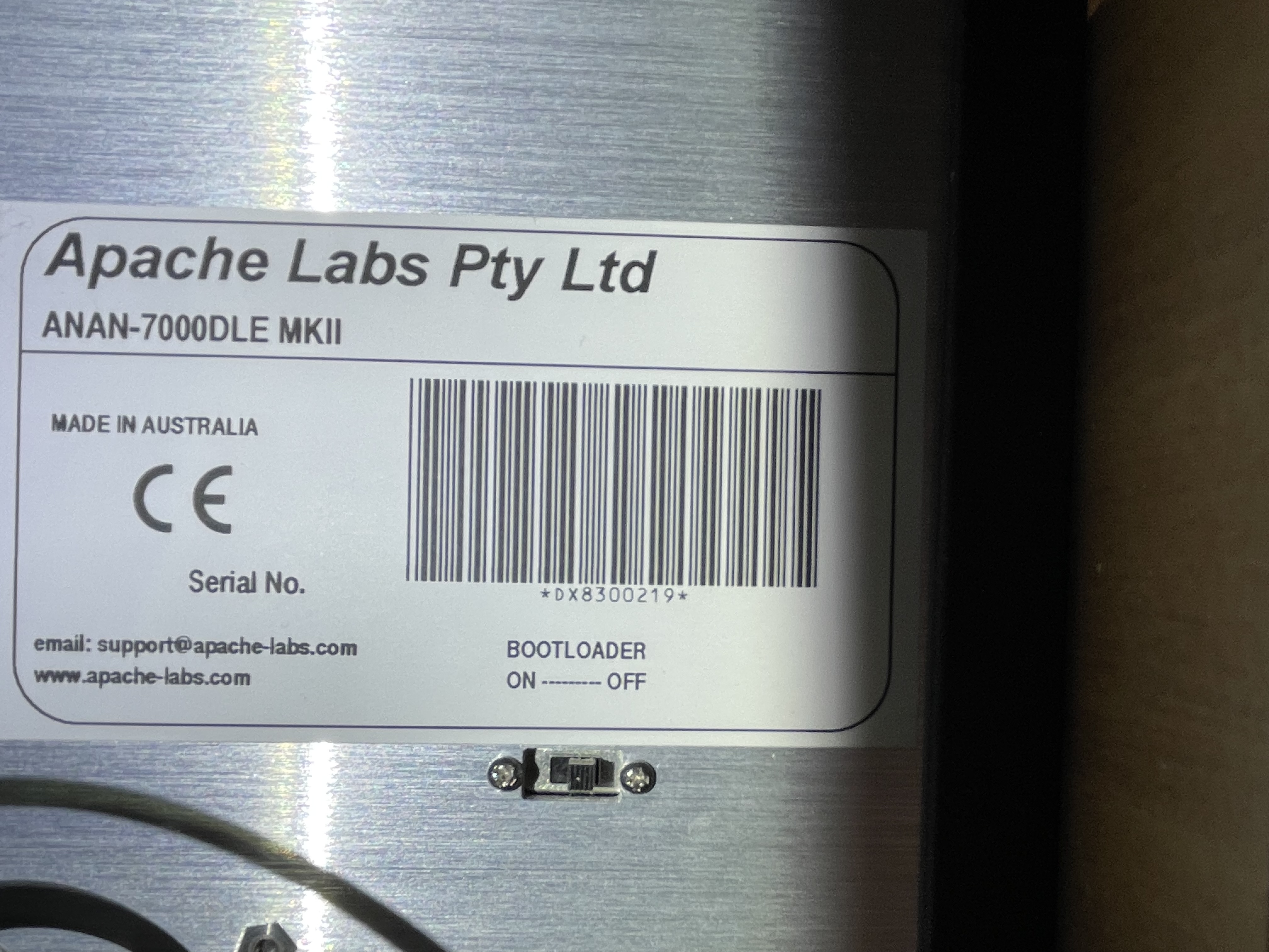

Mike, what is your radio's serial number?
Re: Bug in DUP displayed power level--need someone else to test & confirm
My serial number is 7000DLEMKII081.
Well, now that is confusing. Mark and I have the same prefix before the number but Mike yours is completely different.
Apache really needs to get with the program and start labeling things with some kind of logic behind it. Or at least some kind of logic that makes sense. Maybe it makes sense to them?
Just to be complete here's my label.
Well, I guess we can assume, just going by the number, that Mike has the latest version, Mark yours is the oldest and I'm in the middle.
