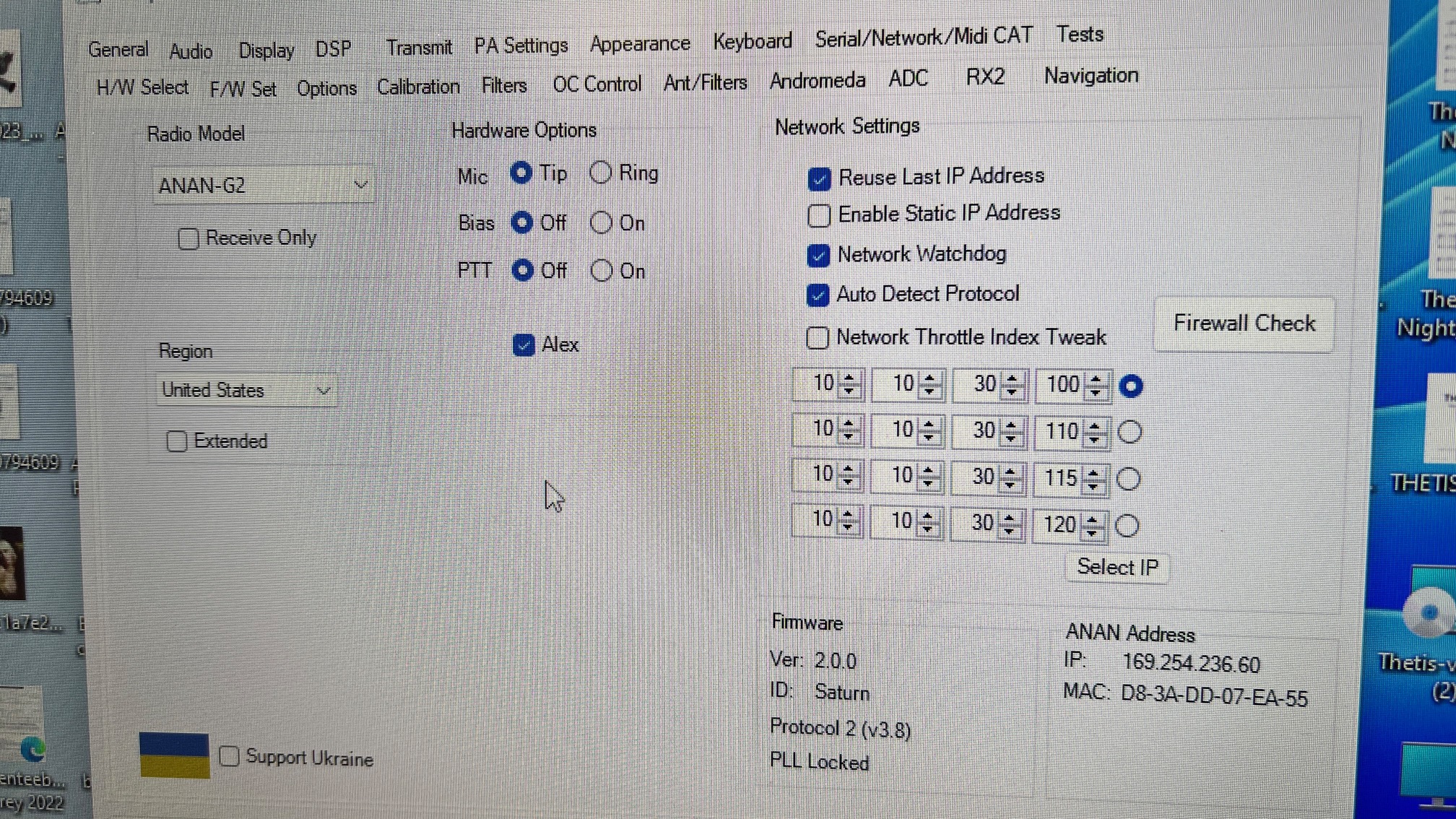

Hi Torrey,
I suspect what is happening is the mic tip is acting as ptt ground. I suggest to read the Saturn manual there are some gotchas if you do not accustom yourself with it.
You can change this setting in Thetis Settings -> General -> H/W select and under hardware options set Mic to ring instead if tip. This should stop the radio going into MOX when you plug in your mic.

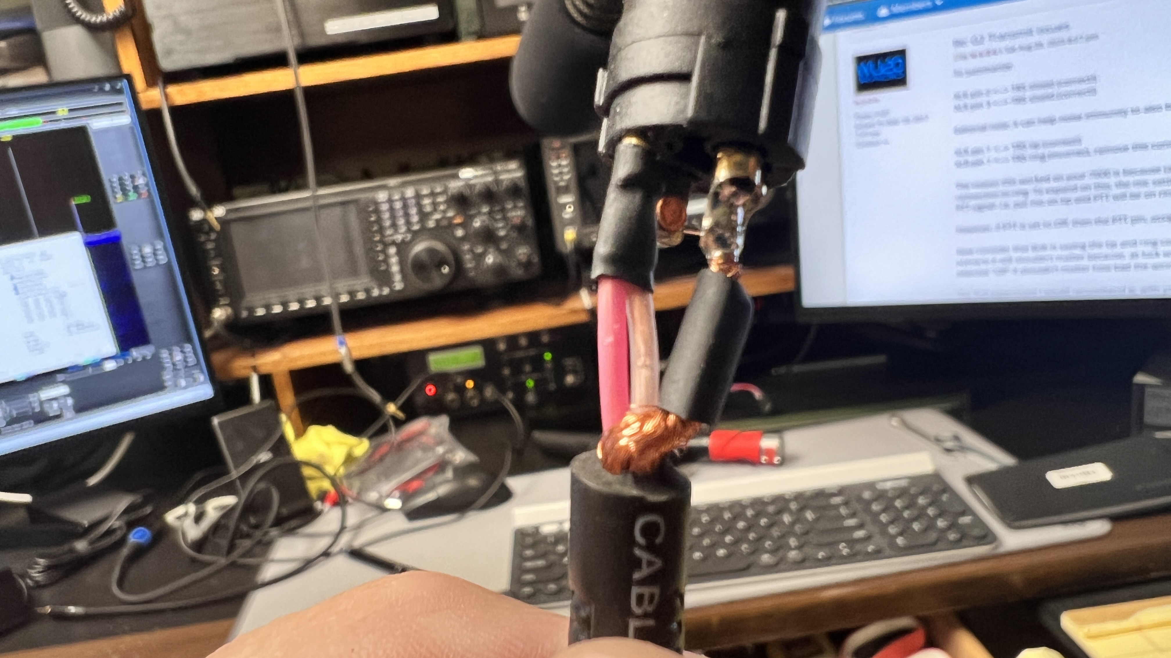

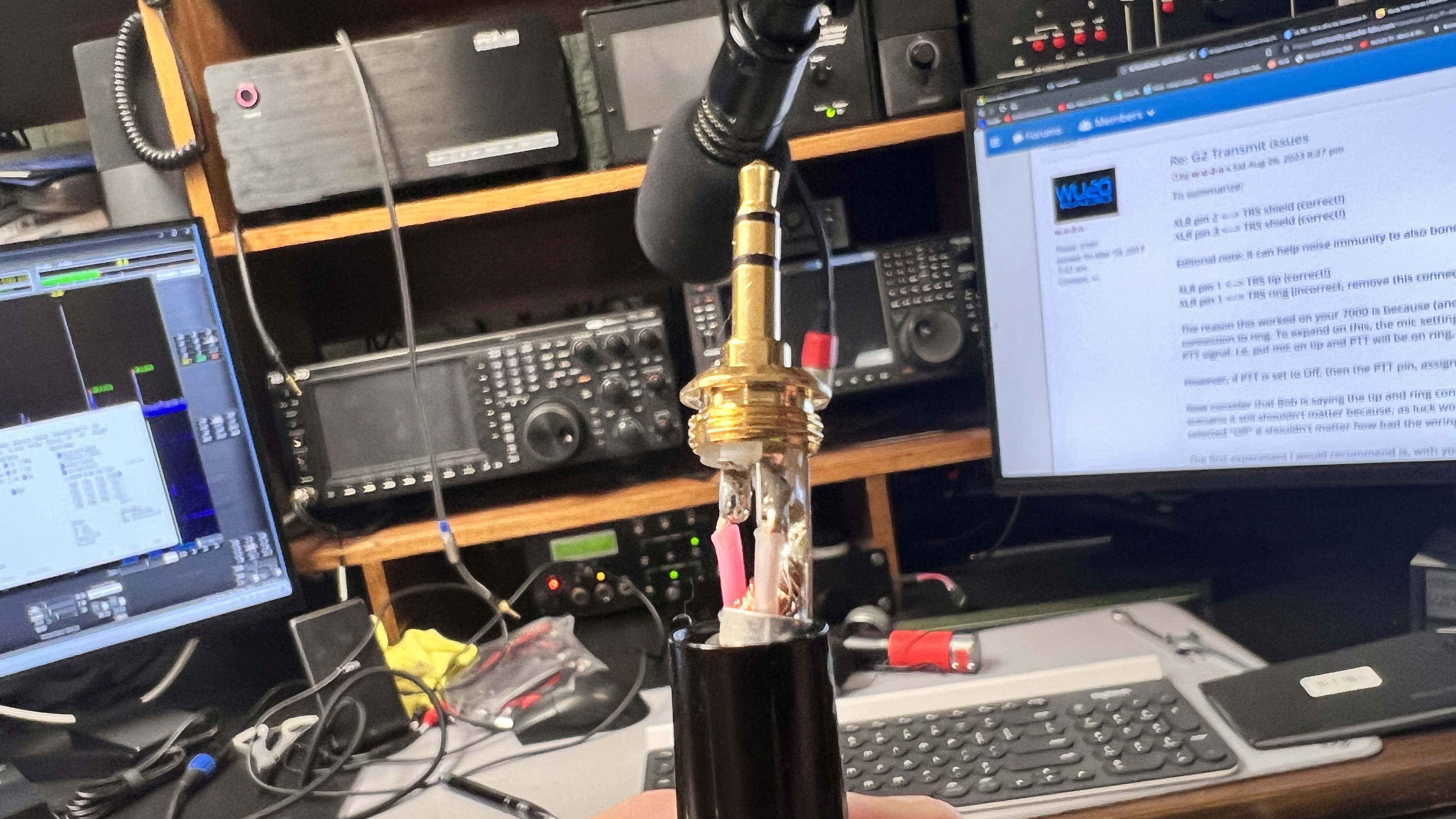

I pondered your response, and decided I needed to open up these connectors to see "what goes".
Attached are photos of both the XLR connector and the TRS plug on the patch cable.
It all made sense once I did that. At the XLR end, both the mic audio output and the audio return wires were soldered to XLR pin 2.
Pins 1 and 3 were soldered together to the shield.
At the TRS end, audio output went to the tip, audio return went to the ring, and shield went to shield.
I clipped the audio return wire in the XLR, leaving only the red audio output wire going to the tip.
The MOX now behaves normally. The spacebar PTT function not working. The highlight on the PTT selection checkbox blinks as I push the spacebar; but no action. I don't really care. I plan to setup a PTT switch plugged into the back (as per another forum article).
One more thing. The MON button now works!

Would not simply going to Setup > General > H/W Select and changing Mic from Tip to Ring fix this problem?

Hi Scott.w-u-2-o wrote:Would not simply going to Setup > General > H/W Select and changing Mic from Tip to Ring fix this problem?
That was the first thing we tried, but unfortunately the audio hot lead has to go to sleeve (shield), not ring. (I know, crazy right?) I couldn't believe it at first, but eventually had to rewire the mic plug accordingly or use only the rear mic socket.

Update on the front panel mic input:rbanasik wrote:My experience with the XLR-labeled connector revealed a persistent echo in the audio chain. I noted that the XLR-labeled connector (a ¼" TRS) was plastic and offered no path to chassis ground resulting (I suspect) a ground loop formed by the floating connection from the PC board ground to the shield connector with no path to chassis ground. Once I switched out that plastic connector with a $1.50 metal connector that bonded to the chassis, the echo disappeared and I could connect an MXL BCD-1 studio mic using an XLR-TRS adapter with excellent audio.K0PJ/9 wrote:I received my G2 Ultra w/8 inch display a week ago. I struggled with set-up as I did not learn of the inoperable XLR connector until yesterday. What company would let this issue go for over a year??? I am trying to send the radio back for a refund but Apache Labs stopped answering my emails.
This experience occurred with my (early release?) G2 with display that I received in August last year. I still have the front reverse-wired mic input for which Doug mentioned they had no practical way of fixing. Apparently that socket is a surface mounted jack on the display PC board.
I would love to hear if anyone has a fix for that. Perhaps AL could come up with a cross-wired ribbon cable connecting that display board to the motherboard?
-- Bob - Ki1n
I implemented Volker's suggestion of replacing the ribbon cable connecting P5 on the Saturn board to the display board with pins 9 and 10 cross connected. This modification worked and the front mic socket now behaves as expected. I appreciate the help from the community in identifying modifications to fix initial defects that existed in the initial releases (shipped end of July 2023) of the Anan G2 with display.
-- Bob - Ki1n
