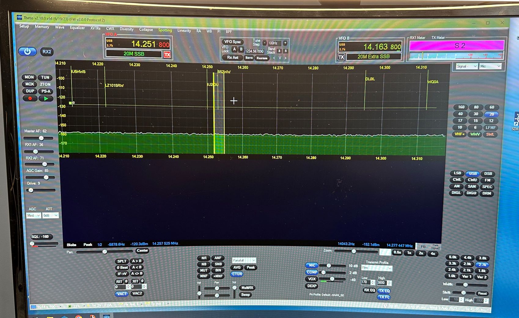

im a new Anan user, originally ordered a 7000 and switched to the G2(no front) when the others were kinda put on hold. I've been using Flex for a little over 4 years. to start, im using Thetis 2.10, windows 10 computer.
OK! received the G2 on a Monday(so excited) hooked up power cable, unplugged ant from flex and plugged into the G2(with a bnc to 259 adapter) turned on and no receive. tried several things, after trying a lot of start and stops, switching between all 3 antennas to no avail, gave up, well i tried one more time before bed and it came on and received. turned off and went to bed feeling a bit better, came in on Tuesday and turned on, no receive, on and off again several times and it finally came up with receive and got to talk on it for about 15 minutes, turned off and has not had any receive again, talked to Doug(very nice), we tried all he could think of and so i sent back to him for checking out. he sends back and says he could not get to duplicate problem, suggested it might be the adapters, he did change out a board that wasn't bad but he did try something, got rig back same thing,, no receive, ordered new cable with bnc to 59, came today and still no receive, i will include a screenshot, no difference when antenna plugged in or not, no difference, and when like that swr's are sky high, when it worked the one time swr's were normal, 1.3. im not a pi guy so I was going to try and do the pisdr but have no experience with a pi, im lost as a ball in high weeds with this not so cheap radio and I need some help if someone could and wouldnt mind helping a guy out I sure would appreciate it. ill try and answer any questions or whatever, im lost. sorry for long post but thanks for reading, one picture shows screen with antenna plugged up and no difference when unplugged and other is back with network and antenna plugged in.

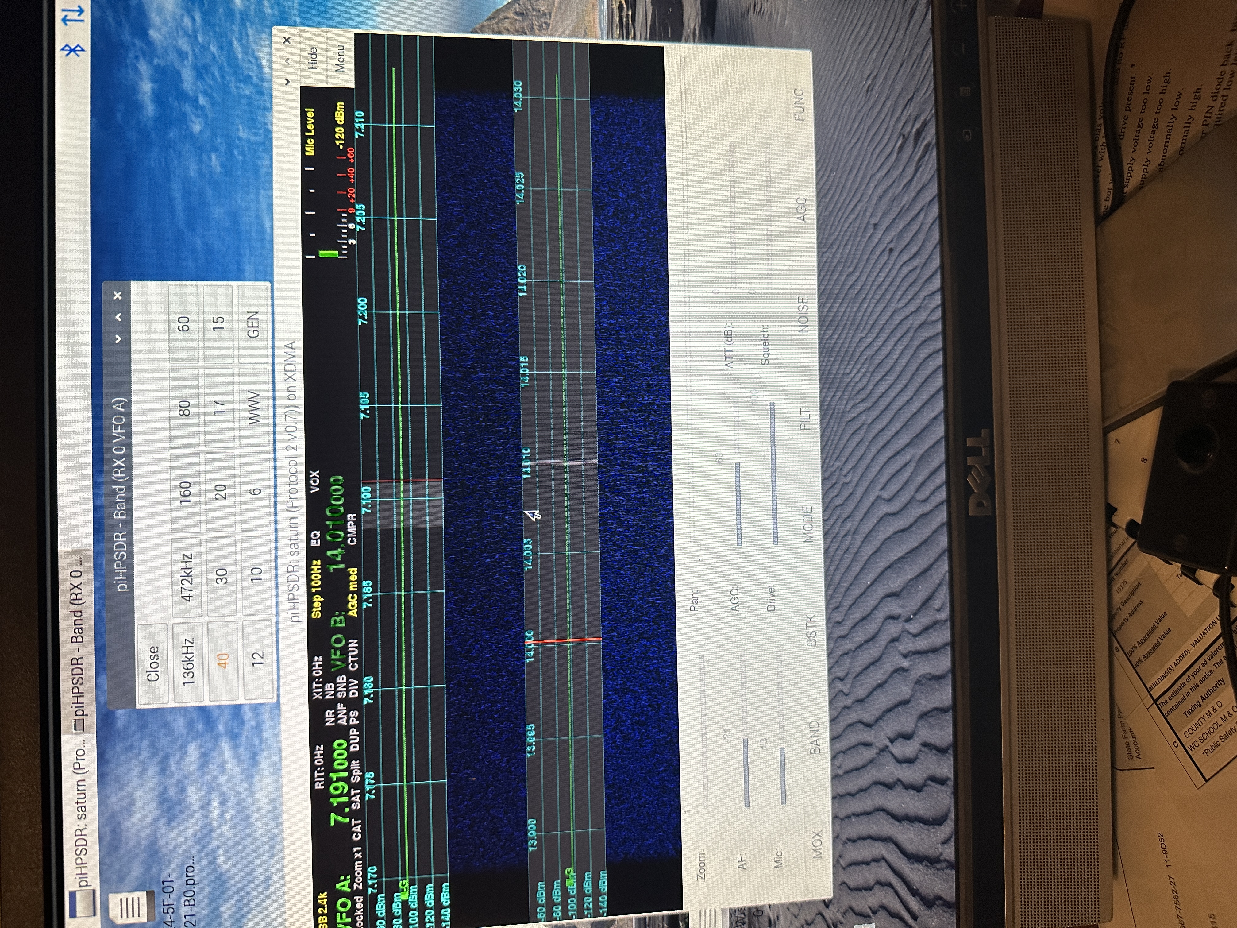

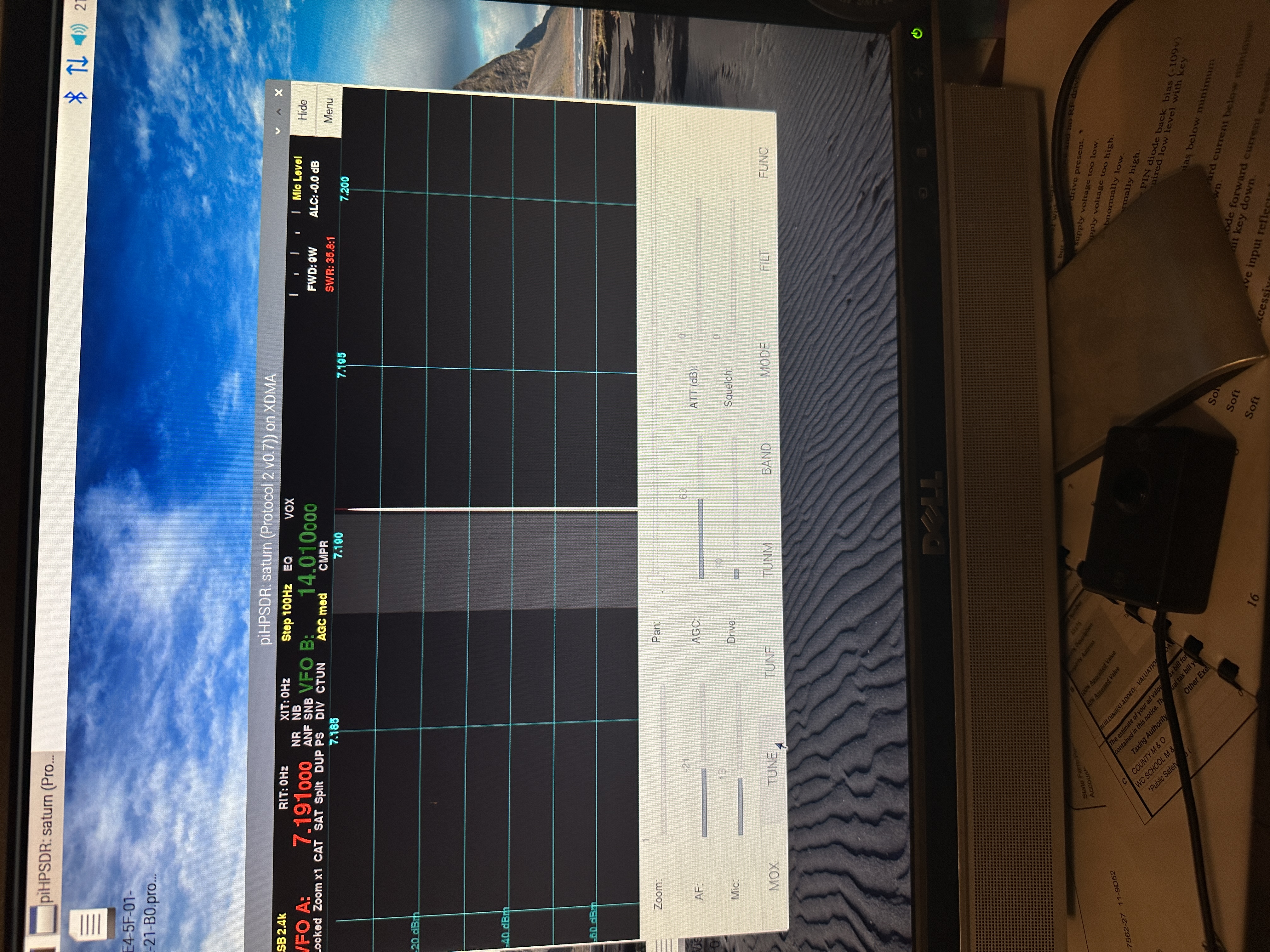

Well, here we go again, after getting very frustrated with the G2 trying to use thetis I hooked up monitor and stuff to try on PI, got the p2app killed got pihpsdr up and running for about 30 minutes, couldn't get but about 40 watts though, but hey I got to talk on it. Turned on this morning done same process and again all day no receive using PI, and when no receive SWR is sky high, almost like there is no antenna connected. I'm just about feed up with this mess. Any more ideas.

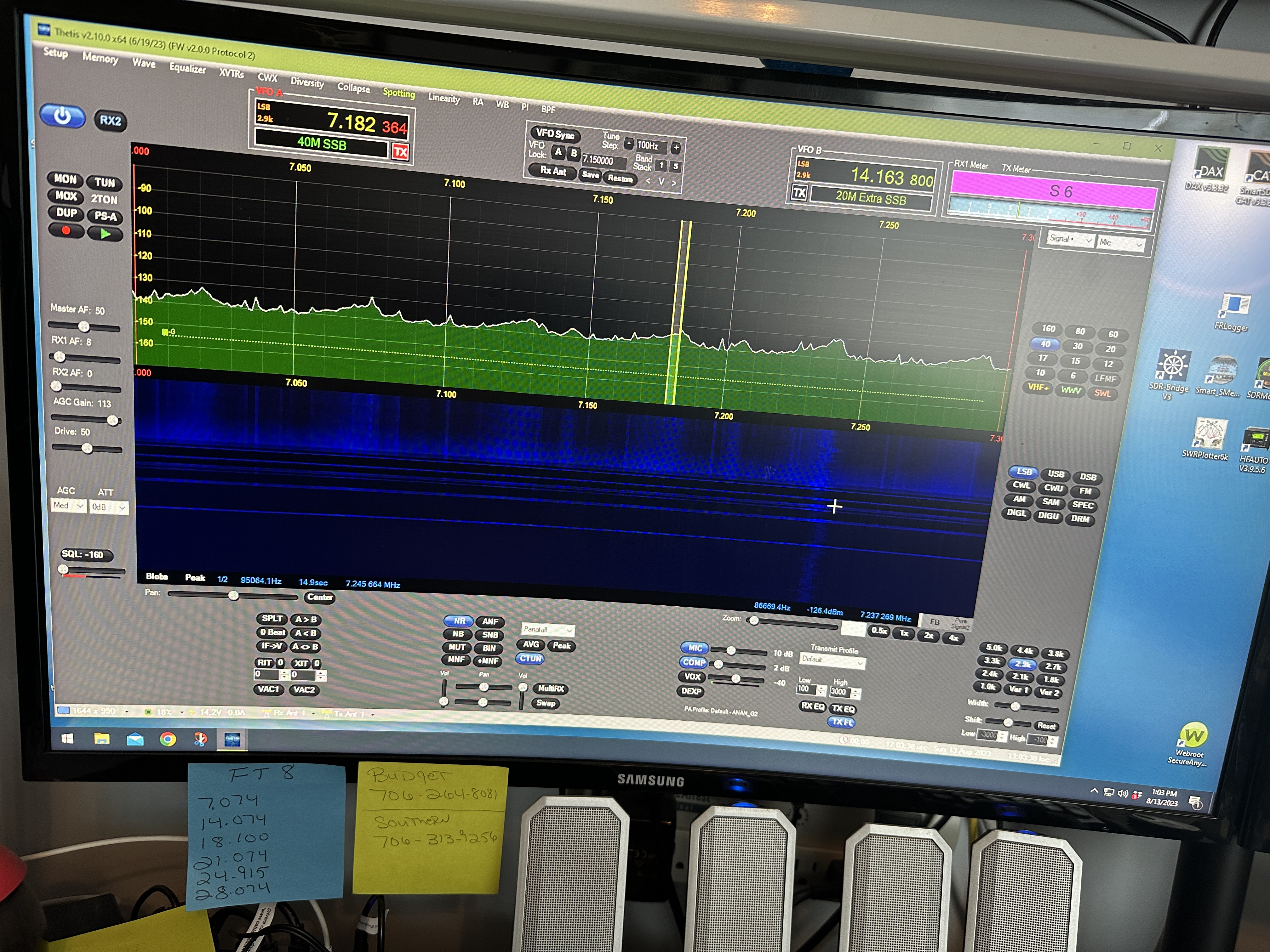

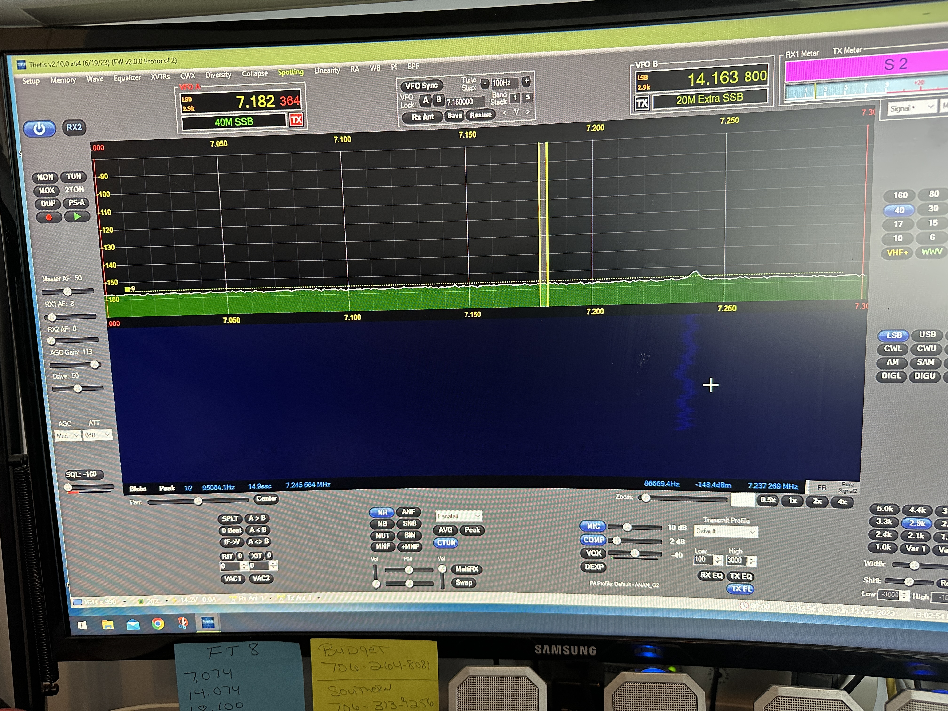

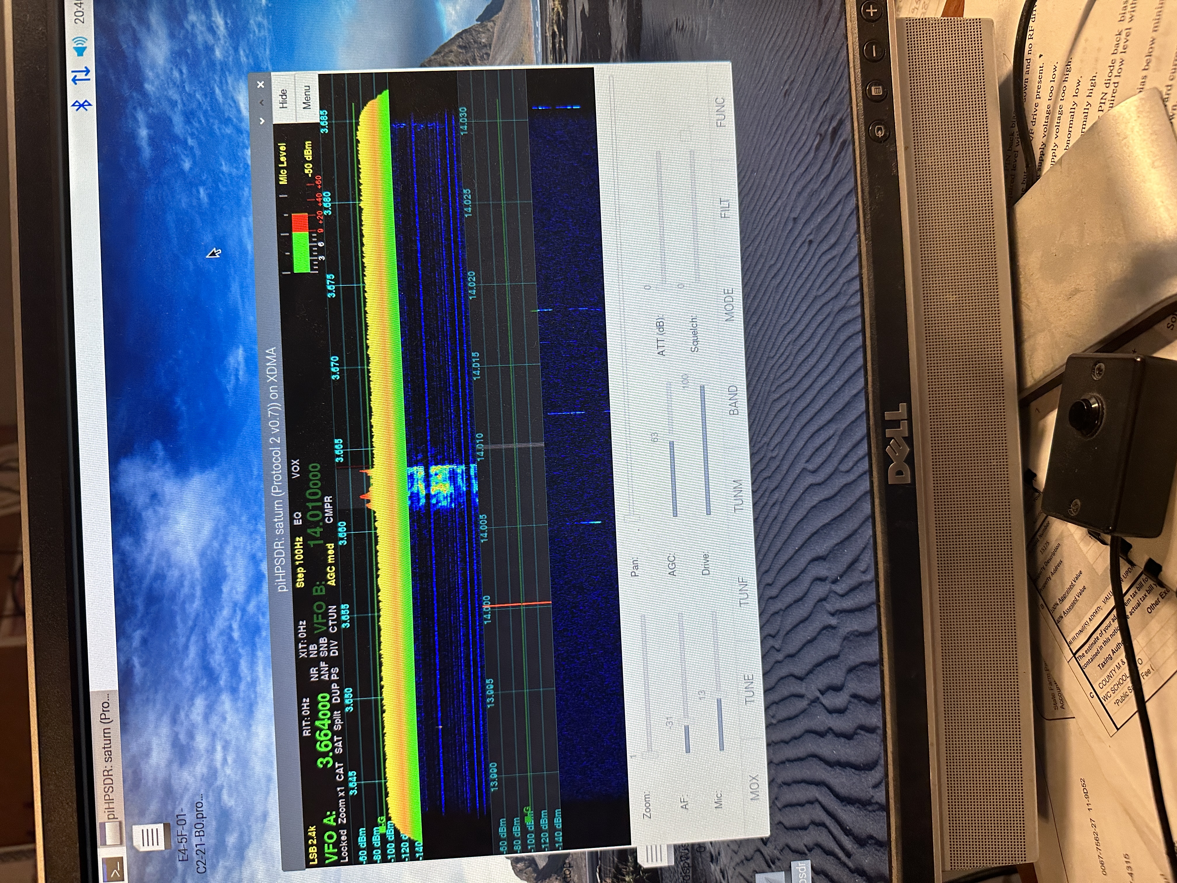

ok, turned on G2 when i got home after church, receive came up, gave me hope, then went away after about a couple minutes to blank screen again, see attached pics,
done steps as you requested and took pics so yall wouldn't think i m crazy
ok, disable transmit, done.
checked adc selections and clicked reset button,
not receiving, see pic
don't have a signal generator, but did disconnect antenna, used phillips screwdriver and touched center on ant 1, see pic, receive did increase. so i understand what you say about receive should be working, but its not, does same thing on PIHPSDR (see pic). also see pic of PI in transmit and shows in top right corner swr !
so still seems to me something is dead, im seeing no receive and high swr, indicative of no antenna to me. sorry for big pictures. bottom shows receiving in PI the other night.
thanks again for contacting me, im trying to stay calm, but starting to wear thin, have radio for about 3 weeks and getting to use it maybe 20 or so minutes.
Richard
Richard

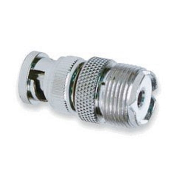

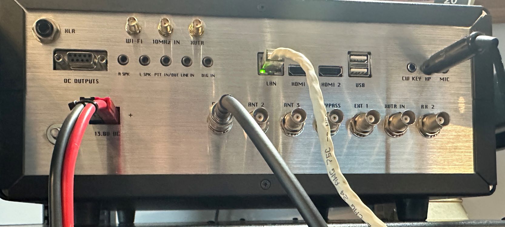

Do you have another BNC to 239 adapter that you can try? Maybe, just moving the existing cable a bit would let you know if it is intermittent.
Just a thought that occurred to me.
Maybe an adapter like this one.
- 1c8925fb-8f61-43ca-a9a3-1b8f7c130855_1.35c7a95e52dbfd7e1fae4fbf703e23ab.jpeg (18.64 KiB) Viewed 12609 times
Re: G2 - No Receive
Not using an adapter now. Bought a bnc to 259 jumper, did try adapter first though, 5 of themTrucker wrote:Do you have another BNC to 239 adapter that you can try? Maybe, just moving the existing cable a bit would let you know if it is intermittent.
Richard - KI4P

Ok, I have had problems using BNC to 239 jumpers before. That is why I mentioned it. I hope you are able to get the problem figured out.
Re: G2 - No Receive
I know, used 2 jumpers and tried 5 adapters.Trucker wrote:Ok, I have had problems using BNC to 239 jumpers before. That is why I mentioned it. I hope you are able to get the problem figured out.

Hi Richard,
Thanks for those tests, I would suggest selecting and using the ANT2 or ANT3 port for both Rx and Tx and see if you are still seeing the intermittent receive/High SWR.
Do you have another antenna which does not use the same coax that you can test the rig with on Rx? maybe just a long wire on AM to see if that gets you reception when the primary antenna is not working.
Tony

I have tried the other two ports and also receive 2 port as directed by Doug, same results. Only have one coax into house, same coax I use on the flex and it works fine, tri band yagi resonate on this bands and wires for 40 and 80 resonate on end of band where I operate.
