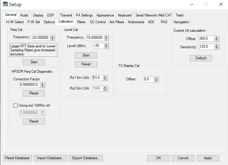

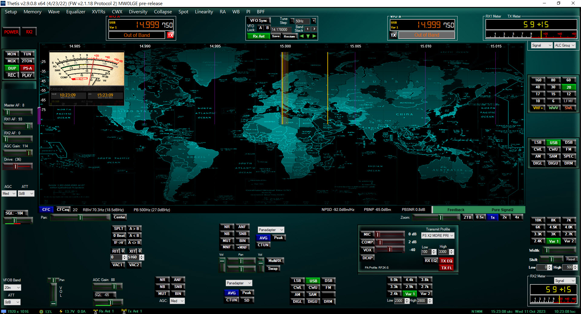

Why is it that when I inject -20dBm into RX antenna (RX2), I see the signal in RX1? Also, the S meter indicates a little shy of +50dB signal although -20dBm is equivalent to +53dB/S-9.
Update:
Disabled VAC1 and VAC2 and the S meter now corresponds pretty well with +53dB. Might as well use -23dBm level for S9/+50dB which should be good enough. However, I am still seeing the -20dBm signal in RX1 (injecting signal into RX2 BNC) not RX1.
ANAN GUI CALIB.jpg (667.9 KiB) Viewed 15085 times
ANAN DISPLAY CAL.jpg (119.01 KiB) Viewed 15085 times
ANAN CAL Form.jpg (95.52 KiB) Viewed 15085 times
Signal generator output is 14,999.75 MHz

I am NOT calibrating for frequency, but I am calibrating the S meter ("Level Cal").
In the mean-time, I had RX2 tuned to the wrong frequency which explains why I didn't see the signal in the Panadapter although I injected a signal into RX2. :roll:
The Signal generator (TinySA Ultra) compares surprisingly well with MUCH more expensive pro gear.
Looked at the Thetis database (Database.xml) after calibration and noticed that the "Cal" figures, "display_cal_offset" and "meter_cal_offset" were much higher for both RX1 and RX2 than they were before! I suppose this is normal as I had never performed the Level (S meter) before and both the Orion board and PA/Filter boards were replaced by Doug.
UPDATE: All done and I am good. I understand that RX2 actually gets its cue from RX1 as the receiver chains are the same so there was no reason to mess with RX2 in the first place.

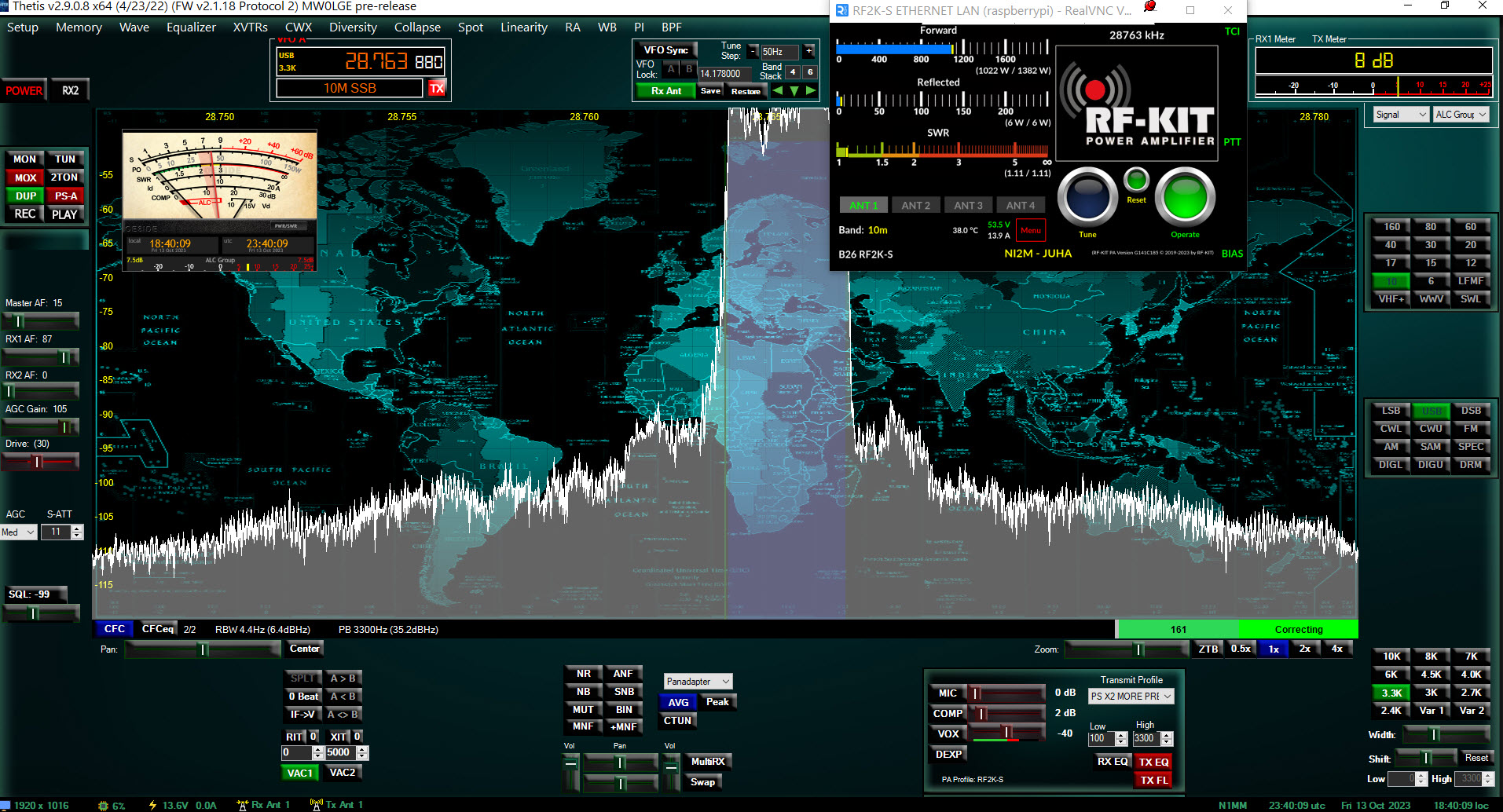

Well, I thought I was OK, but now that I look at my TX with the DUP on, I see a MUCH larger RF signature with the max of my TX being off the screen. Never saw that before. PS works as it should, but I am seeing a bottom that is VERY wide. Nobody will see it on the air though, but this bothers me.
PS skirts.jpg (657.48 KiB) Viewed 14943 times
I guess I will need to adjust display settings.
Update: Found setting for TX Grid :lol: !
