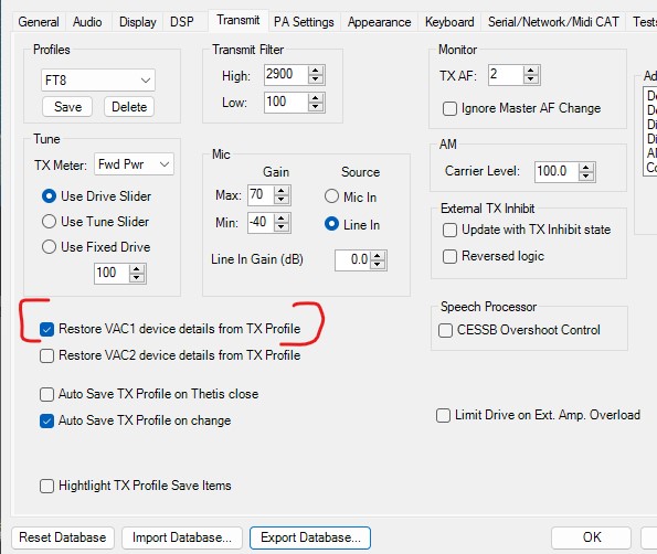

After looking at the DB it all looked 100%, however you need to enable 'Restore VAC1/2 device details from TX profile'. That option will then allow profile change to apply the audio devices that were in use when you saved the profile. Also, make sure the DIGI modes are using a different tx profile if this device switching is something you want to use.
