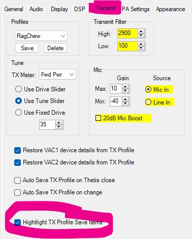

w2gs wrote: The first is to make NR2 status part off the saved profile or save it's current state until changed. NR2 is one of the best features of Thetis and it's operational state is somewhat erratic.
operational state of things like that is not normally stored against a TX profile. Just to note, the tx profile is entirely associated with the mode you are in with some limitations. Example, CW uses the same as SSB. FM uses its own, AM/SAM its own, DIGx their own etc.
You can view what is currently saved against a tx profile by clicking the option:
