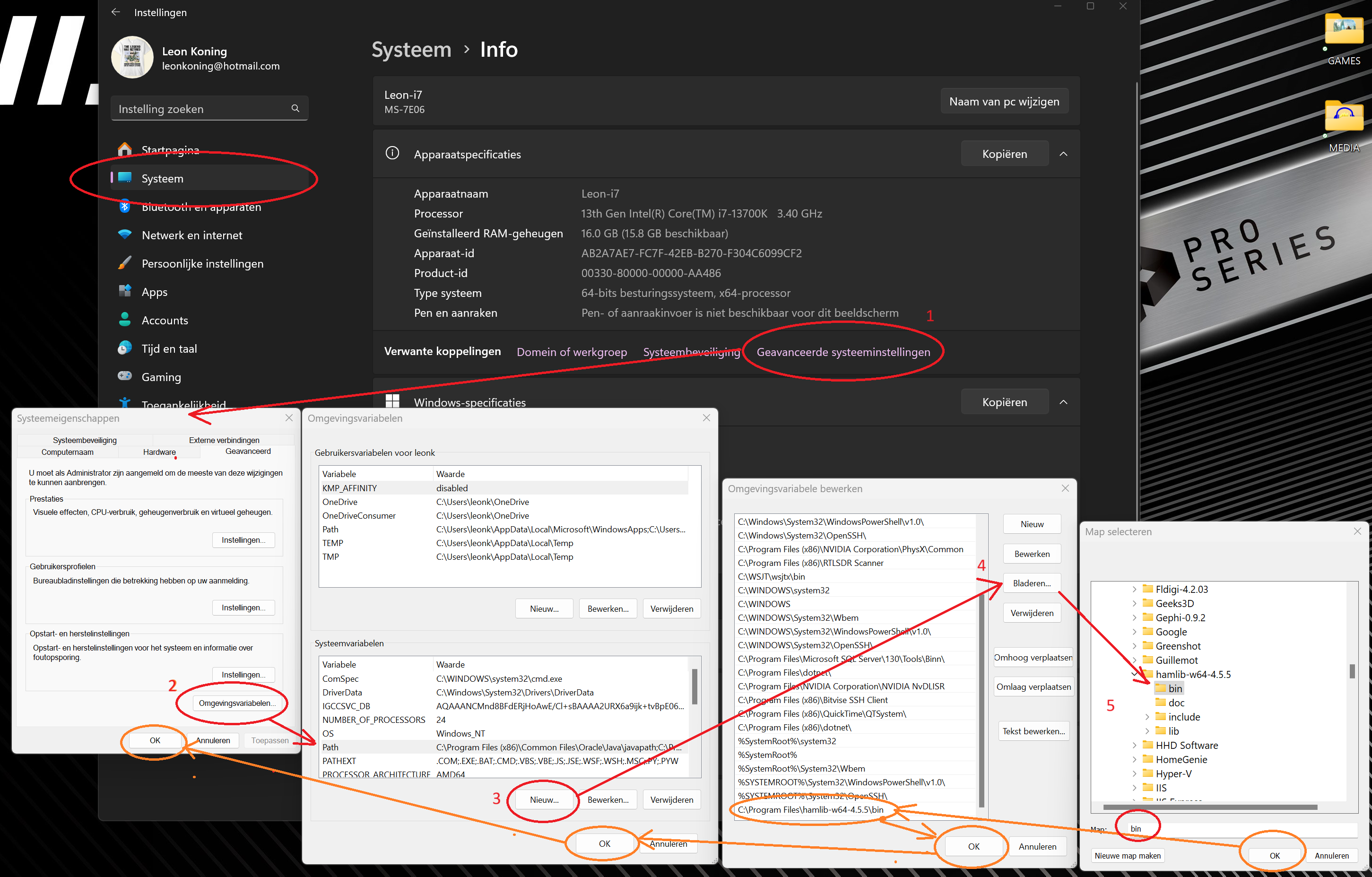

Sorry I forgot to say I have Windows 11 Home version 23H2. I have now Idea how to add this PATH variable for Hamlib!
Terry, GW4NNO
Terry, GW4NNO
Re: RTTY software with TCP/IP control to work with Thetis
Hi, no, HamLib has to be installed once.
If you can control Thetis (freq, mode) from within FLdigi than it's working fine already.
If it doesn't do that, than add the directory "C:\Program Files\hamlib-w64-4.5.5\bin" to your Windows PATH
The path (hamlib-w64-4.5.5/bin) depends on the version ofcource.
Look at attached picture, it's from my Dutch Win11 but i think it's usable, just follow the steps.
Doing this allows other programs - that are able to use HamLib - to find HamLib's DLL's.
Regards, Leon
Regards, Leon
Well, this is all very strange. I can't even find a Hamlib folder in program files on my system! Fldigi shows the frequency my rig is tuned to and the rig goes in to transmit when I click tune or the T/R button so as far as I can tell the rig control is working. I am totally confused. I didn't see any install readme about this either. Where would I find the install help txt you referred to?. All I( saw when I installed Fldigi was the license agreement. The version of Fldigi I have is 4.2.03. Maybe they have changed something since the version you have.
