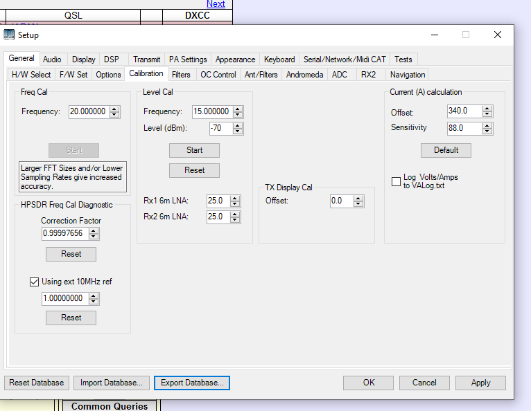

I have been experiencing since day one my Anan 7000DLE MKIII locking in two different places when powered on, I typically just run a calibration with WWV in Thetis to resolve the issue and it stays OK most of the time but very seldomly jumps back off again the correction or offset is to around 0.99997656 instead of 10.000001 or so.
Anyway I had purchased a Leo Bodnar GPS 10 Mhz source many months ago but with limited time to spend with my ANAN, I just hooked it up tonight.
My Results:
Radio is off frequency by this same margin when observing WWV but I cannot seem to enter a correction factor into HPSDR when use ext source is checked?
Pardon me for not seeing much of anything on here about using an ext source and still applying a correction factor in Thetis to get everything to be correct.?
Thetis defaults to 1.00000000 if I check the ext source and I can see the WWV carrier jump to the left of the center crosshair then my radio is clearly off frequency. It looks like I need a correction factor applied to my ext source to get this radio ON freq and hitting the reset button does nothing.
Maybe the Leo Bodnar source is not correct, but I find that unlikely... It really has no instructions to speak of with the software.
Please point me in the right direction. Thanks

I flashed to the new firmware2..2A tonight and all seems to be running fine, when checked use external 10 mhz ref it instantly came up with a correction factor and WWV being observed in AM moved to dead center in the crosshairs.
