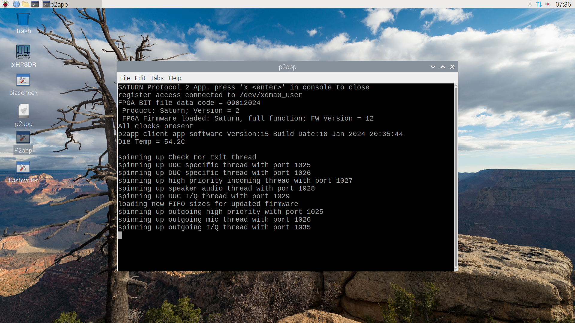

I am not an expert with LINUX, but I did manage to get the latest FW and P2_app in my G2.
When I click on the TUNE button in piHPSDR and Thetis, there is no output, but shows supply current increasing to 10A! What is going on?
I previously had versions 11 (FW) and 14 (P2_app).
John
N2KBE
John
N2KBE

Re: Script to download the latest Pro2 and P2app
Rick,
I just put back FPGA 11 FW and now it works correctly once again! Don't they try out the FW files before they release them?
John
N2KBE
John
N2KBE
I had the same problem with FW V12. You have to install the latest version of piHPSDR to have output (26th Jan 2024).
Volker
DL4ZBG
Volker
DL4ZBG
I upgraded my G2 to v12 / 15 and it is working fine, transmitting fine
using either pihpsdr or thetis. I am running the latest of both apps.
laurencebarker
- Posts: 323
By "they" I assume you mean me.JohnFT61 wrote:Rick,
John
N2KBE
Yes "they" have tried it out, and yes "they" do have power out of the radio. And "they" don't immediately know what the problem would be.
The new firmware needs to be run with the new p2app. It is supposed to detect that it is being used with older Thetis or piHPSDR so that it is backward compatible. What version of Thetis or piHPSDR are you running - none of your posts seem to identify it?
Laurence Barker G8NJJ
