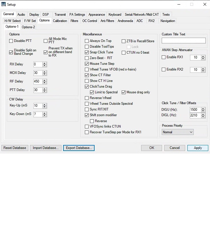

This problem occurs even without external source of latency like Voicemeeter. The problem is that the Thetis TX audio pipeline is not flushed prior to the start of the transmission.
This problem can be mitigated by setting General > Options > Options-1 > RF Delay to an appropriate value. I've never measured what that value might be, however. FWIW I use 15 milliseconds for that setting.

FYI
I have put in a delay of 450ms which temporary works around the problem. However this amount of delay is a problem
with a normal conversation if I don't pause it will more than likely cut off the first part of a sentence or call sign.
Looks as though there should be software solution to this issue. who should be contacted to ask if this could be taken care of?
Bob KC9RF
Bob KC9RF
- Anan Setup delay.jpg (132.33 KiB) Viewed 18273 times
