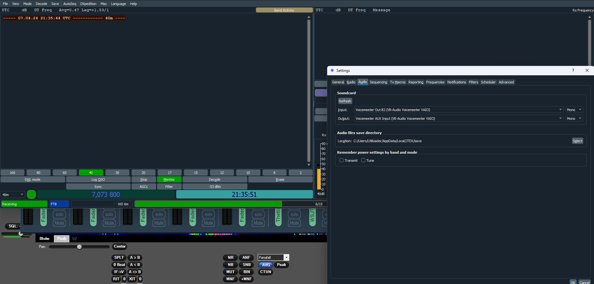

Re: Hermes Lite, Thetis, UMC 202HD, VM Potato and WSJT no audio
Done, see below attachment's:
VM Potato - Thetis & WSJT-x (JTDX Improved) Audio
WSJT-x & JTDX Improved - Audio See if it's good, so far.
Sadly I don't have a microphone yet, awaiting for my Behringer B1 bundle to arrive.
But I'll bother you later when it arrives to help me configure it.
I see on your QRZ that you use DXLab, I use it too, from several years back,\.
We can configure the audio for Winwrabbler, if you;re willing to it, to do RTTY, CW, PSK
Next phase will be voice with DXlog for contesting.
If you can help me along the way.
