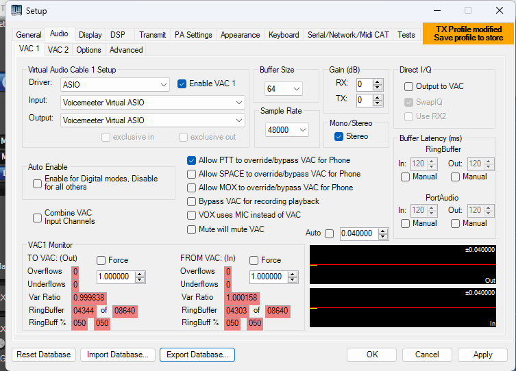

- In Thetis make sure VAC1 is activated and that Master AF and RX1 AF are set to 100. Set VAC gains to 0. Turn on VAC stereo checkbox.

Thanks for your input.
I follow your steps and I'm getting audio out on the headphones of the UMC.
Attach are screenshot's of the config till now by your steps, can yopu confirm that it's all good.
Thetis VAC config
Thetis VAC
Thetis VAC
Captura de ecrã 2024-04-07 182913.png (60.82 KiB) Viewed 16074 times

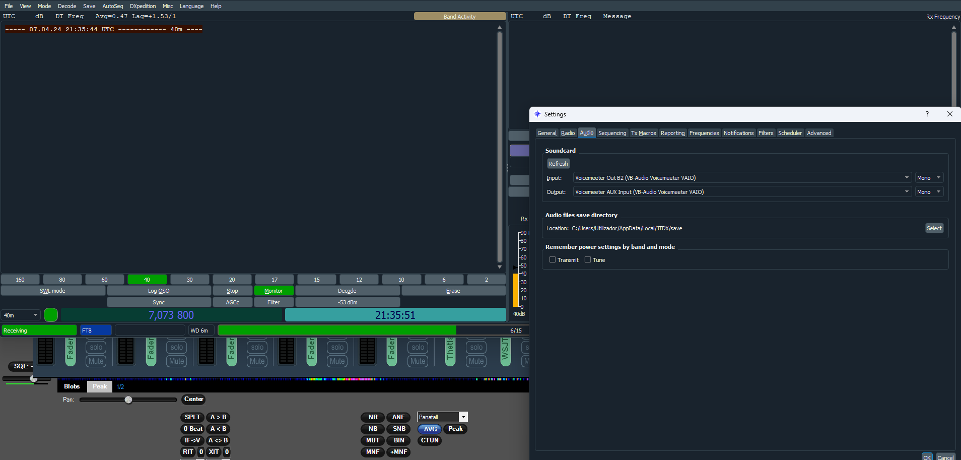

Now for step 2, getting WSJT-X setup and audio routed to it:
- Assign WSJT-X output to Voicemeeter Aux Input (this is channel strip B2, marked "Voicemeter Aux I").
- Assign WSJT-X input to Voicemeeter Out B2 (again this is channel strip B2). Don't you just hate how poorly these things are named?
- On channel strip B1 enable the B2 send button. This will send Thetis audio from B1 to B2 and thus from Thetis to WSJT-X.
- On channel strip B2 enable the B1 send button. This will send WSJT-X audio from B2 to B1 and thus from WSJT-X to Thetis.
Note that the volume control on the UMC202HD will not affect levels between Thetis and WJST-X.
Now you should be able to have WSJT-X work correctly for both transmit and receive. You may need to adjust the level going from Thetis to WSJT-X. You can do that in a number of places depending on your personal preferences: RX1 AF, VAC RX gain, or the slider in Voicemeeter.

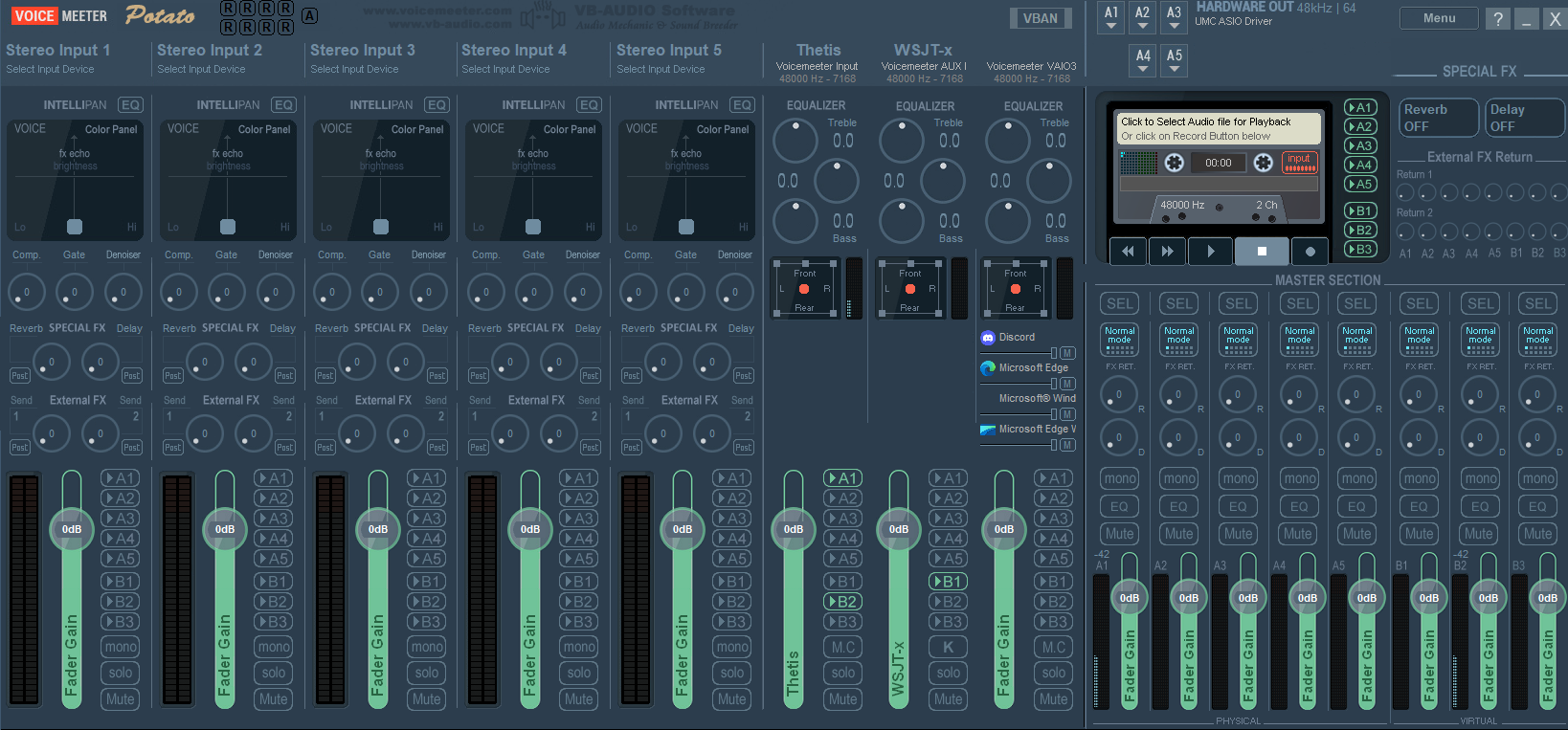

Done, see below attachment's:
VM Potato - Thetis & WSJT-x (JTDX Improved) Audio
Captura de ecrã 2024-04-07 223509.png (197.89 KiB) Viewed 16048 times
WSJT-x & JTDX Improved - Audio
Captura de ecrã 2024-04-07 223559.png (116.19 KiB) Viewed 16048 times

Re: Hermes Lite, Thetis, UMC 202HD, VM Potato and WSJT no audio
Posted: Tue Apr 09, 2024 11:13 am
Nuno,
Now that you've apparently got WSJT-X working, the rest is easy. Voicemeeter will happily allow more than one application to share a channel strip if they are not using ASIO. Since none of the digi mode app's use ASIO, you can simply set them all up like WSJT-X and run them all on channel strip B2 at the same time.
If for some reason you wish to split them up a bit, you can assign some to channel strip B3, "Voicemeeter VAIO3" the same way you did it for B2. At this point you have probably achieved a good understanding of the send buttons in Voicemeeter, so don't forget to send audio from B1 to B3 and B3 to B1.

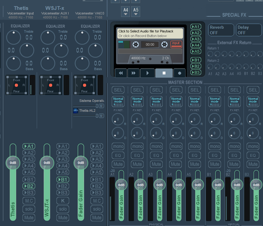

One thing that I notice, was that Thetis pass to Vaio3 but still works like is on strip B1, look at the attach
image.
Thetis
Thetis
Captura de ecrã 2024-04-10 121644.png (112.27 KiB) Viewed 15844 times

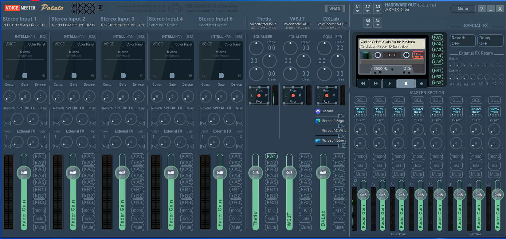

So for Winwrabler,
I just choose the Input as Voicemeeter AUX Input
And for output Voicemeeter Out B3
Then Send B1 to B3 and B3 to B1
Correct.

One mistake. If you wish to use strip B3 "Voicemeeter VAIO3" for Winwarbler then...
For input choose Voicemeeter VAIO3 Input.
The rest is correct.
However, as I posted above, remember that you can simply have all digi mode programs use B2, the same as WSJT-X.
