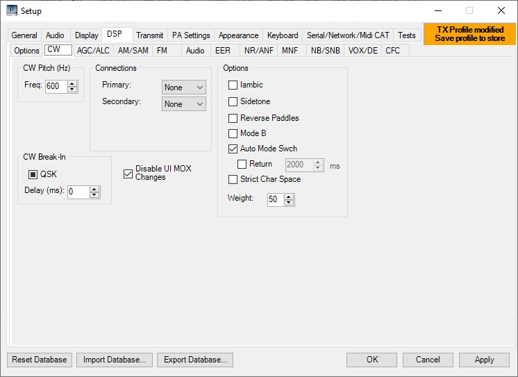

WinKeyer is plugged into KEY, in the front of the radio (just like my paddle was connected before, using the built-in iambic keyer).
Below, see the DSP/CW form as it stands now. Never messed with this form and I have operated on CW without any issues for a long time. Although, I had never used WinKeyer before but the built-in Iambic keyer in Thetis whereas WinKeyer is now used as an external keyer instead.

Actually, I tried that too. Took WinKeyer out of the circuit and plugged my paddle straight into the front of the radio (enabled iambic keyer inside
Thetis) and the radio went into TX mode immediately........That anomaly hadn't taken place ever before.
WinKeyer is talking to the PC via COM5, but I would think that I don't have to mess with the "Secondary" connection and just stick with the "Primary" connection being set to radio.
