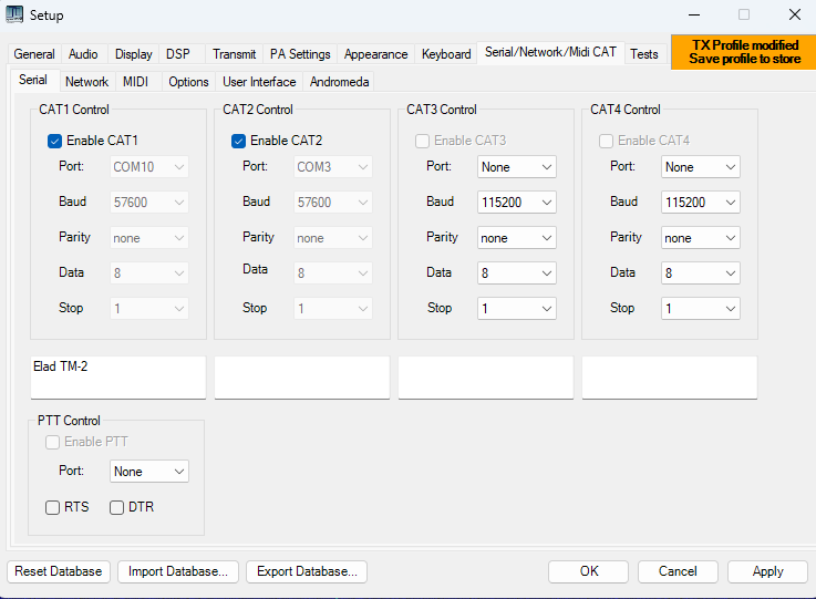

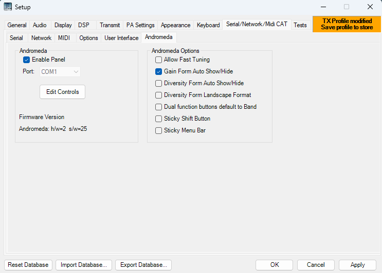

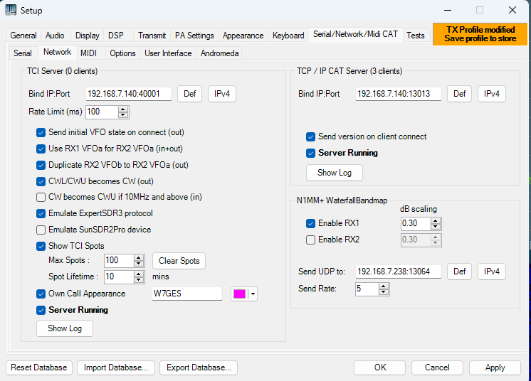

Here are the settings windows from Thetis. As you can see I chose COM1 for the Andromeda tab and did not enable it on the CAT tab.
I haven't tested every panel button but AF volume / Drive / Tuning / MOX / 2 Tone / VFO work FB.
I will need to play around to see how to get the encoder push PS on off to work when I have a little time.
George / W7GES

by W7GES
K5WC wrote:Thanks again George for the information. I set mine as yours is but still no joy. I’ve now connected straight to the PC LAN with no difference.
73 Jon
Make sure the BIND IP port in the network set up tab is set to either local host or the IP address of the computer running Thetis, not the IP of the G2.

Thanks again George, I’ve tried it with both options in the IPV4 127 localhost and the 192 oh course that one will change if I’m plugged straight from the PC to the G2 but neither work. I am assuming that while it keeps (0 clients ) and there is no activity in the show log it’s not establishing proper connections. Disabling firewall didn’t make any differences. Unfortunately I’m beyond my scope of expertise. Thanks 73 John

Finally had a bit of time today, did a git pull and make. Started the P2APP -p and the TCP/IP CAT shows (1 client) and the buttons and knobs are live now. No clue what or why they didn’t work previously. Thanks for the screen shots and help George.

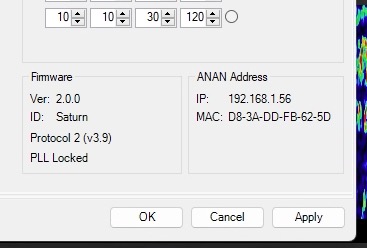

This may be a daft question, I just got a G2 last week. How do I see the current firmware version I am running?
Is this the correct place? If so mine shows 2.0.0 which seems very different to version 17 mentioned here?

g6phf wrote:Hi,
Hi Mike,
just start the p2app and you will see all the information on screen.

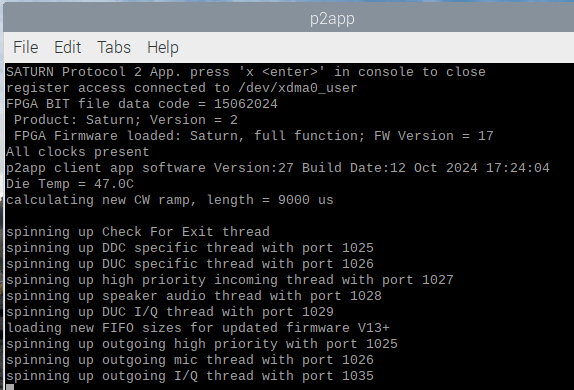

by PH7R
DL8LAQ wrote:
g6phf wrote:Hi,
Hi Mike,
[img]vncviewer_2024-10-31_10-28-46.png[/img]

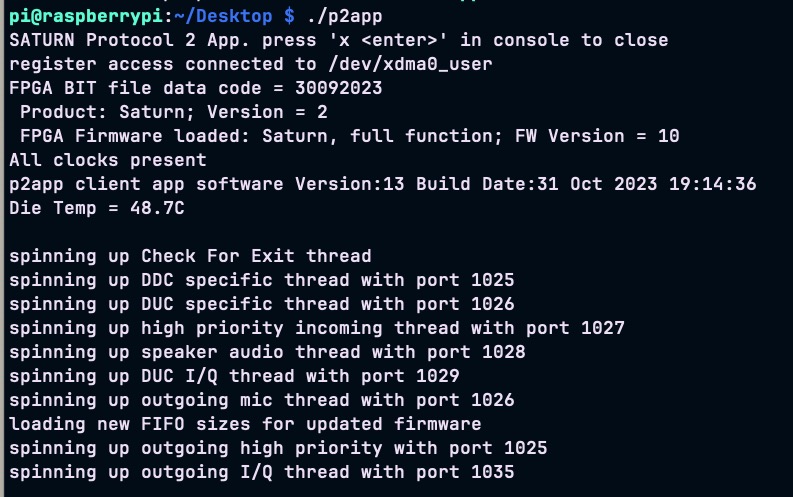

Received my Anan G2 yesterday with the following:
Raspi OS Buster 10 is installed (Raspi model 4). FPGA bit file 30092023. Saturn product version 2. FPGA FW 10.
So this means I need to upgrade to FW 17. Task for the weekend to read the manual and how to upgrade to FW 17.
Can I find somewhere difference between 10 and 17?

Thanks, so it looks like I have FW version 10?
Seems odd to be shipped from factory with an old version? Or am I missing something?

Yes, I received my Anan G2 Wednesday with the same FW 10. I would also have expected to have the latest FW installed or at least the previous one. But it is what it is and not difficult.
