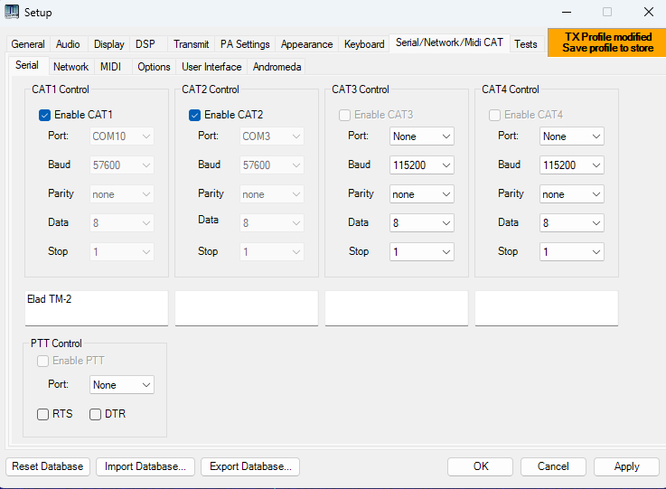

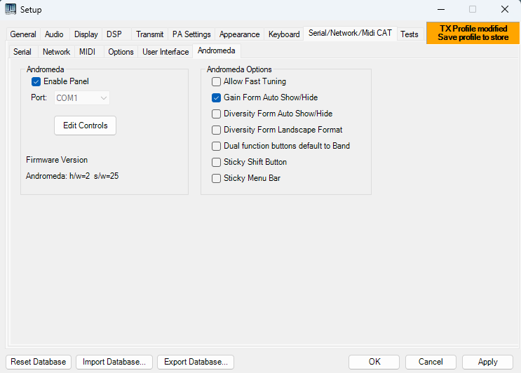

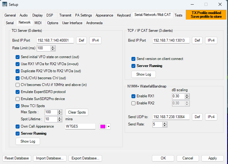

Here are the settings windows from Thetis. As you can see I chose COM1 for the Andromeda tab and did not enable it on the CAT tab.
I haven't tested every panel button but AF volume / Drive / Tuning / MOX / 2 Tone / VFO work FB.

Make sure the BIND IP port in the network set up tab is set to either local host or the IP address of the computer running Thetis, not the IP of the G2.K5WC wrote:Thanks again George for the information. I set mine as yours is but still no joy. I’ve now connected straight to the PC LAN with no difference.

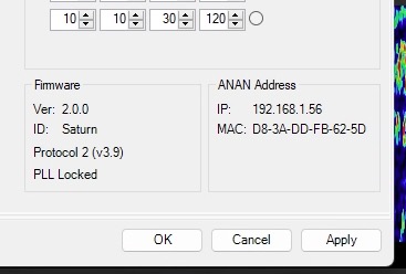

This may be a daft question, I just got a G2 last week. How do I see the current firmware version I am running?
Is this the correct place? If so mine shows 2.0.0 which seems very different to version 17 mentioned here?

Hi Mike,g6phf wrote:Hi,
just start the p2app and you will see all the information on screen.

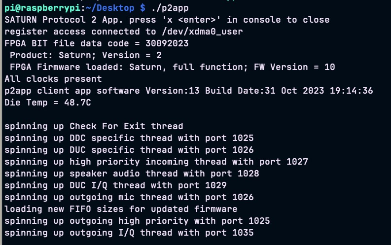

Received my Anan G2 yesterday with the following:DL8LAQ wrote:Hi Mike,g6phf wrote:Hi,
[img]vncviewer_2024-10-31_10-28-46.png[/img]
Raspi OS Buster 10 is installed (Raspi model 4). FPGA bit file 30092023. Saturn product version 2. FPGA FW 10.
So this means I need to upgrade to FW 17. Task for the weekend to read the manual and how to upgrade to FW 17.
Can I find somewhere difference between 10 and 17?

You can use "git log" to see the version history.PH7R wrote:DL8LAQ wrote: Received my Anan G2 yesterday with the following:
