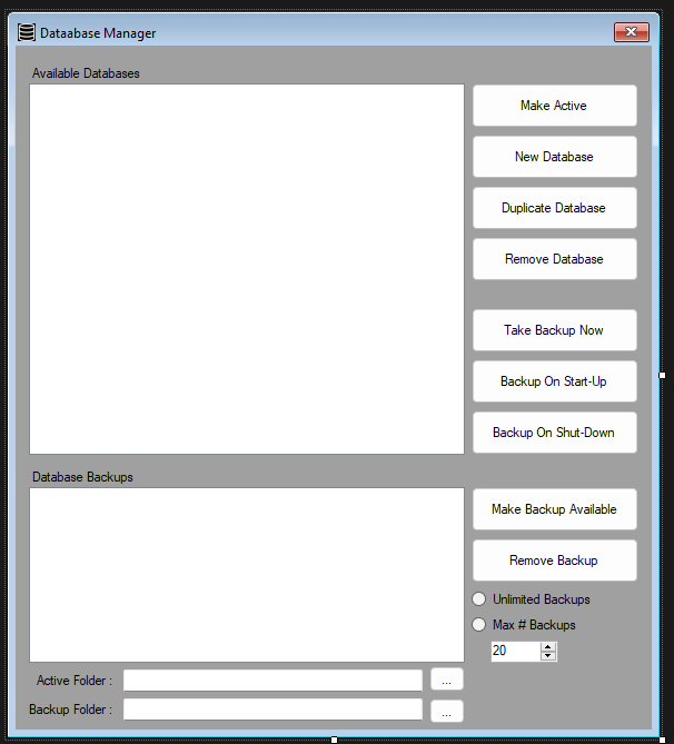

In other, somewhat related news, I am currently working on changing the database handling, and an initial prototype is provided below. I’ve grown tired of constantly replacing, importing, and dealing with database issues, and I need a better solution for my own sanity.
