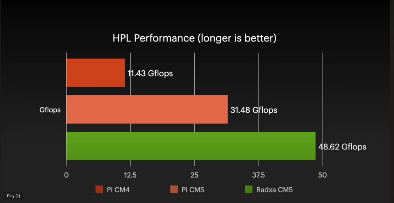

For those that like to experiment with embedded software and Compute Modules I'd like to report some recent results with an upgrade inside the G2.

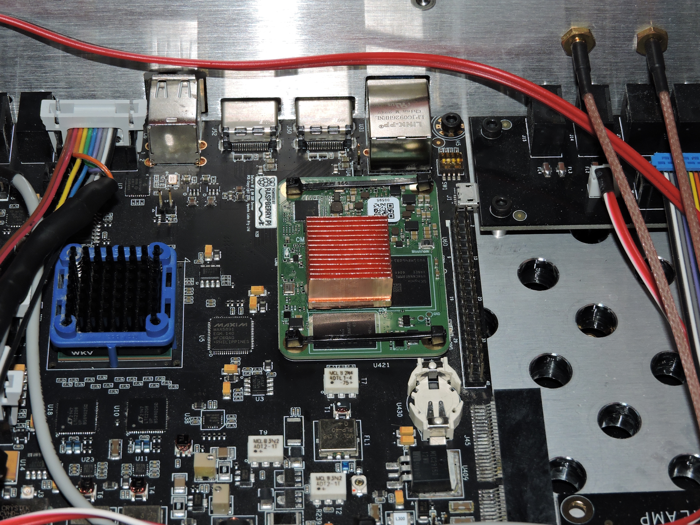

Replaced the Raspberry CM4 module by a Radxa CM5 in a G2 w.o. control front. The CM5 features a Rockchip rk3588s2 System-on-Chip in 8 nm technology. Details: https://radxa.com/products/cm/cm5

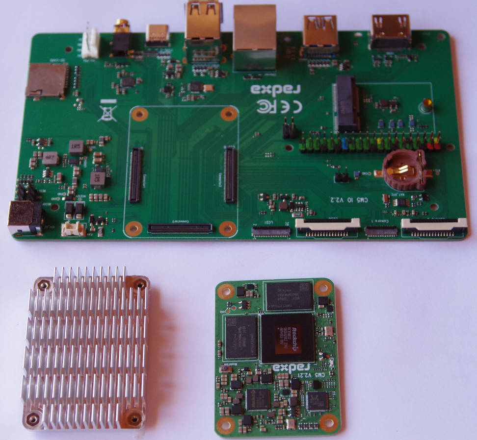

The CM5 that I bought has 8 GB RAM and 64 GB eMMC memory. Together with a development IO board for the CM5 and a heatsink the investment was about 120 €. (see photos). Reduced the heatsink size and glued it directly onto the SoC in view of the heatsink's four screw inserts not being compatible with the screws used in the G2.
The integrated eMMC storage makes the use of the SDcard obsolete. Mechanically the CM5 is compatible with the Raspberry CM4; it has three 100 pin connectors though; the third, along the short side, remains unused on the G2 Saturn board. A negative is that the CM5 does not provide WiFi; I don't use the G2's WiFi though and of course it can be added back via USB.
Time from power-on to internal Pihpsdr ready is now under 17 sec. Two receivers in parallel, each at 1.536 Msamples/s, load the 8 CPUs to about 20% of maximum.
To create the OS I have used the Armbian build system with a recent Linux 64 bit kernel 6.11.0-rc3. The xdma driver, needed on the Saturn board and not in standard Linux, is patched into the source before compilation. The optimum use of the Graphical Processing Unit inside the rk3588s2 'Mali G610' is still an area of experiment but these first results with the CM5 are encouraging. Further info on request.

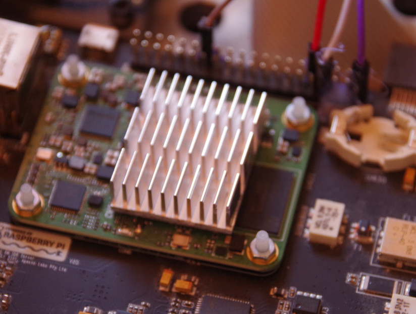

two reasons for cutting back and gluing the heat sink:
1. while the position of the heat sink screws is exactly right, the metric screw size is much smaller than that of the nylon screws that the Saturn board applies.
The tiny screws that come with the heat sink don't have the length to reach through the Saturn PCB. They allow fixing the heat sink against the CM5 but in that case nothing other than the two 100 pin miniature connectors keep the CM5 in place, a CM5 heavier than before due to its heat sink.
2. Radxa supplies the heat sink with a small rubbery heat conductive slab, to be put on the SoC, that will keep the heat sink 1-2 mm above the other components.
Prefer the heat resistance that a thin epoxy glue layer provides, plus not having to balance the 4 screws to not let the heat sink tilt, and to have the CM5 being secured in place and in the connectors by the nylon screws. Basically the way the original CM4 was mounted as well.
Indeed the CM5 has the HDMI-0 connected and HDMI-1 not. The rk3588s2 SoC has two digital video outputs and for each output it is either HDMI or DisplayPort.
On the CM5 output 0 connects for HDMI and output 1 for DP. CM5' DP connects to connector U443 on the Saturn board for connection to an internal screen. Have not yet verified the functionality of this DP since I don't have a separate screen with DP interface and my G2 has no screen, but is would appear to be standard functionality. DP is also on the Radxa IO development board.

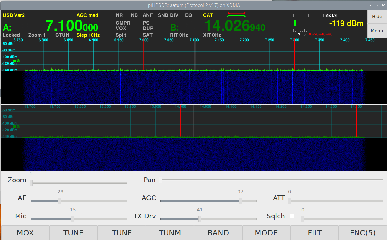

dual RX @768KHz screenshot attached.
Laurence Barker G8NJJ
Re: Experimental upgrade Raspberry CM4 to a Radxa CM5
Thanks Laurance for posting the photo. It looks like things are improving with PiHPSDR. What kind of difference it makes opening a second spectrum display? Do you have to decrease the bandwidth of the displays? Or can the CM4 handle the extra load without problems such as audio dropouts as mentioned in the manual? That would be a big improvement if it can sustain the data rate without problems.

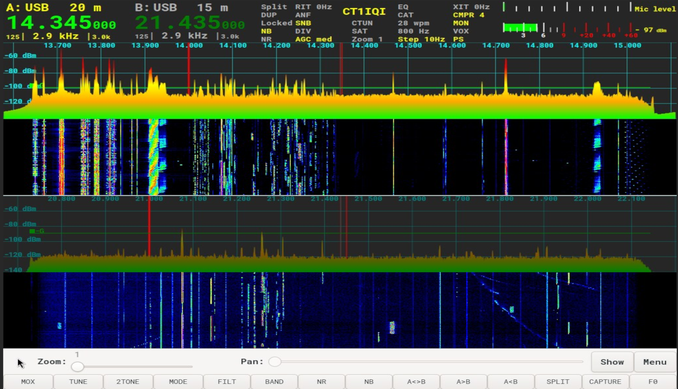

Screenshot via VNC of my G2 with Radxa CM5, running two receivers at 1.5 Msamples/s each, one tuned on 20 m. and the other on 15 m. band.
Total load average of all processes running, including the vnc server, is at around 2.5 out of 8 (source: 'htop'). I modified Pihpsdr to show a bit more info on the large external screen that is connected to the G2 via HDMI.

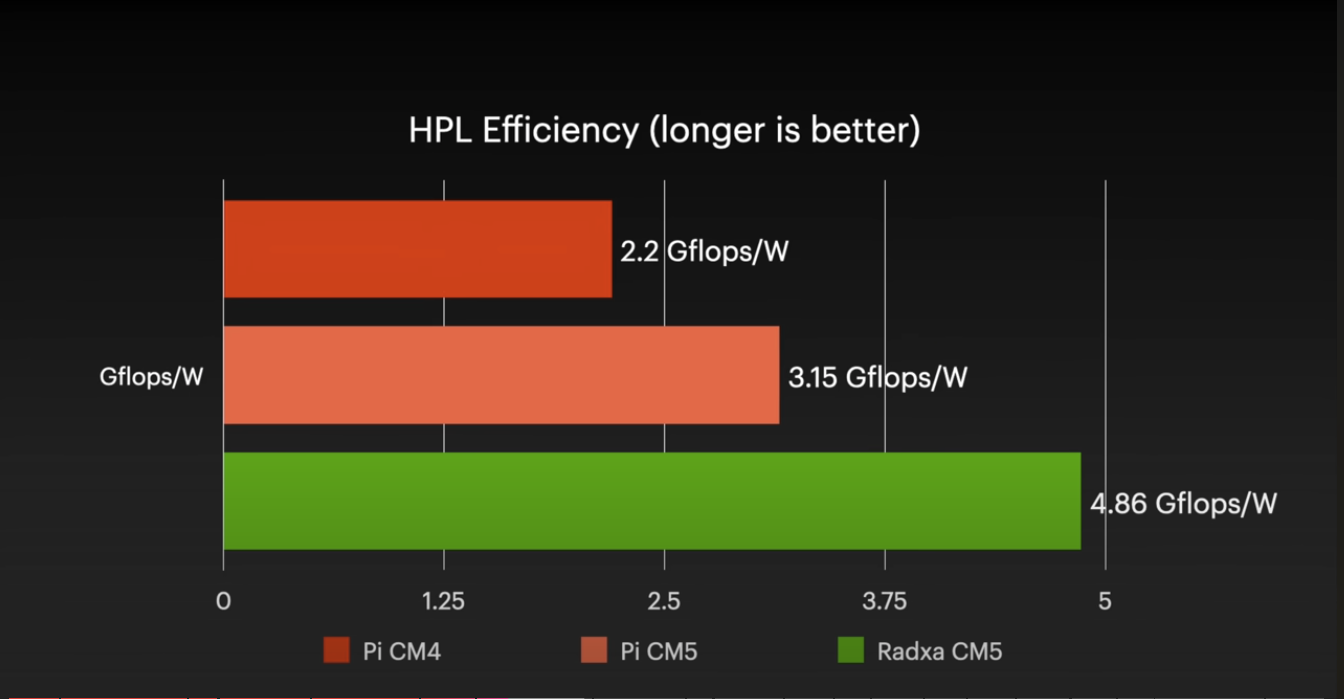

There's a nice overview of the rpiCM5 here: https://www.youtube.com/watch?v=X4blR5Ua3S0
Here's some highlights on performance and efficiency comparisons, note the Radxa kicking butt:
- cms_perf.png (89.55 KiB) Viewed 19907 times
- cms_eff.png (92.7 KiB) Viewed 19907 times

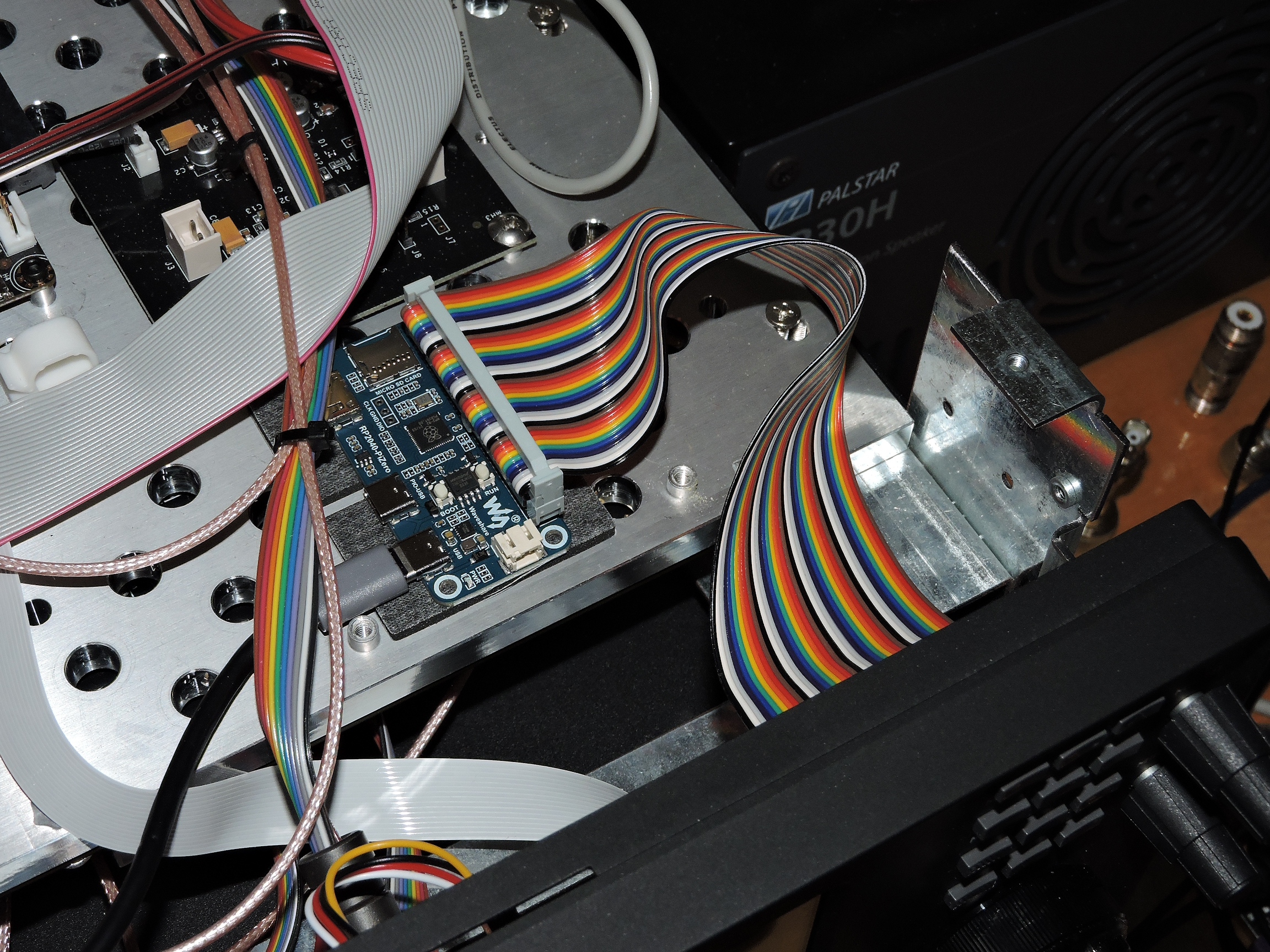

Installed the Radxa CM5 into my G2 with the original display, with lots of help from CT1IQI. Also, we received help from Laurence and possibly others. A little more involved with the original display, but it works, and the software just needs fine tuning. Martin (CT1IQI) supplied the image file for the CM5. I decompressed it to a MicroSD card, and inserted it into the Saturn board, only for the initial installation. After that, turned the G2 off, and then removed the card. The OS is then on the eMMC memory on the CM5.
Besides the Radxa CM5, one also needs a RP2040-PiZero board, to convert the GPIO data to USB. Of course the board also has to be programmed, which I am told Laurence did the work with that. The 40-pin GPIO cable is removed from the Saturn board, and plugged into the RP2040-PiZero board. I bought a much shorter cable (8 inch), because the original cable is much longer than it needs to be. 4 wires on the P5 10-pin ribbon cable have to be removed (close to the rear panel connector on the Saturn board) and wired into a USB-C Data Connector, which is then connected to one port of the RP2040-PiZero board. Another regular USB charging cable is used to help supply current to the RP2040-PiZero and front panel. I just soldered two wires with the proper female pins on the end, and connected them to pins 2 (+5V) and 6 (gnd) at the 40-pin GPIO connector on the Saturn board. The other end going to the Red and Black wires from the USB-C charger cable.
I used tie wraps to hole the CM5 down, only because the nylon 2mm bolts/washers/nuts I ordered were not right. The washers were too thick, and wouldn't let the CM5 seat properly, and I wanted to get the G2 (with Radxa going)!
Attached are some pictures. NOTE: The picture of the RP2040-PIZero board does not show the second USB-C cable, because I didn't have it installed yet.
John
N2KBE
John
N2KBE
- DSCN2692.jpg (3.44 MiB) Viewed 18289 times
- DSCN2691.jpg (3.36 MiB) Viewed 18289 times

The absolute newest p2app should also work with this, unless the USB serial device comes up at a different address from my radio (which is possible). Christoph is also supporting it in piHPSDR. We do need to do a little more work to finalise the naming of the USB serial devices.
With my RP2040-piZero I didn't get a high enough USB supply voltage for the VFO encoder (which is marginal on 5V). If it doesn't work, or becomes temperature dependent, it may need a 1 wire modification to feed switched +13.8V to the encoder.
Thank you for the heads up with the P2_app, it now works on my G2 with the Radxa CM5!
John
N2KBE
