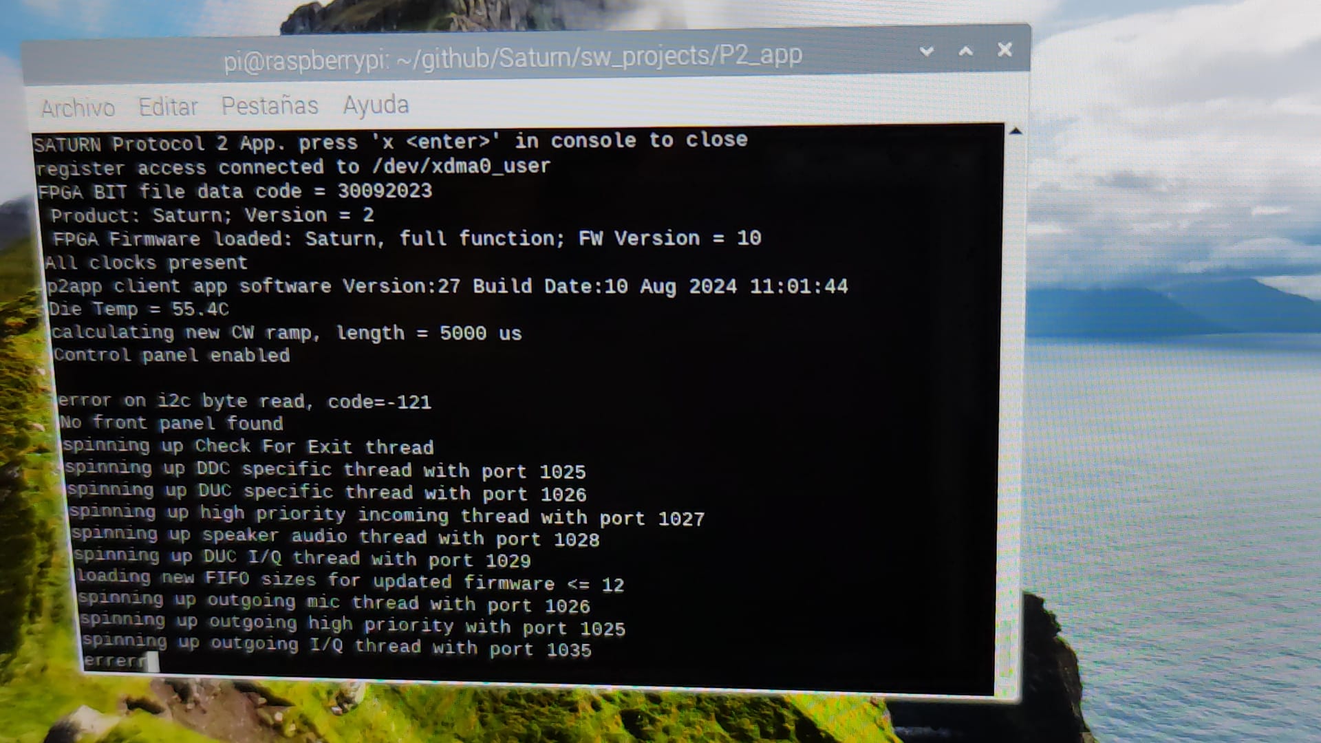

I received the G2 Ultra a few days ago. I'm trying running Thetis getting the panel front knobs control of the G2 but it doesn't work.
Acording the last manual I run "p2app -p" and in Thetis is set on the TCP/IP CAT computer IP, port 13013, and in Andromeda tab enables G2 Panel.
When I run "p2app -p" I see a error in I2C : error on i2c byte read, code=-121, no front panel found.
I checked the I2C interface, and it is enable on the system.
I think the issue is in p2app side, not in the Thetis, any suggestion about the cause of this error?
Attached is the screenshot starting "p2app -p"
Regards
Jose

The i2c error is normal, because it is also checking for a mk1 G2 front panel. It detects which panel it has by: 1. does it find a specific i2c device; and b. Does it find a serial device.
The key issue here is: it subsequently reports no panel found. So it can't be finding the serial device.
Have you loaded the latest p2app (see the manual for information about how to download it)?
Does the panel with piHPSDR?
The issue may be, did it find the right serial device. We are aware that some serial device names change depending on the version of the operating system. We might need to add an initialisation file so that parameters including the serial port name can be set by the factory. But that would need to wait until after I'm back from hoilday.

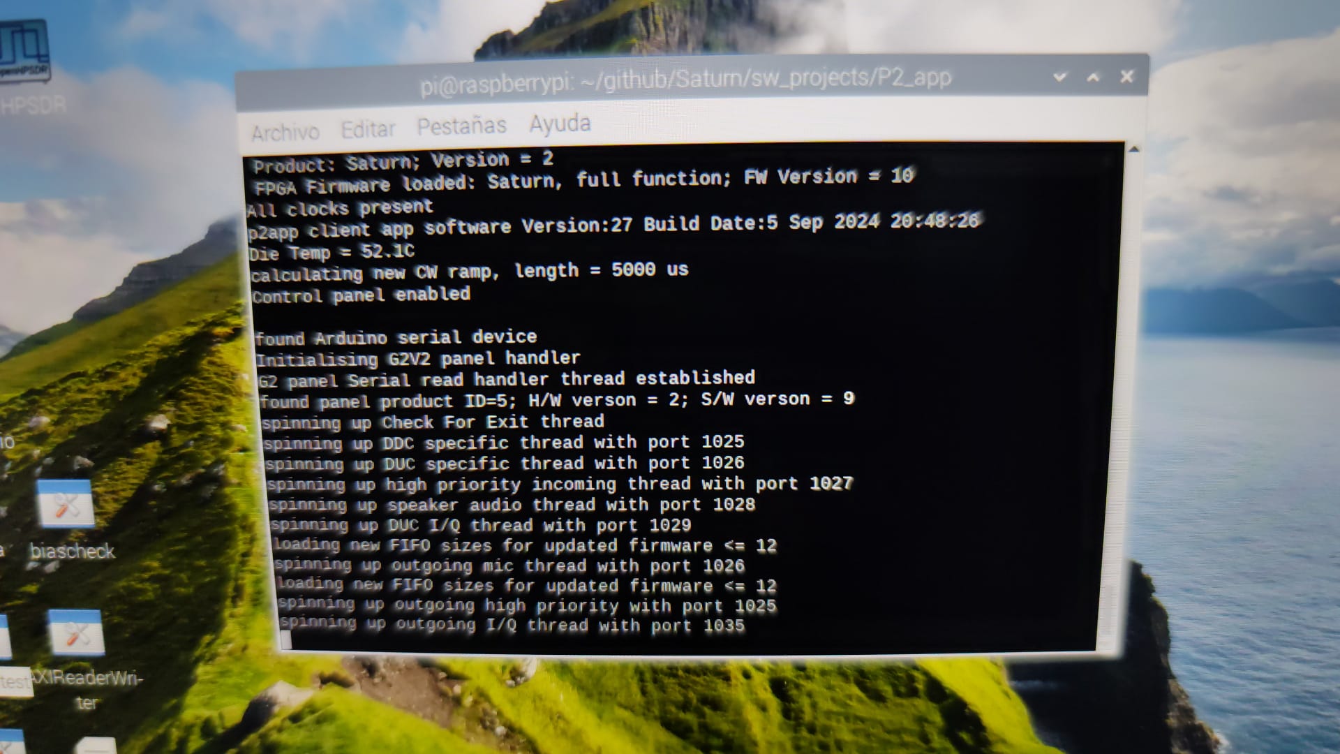

Thank you Laurence for the suggestions, I fixed the issue. I have the G2 Ultra only one week ago, and it cames with the last P2app version V27 which is the current last version.
I forced the upgrade and downloaded again the V27, now the front panel is detected and works fine with Thetis.
If someone who has recently received the G2 Ultra has the same problem I suggest updating P2app even if it is the same version V27.

In the attached image the I2C error is no longer displayed, and the Arduino + G2V2 front panel are detected.
And my next step is upgrade the FPGA firmware, my G2 Ultra came with the V10 and currently is the V17.
73 Jose
