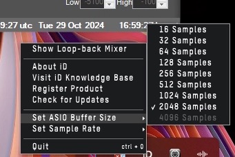

I have options in the ID4 driver for sample rate and buffer size. Should i be looking to align these whith some of the settings in Thetis? See attached.
Screenshot 2024-10-29 at 16.59.25.jpg (26.69 KiB) Viewed 3146 times

First thing is ASIO is what you want to use, not MME.
Second, are you using VAC or cmASIO in Thetis? If you are using VAC, then match your VAC main buffer size to your ID4 buffer size. If you are using cmASIO you have to use buffer size 64. If things won't run well at 64 then you can't use cmASIO because it is fixed at that buffer size.
