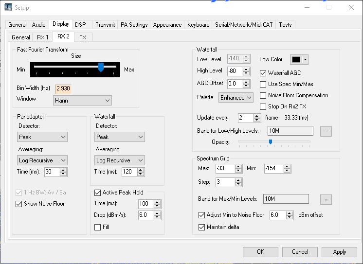

RX2 receive level is different from RX1
Rx2 is attenuated despite being setup the same as Rx1. Both Rx's are on same freq. Ant is Ant1.
What am I missing?

RX2 is running on the RX antenna - which probably has no connection.
RX1 = ADCO = ANt 1
RX2 =ADC1 =RXant
If you want to run Both RXs on the same ANT1 then change ADC selection so RX2 = ADC0 too

Thanks Nigel! That change brought Rx2 to life.
