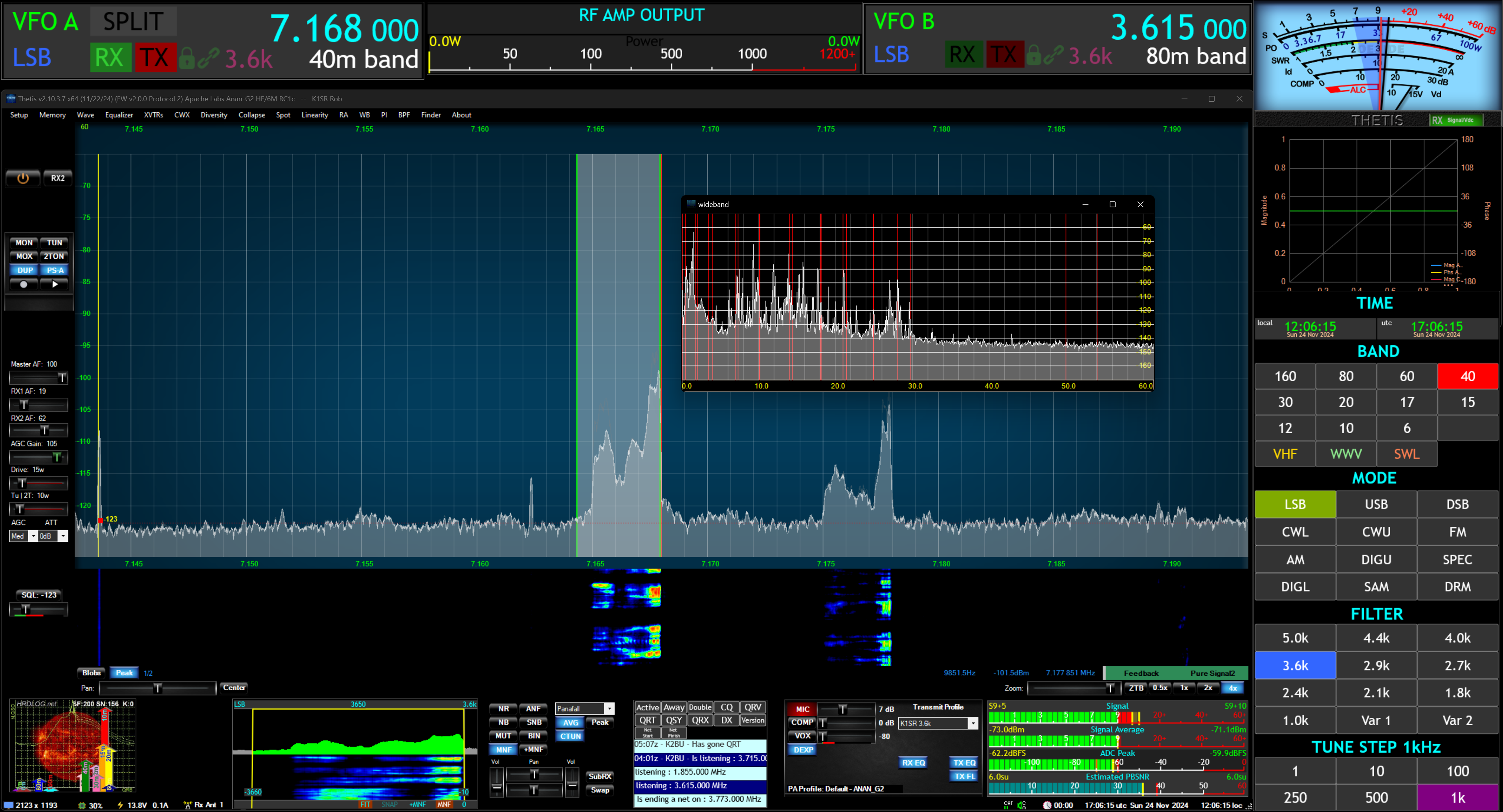

We have added wideband data capture into Saturn. The new V18 FPGA code is posted in github and as normal the p2app will need to be recompiled. The procedures are the same as normal.
To use it, simply open the wideband window in Thetis and you will see spectrum activity covering DC-61MHz.
Please regard this is a beta release at present. We think it has the same behaviour as other HPSDR radios, and it has been tested, but this is a function I've never been able to see work before!
Laurence Barker G8NJJ

Re: G2 Wideband signal capture
Laurence,
Thank you so much. I updated the firmware and P2app and the wide band display is working great. Thanks again for taking the time to add this feature to ]he G2.

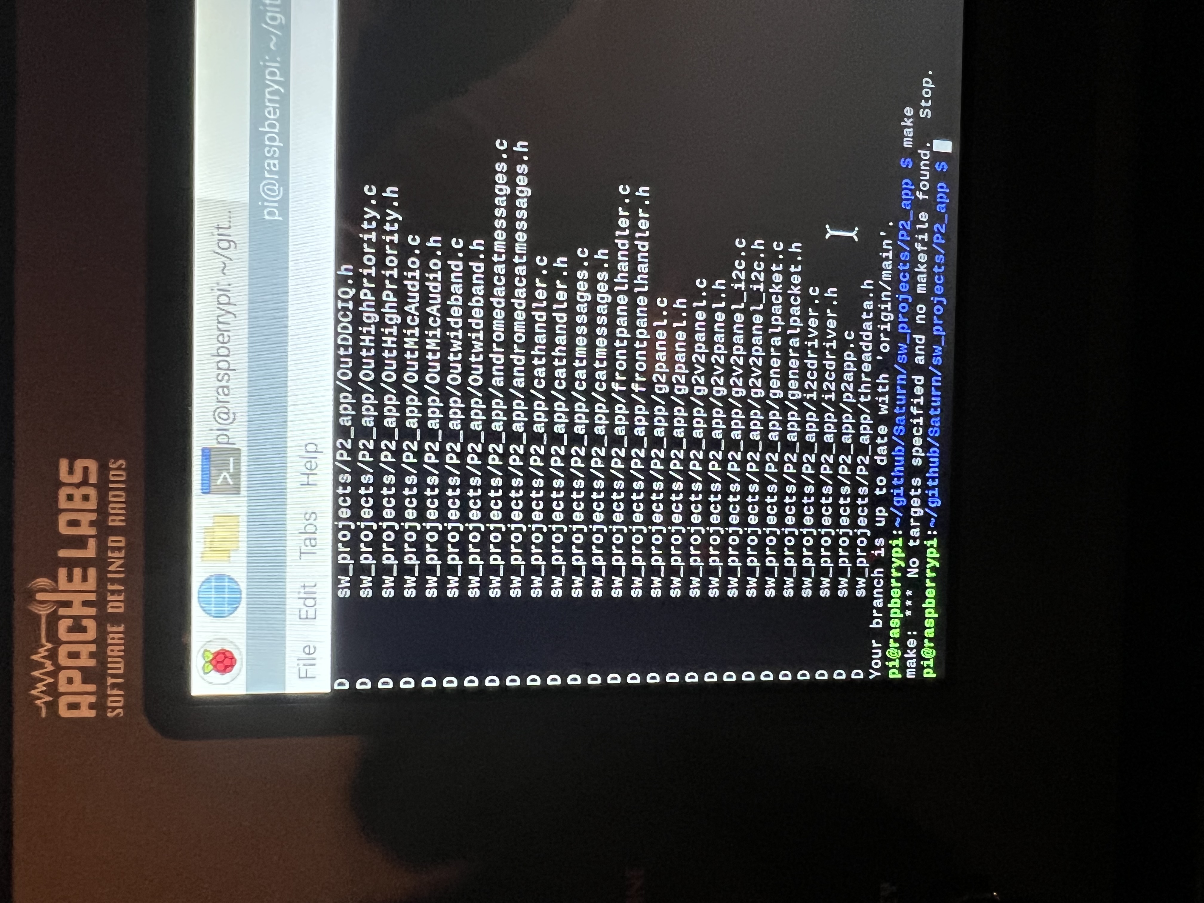

laurencebarker
- Posts: 335
That is telling you that just about all of the source files in p2app have been changed from the version that is the most recent. I have no idea why.
My only idea of a way forward is:
1. make a copy of all of the files in github/Saturn onto a memory stick, so you can go back. Use the file browser to do that.
2. remove all the files from the P2app folder
cd github/Saturn/sw_projects/P2_app
rm *
3. do another git pull to get the correct files back.
cd ~/github/Saturn
git pull
There may be much better ways to do this with git reset, but I don't know what they are.
laurencebarker wrote:That is telling you that just about all of the source files in p2app have been changed from the version that is the most recent. I have no idea why.
rm *
cd ~/github/Saturn
git pull
Ok I’ve moved everything to a memory stick, removed everything from the P2-app, did the git pull. The p2_app is still empty, did I miss a step to repopulate?

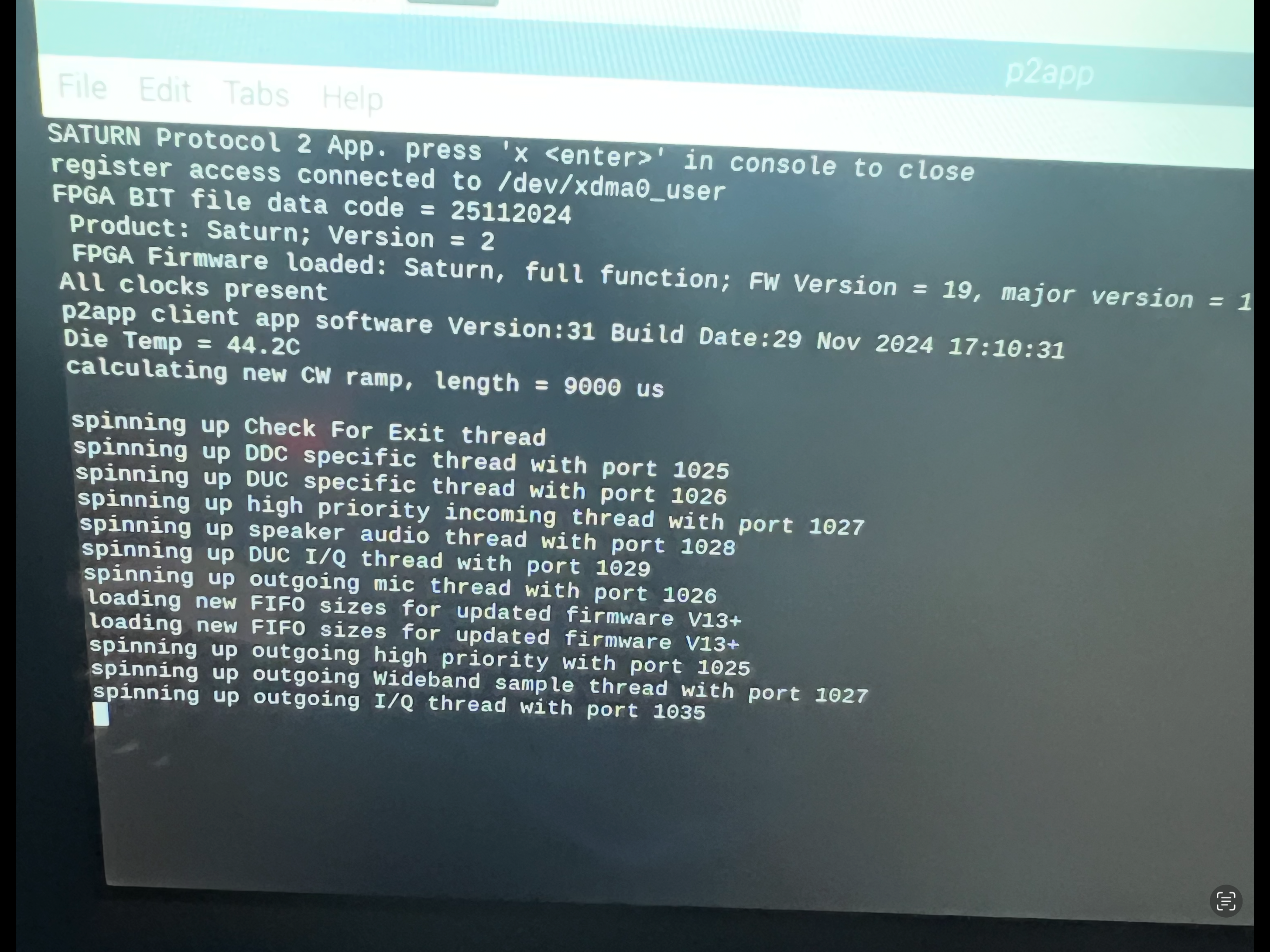

I can confirm that pihpsdr and Thetis now works with the V18 firmware, Christoph corrected the issue with pihpsdr. Wide Band is only available on Thetis so far, but at least one can run either pihpsdr or Thetis on the V18 firmware.

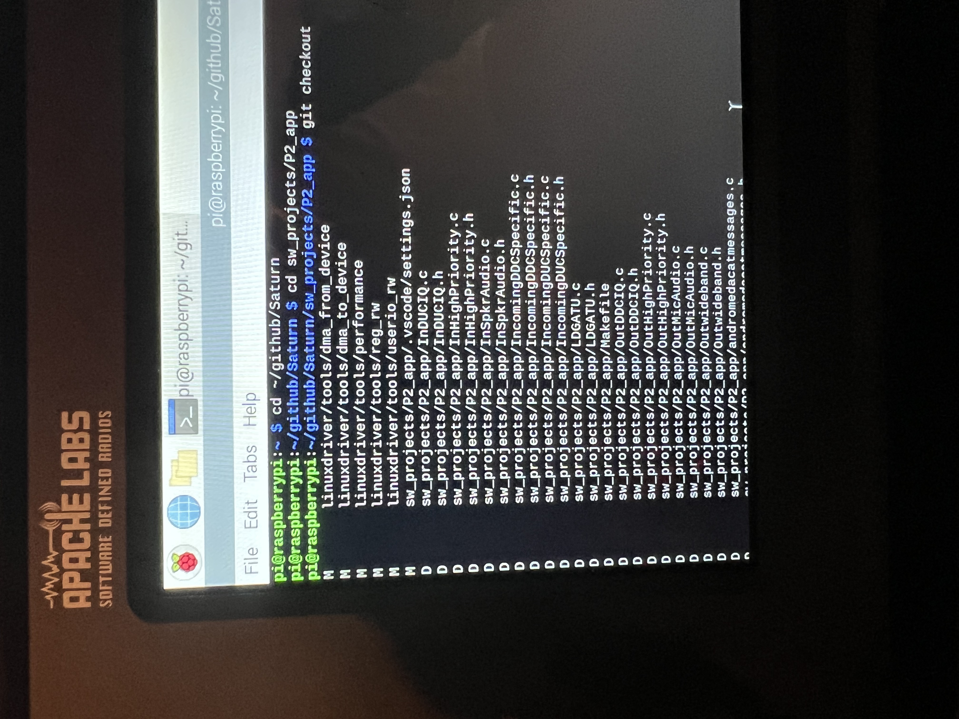

rm *
cd ~/github/Saturn
git pull
pi@raspberrypi:~/github/Saturn
$ cd ~/github/Saturn
pi@raspberrypi:»/github/Saturn $
git pull
Already up to date. pi@raspberrypi:~/github/Saturn $ cd sw_projects/P2_app pi@raspberrypi:~/github/Saturn/sw_projects/P2_app S
make
make: *** No targets specified and no makefile found.
Stop.
This is what I am getting when I try.
Thanks John

Thanks Rick
Here is what I see and get:
pi@raspberrypi:~cd ~/github/Saturn
pi@raspberrypi:~/github/Saturn/sw_projects/P2_app $ git checkout
M
linuxdriver/tools/dma_from_device
Linuxdriver/tools/dma_to_device
linuxdriver/tools/performance
linuxdriver/tools/reg_rw
linuxdriver/tools/userio_rw
sw_projects/P2_app/•vscode/settings.json
D
sw_projects/P2_app/InDUC1Q.C
sw_projects/P2_app/InDUCIQ.h
sw_projects/P2_app/InHighPriority.c
sw_projects/P2_app/InHighPriority.h
sw_projects/P2_app/InSpkrAudio. c
sw_projects/P2_app/InSpkrAudio.h
sw_projects/P2_app/IncomingDDCSpecific.c
sw_projects/P2_app/IncomingDDCSpecific.h
sw_projects/P2_app/IncomingDUCSpecific.c
sw_projects/P2_app/IncomingDUCSpecific.h
sw_projects/P2_app/LDGATU.C
sw_projects/P2_app/LDGATU.h
sw_projects/P2_app/Makefile
sw_projects/P2_app/OutDDC1Q. C
sw_projects/P2_app/OutDDCIQ.h
sw_projects/P2_app/OutHighPriority. c
sw_projects/P2_app/OutHighPriority.h
sw_projects/P2_app/OutMicAudio.c
sw_projects/P2_app/OutMicAudio.h
sw_projects/P2_app/Outwideband. c
sw_projects/P2_app/Outwideband.h
sw_projects/P2_app/andromedacatmessages. c
sw_projects/P2_app/cathandler.c
sw_projects/P2_app/cathandler.h
sw_projects/P2_app/catmessages.c
sw_projects/P2_app/catmessages.h
sw_projects/P2_app/frontpanelhandler.c
sw_projects/P2_app/frontpanelhandler.h
sw_projects/P2_app/g2panel.c
sw_projects/P2_app/g2panel.h
sw_projects/P2_app/g2v2panel.c
sw_projects/P2_app/g2v2panel.h
sw_projects/P2_app/g2v2panel_i2c. c
sw_projects/P2_app/g2v2panel_i2c.h
sw_projects/P2_app/generalpacket.c
sw_projects/P2_app/generalpacket.h
sw_projects/P2_app/i2cdriver.c
sw_ projects/P2_app/12cdriver.h
sw_projects/P2_app/p2app.c
sw_projects/P2_app/threaddata.h
Your branch is up to date with 'origin/main'.
pi@raspberrypi:~/github/Saturn/sw_projects/P2_app S make
stop.
Thanks again Rick and Laurence for all y’all’s patience and continued help.
73 John
John,
There are some strange and unexpected characters in your logs that
you paste. Maybe it's just errors in the copy and paste.
Like where is the M and the D coming from
M
D
Also the 1 in 12cdriver.h should be an i
That may be a sign of a bad SDCard or image on SDCard. If you have
another SDCard > 16GB try burning the factory image on that and
using it. If not maybe try to copy the factory image on to what you have.
Actually before you do that, I'd like to see what an 'ls -l' output looks like
from pi@raspberrypi:~/github/Saturn/sw_projects/P2_app
Are there files in there and more specifically is there a Makefile file in there?
-Rick / N1GP
When you: cd sw_projects/P2_app
Instead of typing: git checkout
type: git checkout .
There is a space and a period after the word checkout
That was it!n1gp wrote:When you: cd sw_projects/P2_app
Thank you Rick!
