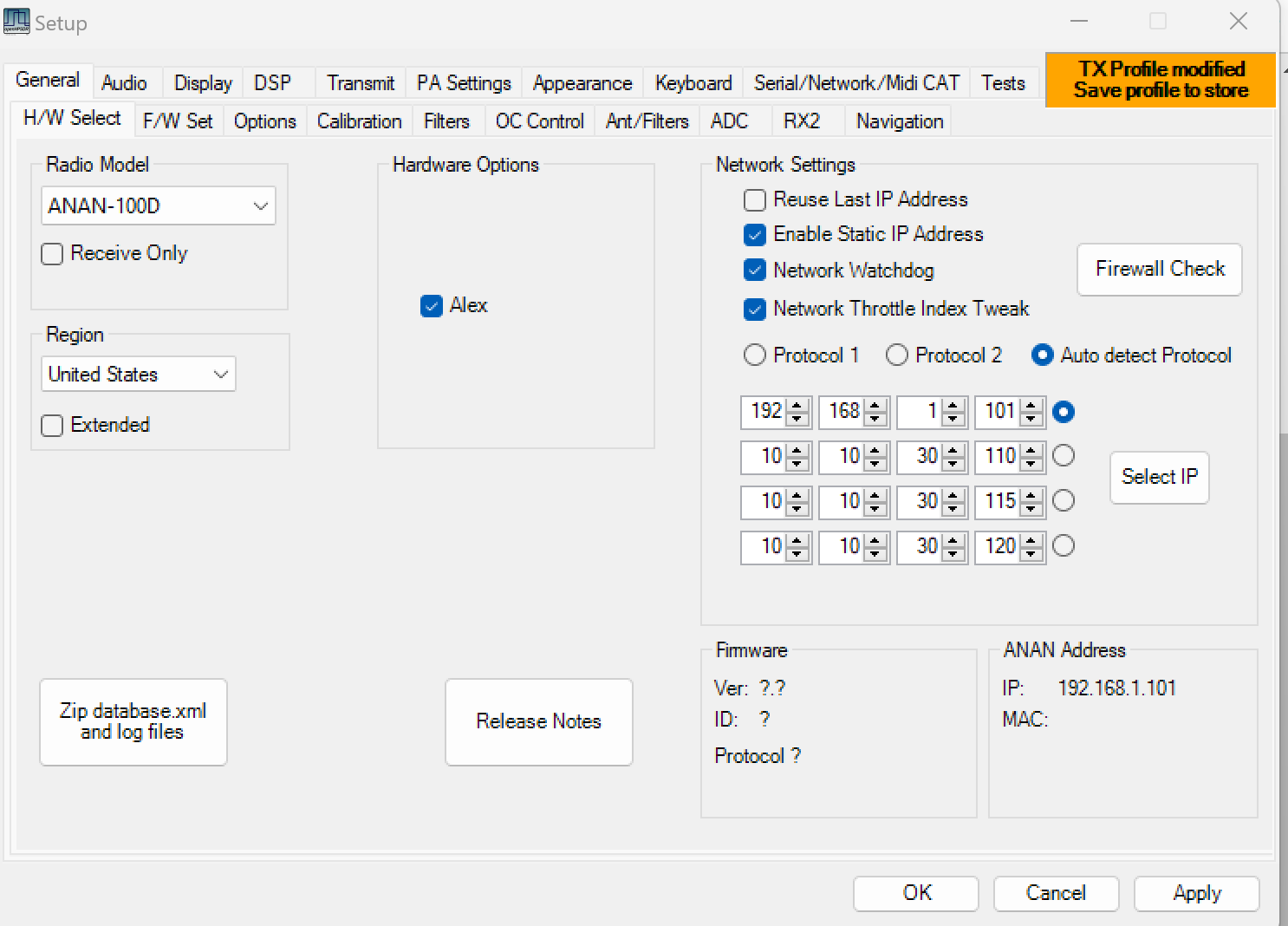

Hello
Just curious in Thetis setup (General> HW Setup why the Hardware options area remains Blank where in 200D and later it's available and you
can choose MIC Bias and PTT.
Please suggest
Thank you
ANAN 100d mic options.png (61.15 KiB) Viewed 3625 times
ANAN 200d mic options.png (80.78 KiB) Viewed 3625 times

that looks weird! Did you try to reset your database or even reinstall Thetis? I can't imagine this is a normal behavior.
You might save a backup of your database first before resetting in case the program itself is the problem and not the database!
Bernhard , DL1OF

Thanks for your reply. Now I realise that 100d and other models like 100 and 10 may require manual jumper settings on the radio card. That's why its not here because it is not software selectable.
Bhanu

Oh yeah! You are right!
The 100D has the Angelia board and requires manual jumper setting of the mic input.
With all the new developments, I barely can follow and die introduction of the Angelia board is way back.
Sorry for the wrong advice!
