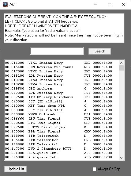

There does not appear any info, that I can find, to explain how to get SWL spotter to work within the DX/SWL Spotter window.
Here is what I've done to get it to work:
- Download CSV database from http://eibispace.de/
- Move it to /users/.../AppData/Roaming/OpenHPSDR/Thetis-x64/
- Rename xxx.csv to SWL.csv
- From the DX/SWL Spotter window click the Spot SWL button and then the SWL List button.
- From the SWL window click the Update List button.
73s....Rik
