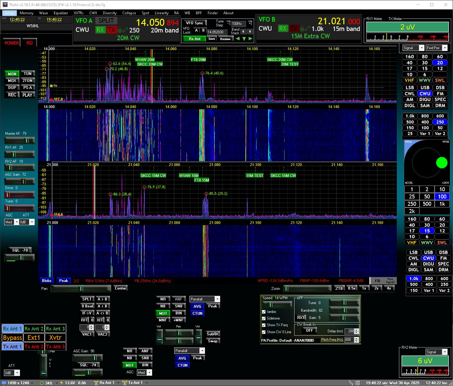

Here's an app to send entries from the Thetis Memory Interface to the panadapter via TCI.

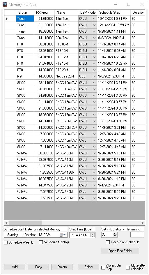

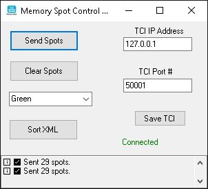

Turn on TCI in Thetis, add some frequencies with names via the Memory Interface, in the app set the TCI address & binding if different from the app default and click Send Spots.
I enjoyed this capability in Flex's old PowerSDR on my 5000a and wanted to recreate it for Thetis since the current builtin function is broken and seems to have no future.

New release to:
Clear all spots is more efficient.
Main window remembers last position.
Spot mode tracking is not fixed with this release but will be with next release of Thetis.
Download at: https://github.com/W5IHL/MemorySpotControlVB ... tag/v1.4.0
