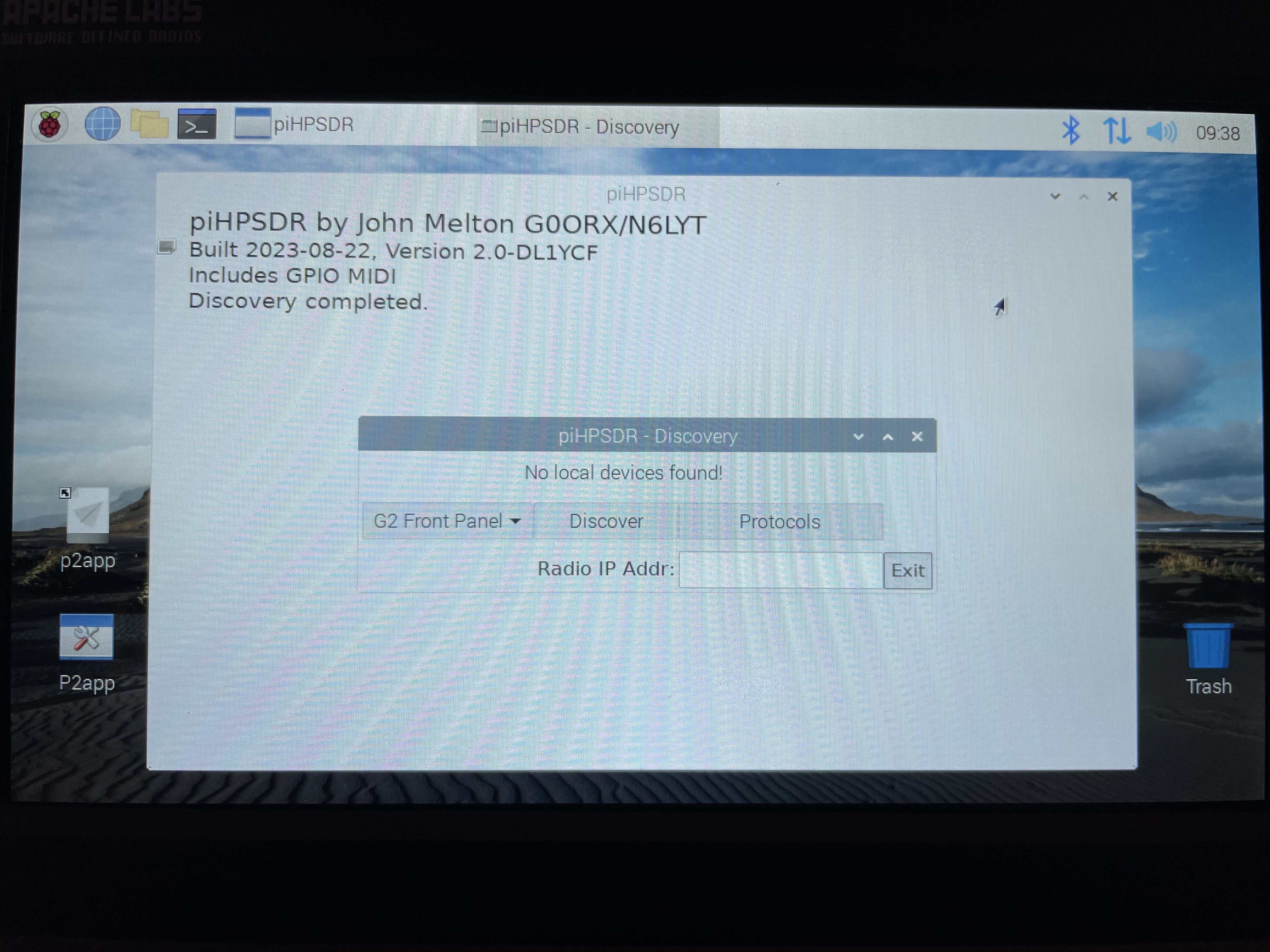

I attempted to update the G2, and upon booting a piHPSDR- Discovery message indicates that no local devices are found.
This appears to be a software or a hardware issue with the PCI Express interface, the FPGA, or even the R-Pi itself.
Any ideas how to remedy this?

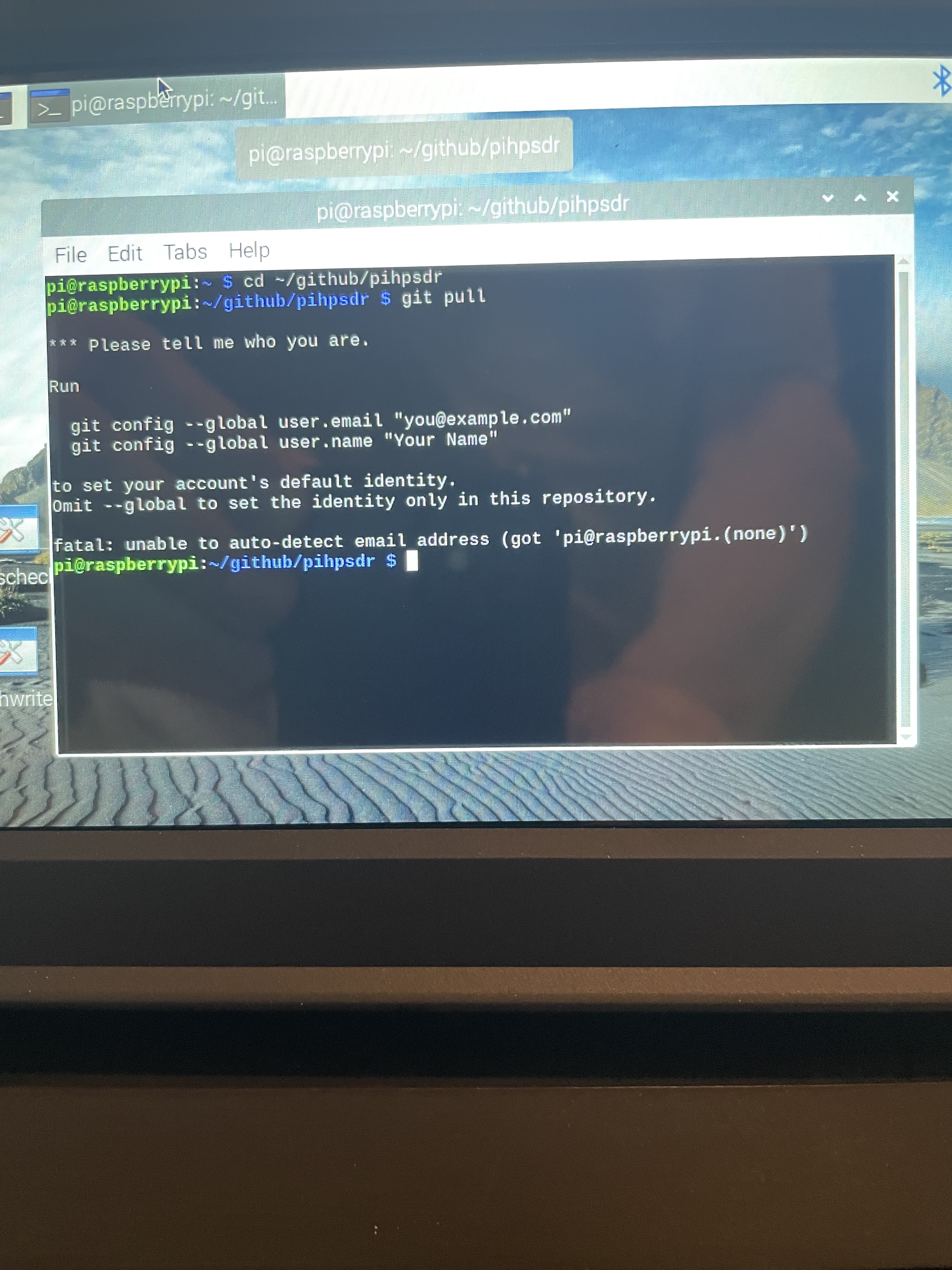

Also, when I execute git pull this is the result.

Do you have a Github account set up? That might be part of your problem.

Ok, from looking at the display in your post it appeared that Github didn't find your email address that is registered with your account.
Maybe, it is how you typed in the command for Git pull. I have had a similar problem in the past trying to update PiHPSDR in my V1 controller. The Linux Command line isn't very forgiving!
Have you updated your G2 before?

WT4DX wrote:Also, when I execute git pull this is the result.
check out this for setting your email info
viewtopic.php?f=48&t=4772#p26152

Apache Labs emailed me the G2 Display image, all is well, and the software is updated.
