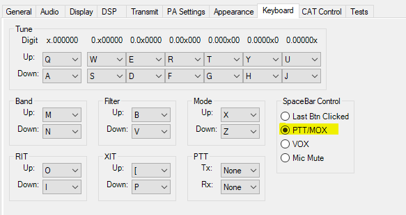

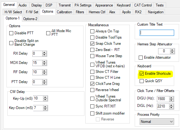

I think it's ok now with f/w Orion_MkII_NP_v2.0b! Now I can use the self-compiled 2.7.0. The footswitch is working in CW and the PTT out is active, that means the PA PTT or the XVTR is controlled by footswitch! That is what I missed for long time!!!!
By the way, the PTT by space bar seems to not work now - yes, I enabled MOX by space bar - but that is no problem since the footswitch is available in any mode.

Post by DH1KLM »
Hello Norbert,
good to hear it is working now.
For spacebar PTT have a look at the pic.
DL8LAQ
Posts: 233
Location: JO43XU
Re: Thetis 2.7.0
Post by DL8LAQ »
DH1KLM wrote:Hello Norbert,
Hi Sigi,
that is the solution. Thank you! :-) Enable shortcuts was not ticked.
GW0DQW
Posts: 37
Joined: Sun Apr 09, 2017 4:21 pm
Location: Nr Cardiff
Re: Thetis 2.7.0
Post by GW0DQW »
Space bar working Norbert , thank you very much .
