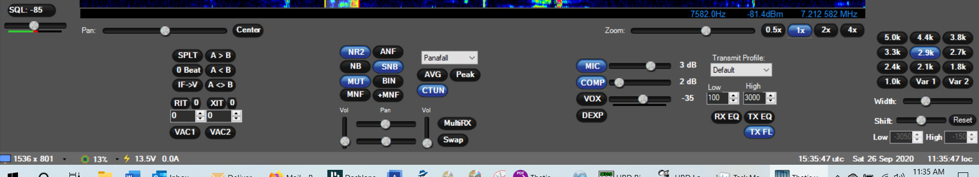

I have a 7000dle Mkii running Thetis 2.6.9. The Thetis manual states that you can switch TX/RX antennas on the fly, from the status bar. The example in the Thetis manual shows TX/RX icons in the status bar. However, there are no TX/RX icons in Thetis status bar in my installation. The only way that I have found to switch antennas is to go to the ANT/FILTERS menu.
Is there a configuration menu for the information/controls that are displayed in the status bar menu? Or were the RX/TX icons/controls moved somewhere else, or does it have to be configured elsewhere?

I think I added those in 2.7. They are a recent addition!

And Richie drew the icons - mine were a bit inadequate... never could draw

Has Thetis 2.7 been released? When I installed Thetis about three weeks ago, the highest version that I found was 2.6.9. For my radio/antenna/amp setup, being able to switch antennas on the fly from the status bar would be one of my favorite features.
