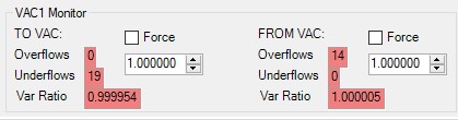

When I ordered my 7000 MkII I didn't realize how quickly matters would be over my head! I laugh...its really okay.
I've made the ffffffff registry change but am still getting over / underflows at varying degees of occurance. I've even had a complete shutoff of Thetis on an occasion or two. I use VAC1 for receive. I do that in order to utilize my computer and external amplifier sound system.
VAC1 Monitor.jpg (15.14 KiB) Viewed 21809 times
Can someone offer a few sentence explanation of the above and the significnace in Thetis operation? Hopefully it can be explained in a not too technical manner. :)
Posts: 6110
Re: How to solve latency problems and VAC under/overflows in Windows 10
A slow, occasional accumulation of under and overflows is not unusual. As long as they are not associated with audible artifacts (pops, clicks, etc.), it is nothing to worry about. If they are rapidly accumulating and you hear glitches then you need to start adjusting your settings, typically buffer size and buffer latency, to eliminate the problems. Usually this involves increasing the settings. You will have to experiment.
Also, make sure your entire setup is "48KHz clean". Go into any control panel involved with your sound devices, including and especially the Windows Sound control panel, and make certain all the devices you are using with Thetis are running at 48KHz, not that nasty 44.1KHz Windows default.

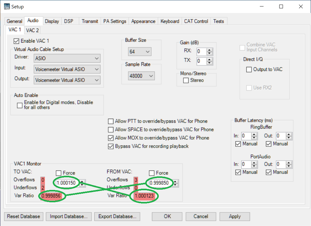

I want to share an idea I'm investigating. It has to do with tweaking the values in the boxes underneath the "Force" options in the VAC window.
While playing with buffer sizes and pushing the envelope for minimum latencies, I was curious whether setting an optimal value in the boxes under "Force" (whatever that optimal value may be) might reduce the rate of underflows/overflows.
So just using trial and error, I think maybe I'm observing that adjusting the noted values to be roughly equal to the displayed values shown at the bottom of the opposite column (see pic) seems to significantly reduce the rate of underflows/overflows.
Again, I'm really pushing the extents of what I can do, look at my buffer settings (and that's on a relatively ancient 6700K).
Just wanted to put that bug in your ear.

My understanding is that those adjustments only work when Force is turned on. They are basically a manual method of making the adjustment and were used for testing. They should probably be removed from the UI, and I would expect no effect when allowing the resampler to run normally. You can prove this by setting them to some crazy value like 2.0 or 3.0.

Seems can't make the Force number > 1.02 or < 0.98.
And I'm not seeing any effect on using FT8 -- used to be those boxes would cause drifting.
So seems Scott is right that they aren't used anymore.

They can be used, and their use has not changed at any time during the development of the resampler. They are to manually adjust the resampling rate when the Force box is checked.
