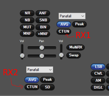

But I really want to have a full-fledged RX2. Is it possible to make memory of ranges and settings for RX2.
I apologize, maybe my question is off topic.

While RX2 is enabled, Click CTUN enables CTUN on both RX, Fine. Click CTUN to Disable, it only disables CTUN on the selected RX.
Perhaps Clicking CTUN should only Enable CTUN on the desired RX, instead of both RX?

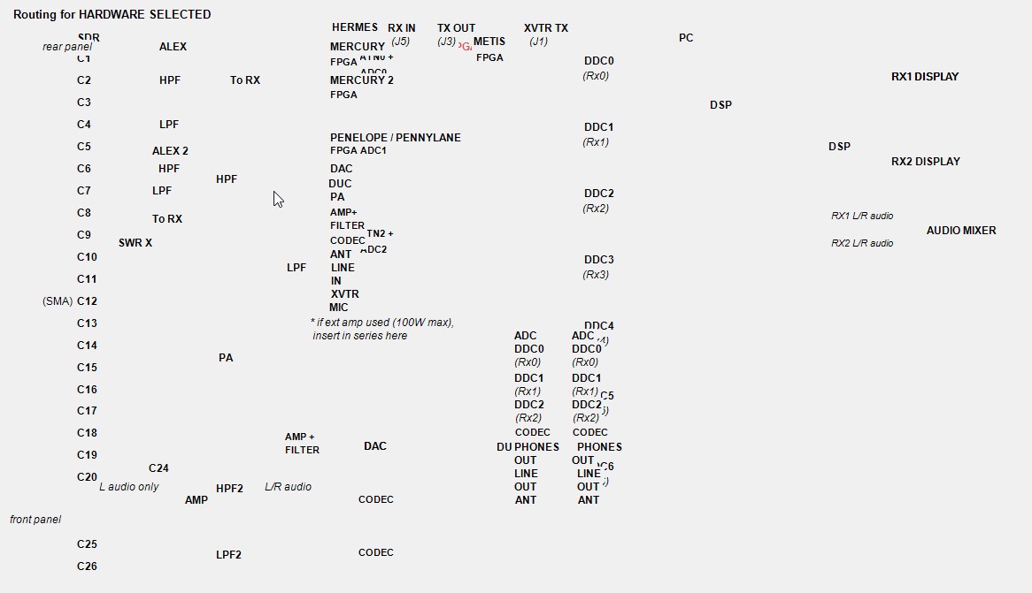

Hi Ritchie,
Thanks so much for the update, 21b working fine here.
Would like to put in a request to update the path illustrator to work with the Orion MkII boards / 7000dle mkii.
JS
JS
Hi Jeff, there is a ctun for each rx. They are not linked in any way (or at least that is how it works on my install).jeffreydoran wrote:Thetis x64, i9, RTX2060, Dedicated Ethernet

Path Illustrator looks odd on my PC (W10/21H1/64 bit) with GTX1050Ti.Taiga wrote: Would like to put in a request to update the path illustrator to work with the Orion MkII boards / 7000dle mkii.
Hmmm, the bevahiour I observe happens when the "VFO SYNC" is enabled, which is how I operate RX1 and RX2 simultaneously while listening to 2 different antennas in pseudo "stereo". To your point, When "VFO SYNC" is NOT enabled, CTUN behaves as you documented.ramdor wrote:Hi Jeff, there is a ctun for each rx. They are not linked in any way (or at least that is how it works on my install).jeffreydoran wrote:Thetis x64, i9, RTX2060, Dedicated Ethernet

That is not true for 21b.Hmmm, the bevahiour I observe happens when the "VFO SYNC" is enabled, which is how I operate RX1 and RX2 simultaneously while listening to 2 different antennas in pseudo "stereo". To your point, When "VFO SYNC" is NOT enabled, CTUN behaves as you documented.
In 21b the panafall is automatically centered at the vfo-freq on band-switching. CTUN on, VFO-Sync off.
In 21a the behavior is "correct". The panafall is positioned as last used.

For those looking for a better path illustrator: path illustrator is a very fine idea, and it certainly helps understand what is going on in the radio, but there's a lot of code that seems to be missing. I'm not sure who the original contributor for this code is, but the capability certainly seems no better than half finished. Unless I'm badly mistaken this is probably not something that would be easy for Richie to engage on, and IMHO his energies are far better spent fixing or adding the scores of other less complex features that need fixing or adding.
