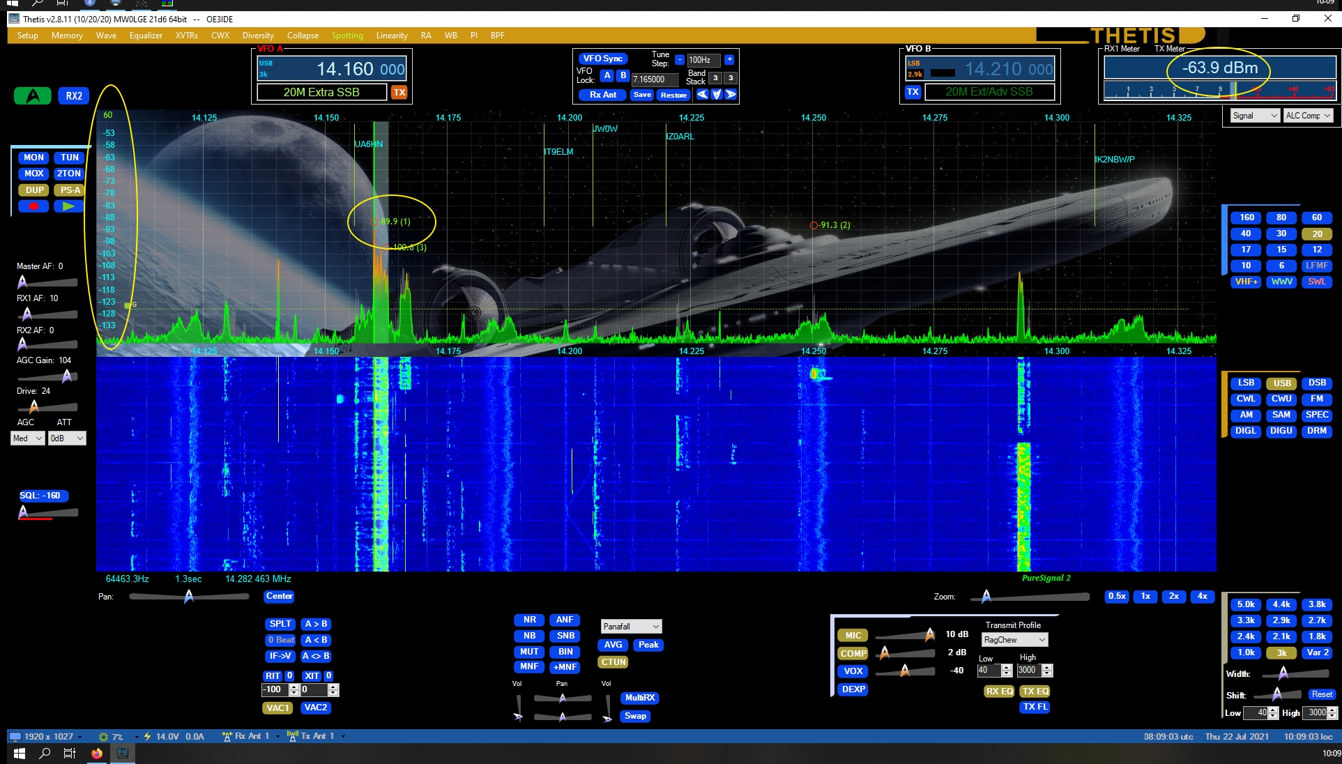

maybe it is a silly question, but which values are represented on the x-axis and the peak-blobs. It seems to be not related to the rx-meter.
See yellow marked areas in the screenshot (right click => open picture in new tab for full-image)
Thanks & 73 Ernst
							x-Axis vs peak-blobs vs rx-meter

Hi Ernst,
it is refered to the bin bandwidth, which given the 26dB difference, should be set at 7.4Hz
10 log (2960/7.4) = 26
73, Clay
73, Clay

Great post by Scott a while ago with explanation.
https://apache-labs.com/community/viewt ... =itu#p2999
