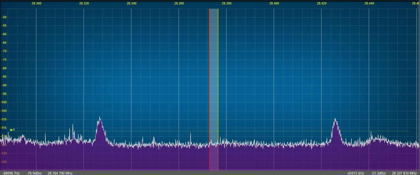

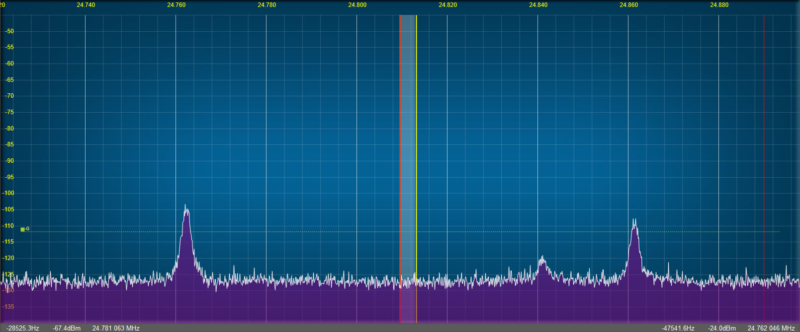

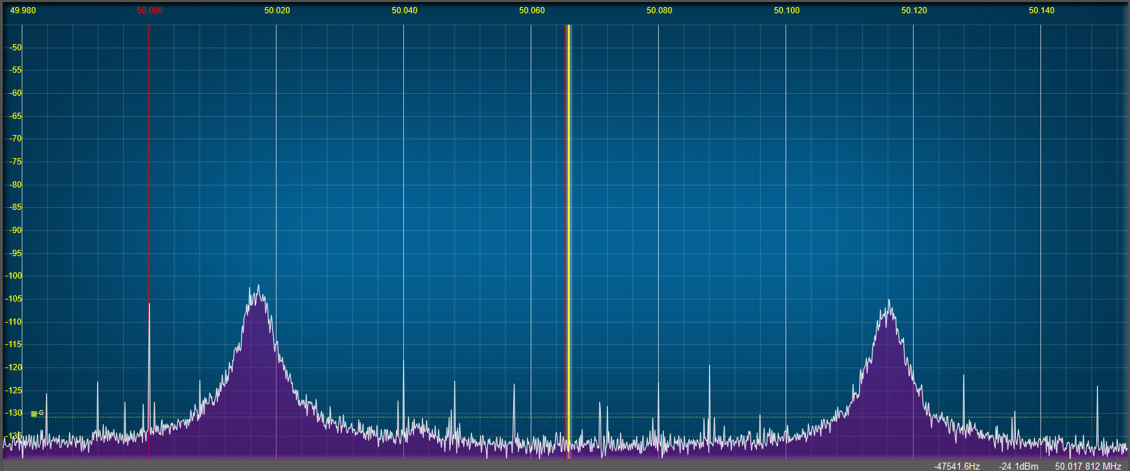

See 3 images (6/10/12 meters) to give some idea. Yes, the 12 meter images shows birdies out of band, but they repeat every 100kHz.

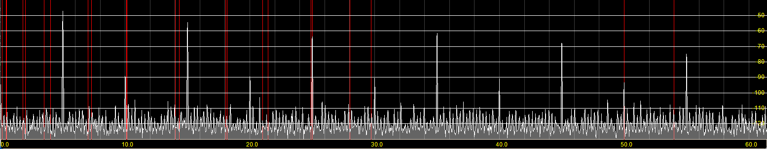

But that did help to identify what appears to be the source at 4.953MHz
It's -85dBm but reduces a lot when enabling the 60M antenna connection.

I identified my problem...it is my 2nd Bodnar GPS sitting at 4.593 but it's creating harmonics like crazy which it seems should not happen.
