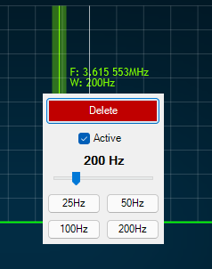

My center mouse button on my trackball no longer can set a MNF since the update. What am I doing wrong?
Re: Thetis 2.9.0 Released (updates--see first post)
ctrl right click to add 200HzW2SDR wrote:My center mouse button on my trackball no longer can set a MNF since the update. What am I doing wrong?
ctrl shift right click to add 100Hz
middle mouse to enable/disable a notch
shift middle to remove
or +MNF button to add in passband
you can also right click on a notch to bring up a popup, and drag the edges of them if you have enough zoom (although the edges dont highlight right now), oh and drag them around if you need them moved

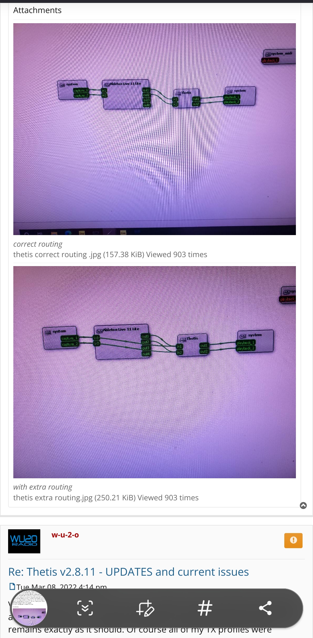

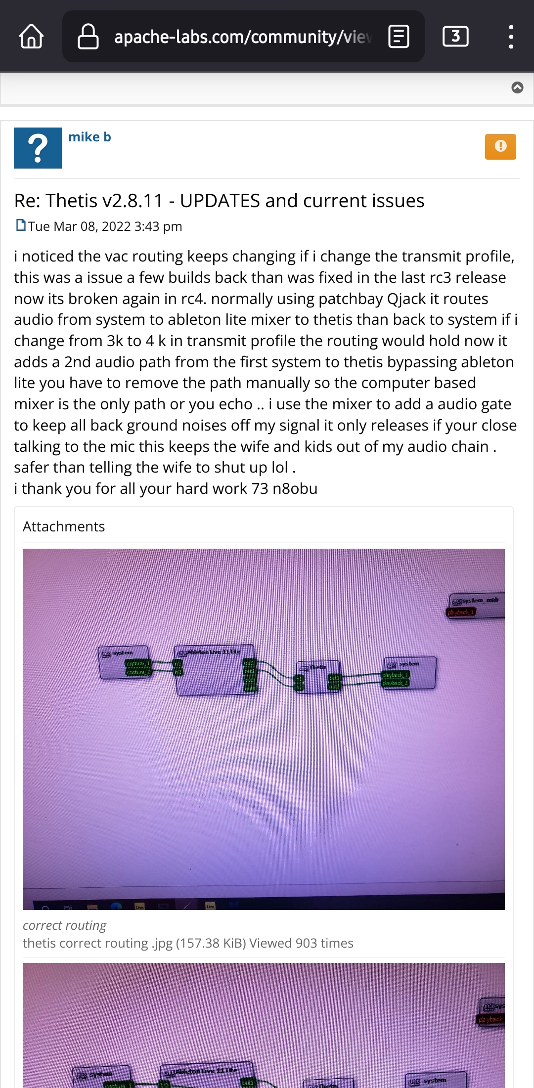

What do you mean by this, Mike? VAC does exactly what TX Profiles tells it to do. If you haven't made sure all of your profiles are saved with the proper VAC configuration for the profile, and if you haven't made sure that each Band Stack entry has the correct mode assigned to it, then you are going to get poor results.mike b wrote:also is their plans to put the vac back the way it was so it does not break the audio path if you change tx profiles we talked about it a few weeks back , thanks 73 n8obu
Also, do you have any of the TX Profile auto save options enabled in Setup > Transmit. If you do that can often lead to a lot of heartache because your profiles will often change without you realizing. I recommend those be turned off and only explicitly use the profile save button as required.
Edited to say mode is stored with bandstack, not TX Profile. But TX Profiles are stored against mode, so almost the same difference, but not quite
w-u-2-o wrote:What do you mean by this, Mike? VAC does exactly what TX Profiles tells it to do. If you haven't made sure all of your profiles are saved with the proper VAC configuration for the profile, and if you haven't made sure that each Band Stack entry has the correct mode assigned to it, then you are going to get poor results.mike b wrote:also is their plans to put the vac back the way it was so it does not break the audio path if you change tx profiles we talked about it a few weeks back , thanks 73 n8obu
This was his description from the other thread about this if it helps any.
https://apache-labs.com/community/viewt ... 530#p18682
Cory K9CDR
I'm not seeing any posts from Mike at that link.K9CDR wrote: This was his description from the other thread about this if it helps any.
we talked about this on page 52 of the last thread about 3/4 of the way down the page photos are posted there too , this is not just a i did not save it issue,, RAMDOR stated he made changes that causes this in his post and he could change it back too.
1) all tx profiles have associated audio devices with them
2) they are only recovered and applied IF the global setting is configured to do that
3) all VAC's will switch off if a TX profile is selected. This happens just before any TX profile settings are applied from that profile
4) VAC's will switch back on if the new TX profile being selected has them set as ON
Point 3) will only happen IF a setting in the incoming TX profile has ANY differences in any VAC setting (only vac settings are compared)
^^^ has been implemented already in 2.9.0+
The main reason for this was because PureAudio was doing a vast amount of work as sample rates, buffers, etcetc changed on the fly. Now it gets shut down, changes applied, then turned back on if needed.
Thus the correct URL is https://apache-labs.com/community/viewt ... start=1560mike b wrote:we talked about this on page 52 of the last thread about 3/4 of the way down the page photos are posted there too , this is not just a i did not save it issue,, RAMDOR stated he made changes that causes this in his post and he could change it back too.
Richie did not exactly say he would change it back. He wrote:
So that is a change, but not entirely back the way it was.ramdor wrote:So there is a subtle difference before and after 21k9d, however it could be improved by checking if anything is different in the about to be selected TX profile vac settings. I will probably add that in at some point, so that an unnecessary turn off can be skipped.
However, it would appear that only Jack is affected by this behavior, because nobody else is reporting it with Voicemeeter, VB Cable, Muzy VAC, etc.
However, however...there is this topic, I wonder if they are somehow related??? https://apache-labs.com/community/viewt ... f=9&t=4138

w-u-2-o wrote:I'm not seeing any posts from Mike at that link.K9CDR wrote: This was his description from the other thread about this if it helps any.
- Screenshot_20220407-193054_Firefox.jpg (1.35 MiB) Viewed 25978 times
- Screenshot_20220407-193050_Firefox.jpg (1.16 MiB) Viewed 25978 times
Cory K9CDR
Thank you Cory, but if you had read my post above you would have seen I identified the correct post already and you wouldn't have had to work so hard
w-u-2-o wrote:Thank you Cory, but if you had read my post above you would have seen I identified the correct post already and you wouldn't have had to work so hard
lol I of course see that now, it turns out that is easy when a person actually is looking and paying attention which ADHD tends to make both difficult most of the time
Edit- NVM I figured out after reading this after posting about the link--i just took URL from that page or topin vs the link address of the specific post--
