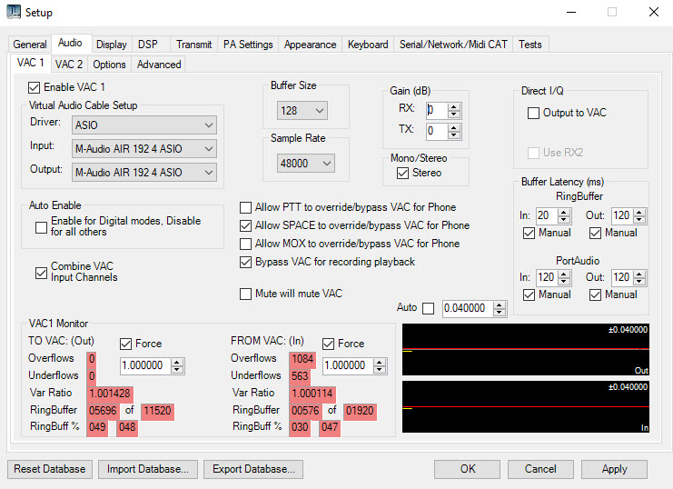

Using VAC1: 128 Buffer at 48kHz. PC is a multi-core i7, 32GB RAM, 512GB SSD machine. Perhaps I should go from P1 to P2 to solve some of the issue reported below.....? :?

2) Had to increase Ring Buffer numbers quite a bit from (Manual boxes checked) 5/5 to 25/40 on IN/OUT respectively as I could hear audio artifacts with the lower numbers I used previously.
3) Had to hike PortAudio numbers to 120 (Manual boxes checked) from much lower numbers that I used before (5 in each box) as audio artifacts were present otherwise
UPDATE: lowered numbers to 40/40 and 20/20 just now and am getting lower latency...........
UPDATE2: It seems that when I switch from one TX Profile to another I must retweak the RingBuffer and PortAudio numbers and then save the TX Profile now. IF I don't do that I get huge run-ups on under and overflow numbers. I think that on the previous much older software I used before the change I only set those on the VAC1 once, set/forget. Is there a way to save these as a default so that I just set/forget instead o]f having to do it every time I use a new TX Profile?
4) Latency increased from the moment I speak into mic to when listening to my audio in the MON. Before this change of software the latency was perhaps around 50ms and much better. I use a DAW (CPU load is still the same as before so this is a Thetis issues I believe and not DAW related). Audio quality is worse than before and even at the "high" settings shown above the audio has a lot of artifacts in it. I assume hiking the numbers even more will remedy my issue.
See screen-capture of VAC1 Form at end. Under/Overflows numbers shooting up extremely fast to numbers that I did not see on the previous software version.
Under and Overflows.jpg (152.69 KiB) Viewed 3031 times

Items 2-4: these are specifically digital audio issues and unlikely to be associated with the new version of Thetis. I've not heard anyone develop problems due to upgrading. Moving to P2 will not affect any issues you are having here. You did not describe what ANAN you are using, what DAW you are using, what audio interface you are using, nor how it is all connected. This entire sub-topic is probably worthy of it's own specific topic in the virtual audio sub-forum.
