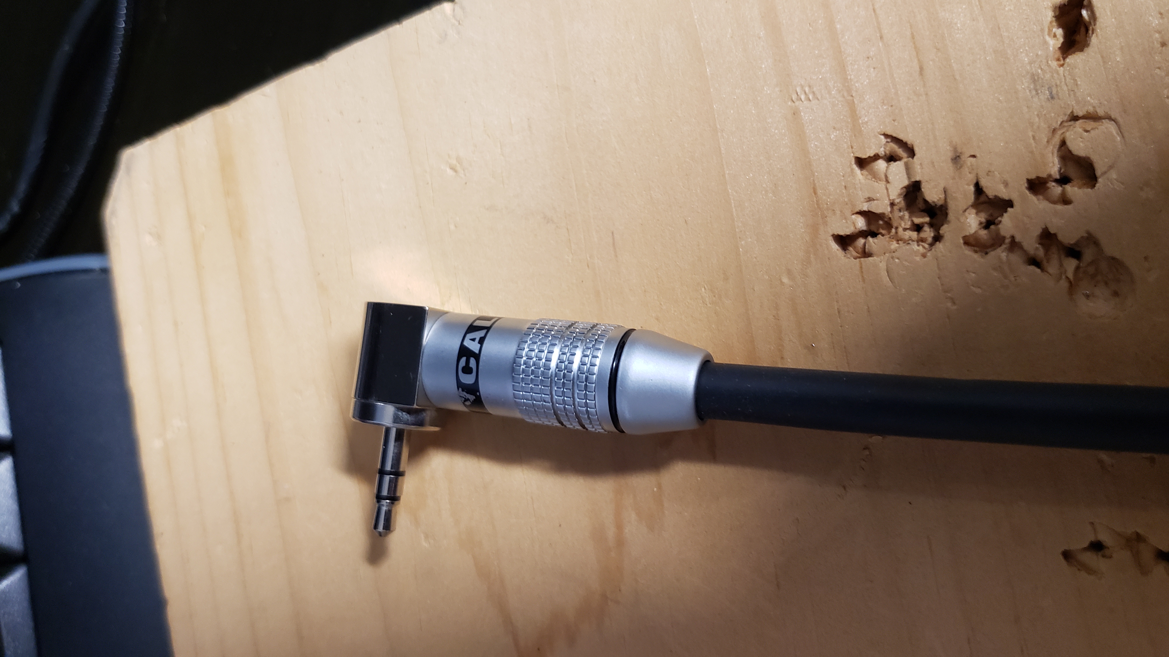

Okay it has something to do with the connector I'm using at the front of the radio. Ground disconnected cold solder joint. The old wiggle test worked. :lol:
download/file.php?id=3393 don't buy this connector the body disconnects from the trs if you tighten the shell.

That's a beautiful connector!

w-u-2-o wrote:That's a beautiful connector!
No stop on shell so it pushed out the connector you lose ground. But that was not my problem the shield was disconnected.
Those are very easy to over tighten. There should be a small gap between the barrel and the 90 Degree body. If you over tighten you suck the internals into the barrel like you have there. This is where the old fashion ugly flat 90 degree works better. You solder direct to the back of the contacts and the cover is held on with small screws. Just have to becareful not to short out to the cover/sleeve.

K4IBC wrote:
Those are very easy to over tighten. There should be a small gap between the barrel and the 90 Degree body. If you over tighten you suck the internals into the barrel like you have there. This is where the old fashion ugly flat 90 degree works better. You solder direct to the back of the contacts and the cover is held on with small screws. Just have to be careful not to short out to the cover/sleeve.
Yes, next time I am going to order the switchcraft connector. But now I am using the cmASIO and man it works good.
