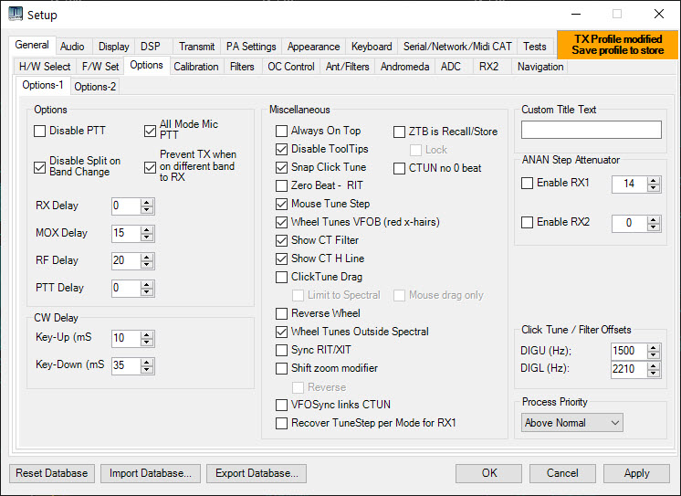

Richie's comment at https://github.com/ramdor/Thetis/issues/228 on Oct 24,2023 and, particularly, where he states "This only happens in CW mode as the internal TRX clack back and forth with semi break in delays of approx 250 ms" is huge!
As others have pointed out, I really should update to a much improved Protocol 2 firmware version as I am on CW quite a bit, including in big CW contests, once or twice a year. I have operated for several hours (12-16 hours or so) in contests, but had not experienced any hot switching issues with my Solid State amp although my RF, PTT and MOX delay times were very low (I am using these on SSB too). Same with key-up and key-down times.
Can anyone of you CW operators provide screen-shots of your delay times? I already have some from W9AC although he has done hardware mods that no doubt help him "get away" with much shorter delays than I would.
Below, see my current numbers.
General Options1 settings.jpg (152.43 KiB) Viewed 29579 times
Perhaps I need to tweak these numbers?
Best,
rainbow
