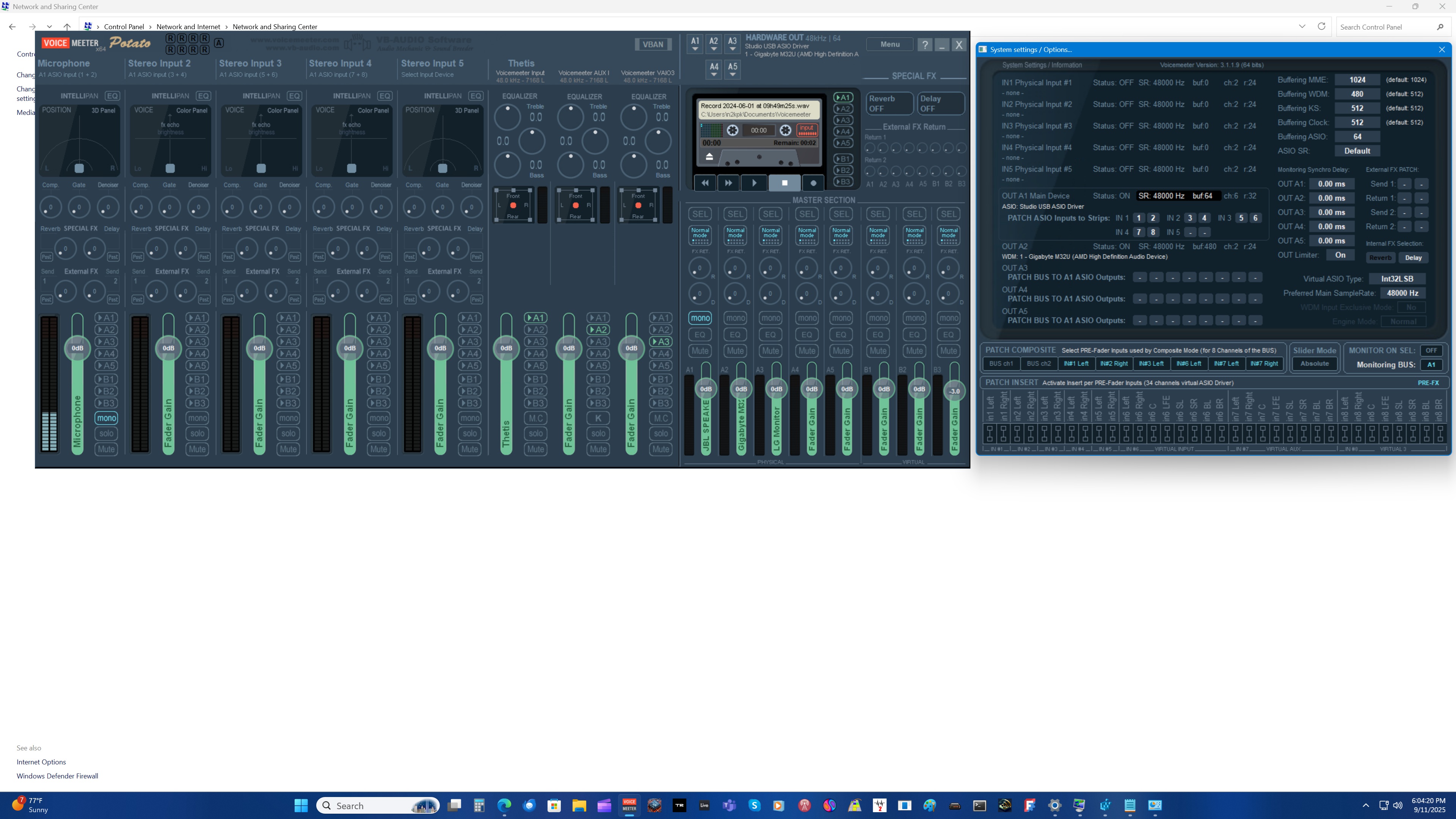

Today I tried another computer, my laptop. And got the same noise.
Posted a pic of potato settings does anyone see anything wrong?
Thetis voicemeeter config.jpg (1.06 MiB) Viewed 1647 times
Jay N2GQ

n2gq wrote: Sat Sep 13, 2025 6:22 pm Today I tried another computer, my laptop. And got the same noise.
On the first channel with the mic input you do not have the B1 send turned on to route audio from that channel to Thetis.
On the second and third virtual channels you have the A2 and A3 sends activated, these should be turned off.
On the first virtual channel you have the A1 send routing audio from Thetis to your Presonus speaker outputs, so that it good.

w-u-2-o wrote: Sat Sep 13, 2025 9:58 pm

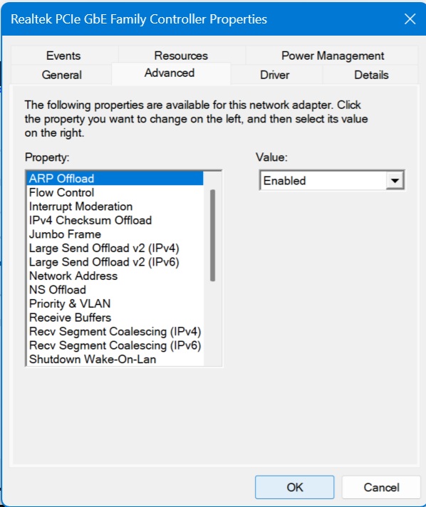

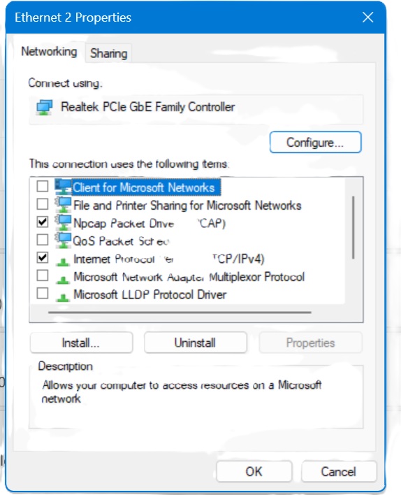

I have the nic card config network setting as follows.
nic config 1.jpg (95.37 KiB) Viewed 1590 times
But the other settings I believe are default once the sequence errors were corrected, I had left them default since all worked. Such as flow control etc.
nic config 2.jpg (97.92 KiB) Viewed 1590 times
Jay N2GQ
