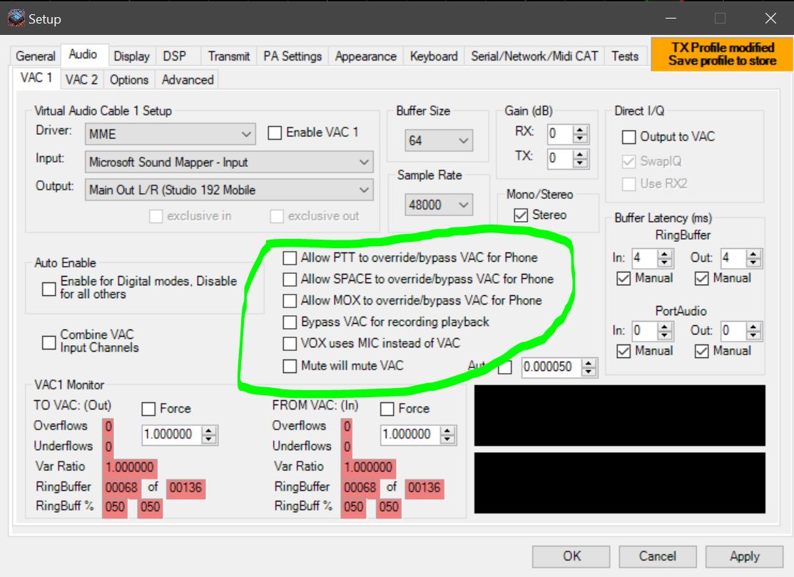

Normally, when running phone of any type, and with the mic plugged into the ANAN, VAC should be OFF. You can accomplish this by saving a TX Profile for phone, as it will save the VAC state, among many other things.
Similarly, when running digital modes of any type, there can be a TX Profile for this where VAC is ON.
Here is a video that covers how to use TX Profiles. I strongly recommend you do this, i.e. have a separate TX Profile for phone and another for digi modes.
As Thetis is super flexible and complex, there is yet another way to handle this problem. The VAC implementation has options that allow a phone transmission to override VAC, depending upon how PTT is asserted (MOX, PTT switch, etc.) These are illustrated in the image below. The original purpose of this feature is so that contesters could use a voice keyer via VAC, but immediately override it with a normal transmission from the microphone when necessary. Thus you could leave VAC ON, connected to your digi mode app's, and still transmit with the mic. However, the limitation with this method is that you have to choose to use normal USB or LSB modes for BOTH situations, OR choose DIGU (nobody uses DIGL). This is a major limitation, therefore I can't recommend it.
