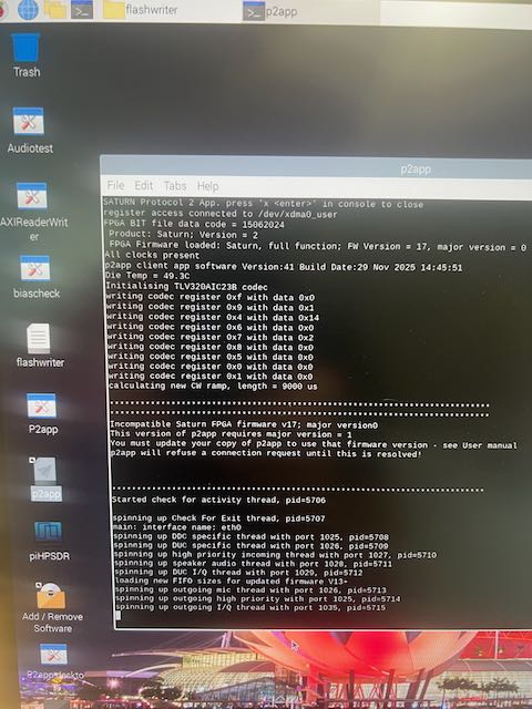

Thanks, that bit worked great. I then ran only the update-G2.sh script, and looking through the log file it seemed to process everything ok. Unfortunately, the Flashwriter app does not seem to be among the desktop icons any more. There is just a text file (see pic). When I ran the P2app to re-check firmware, it says the firmware v17 (major version0) is not compatible because p2app requires major version = 1, so I may have a chicken and egg problem in that I can't flash the v25?
There is still a Flashwriter directory with what looks like everything in it. Do I just execute directly from there?
UPDATE: Rebooted the pi and Flashwriter was there on the desktop as it should be. I then ran the update to v25 with success.

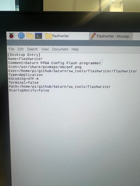

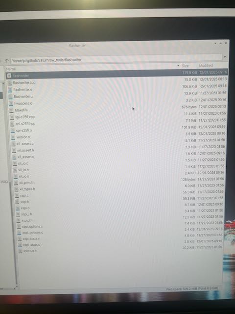

WB9HKO
Posts: 9
Joined: Sun Nov 16, 2025 6:52 pm
Re: G2 Updated files and simplified update procedure
Post by WB9HKO »
Text file on desktop
Flashwriter directory - 1.jpeg (218.31 KiB) Viewed 2315 times

laurencebarker
Posts: 335
Post by laurencebarker »
you can run flashwriter from its own folder:
cd ~/Saturn/sw_tools/flashwriter
./flashwriter
if there is no flashwriter application file:
make clean
make
Laurence Barker G8NJJ

Posts: 9
Post by WB9HKO »
laurencebarker wrote: Mon Dec 01, 2025 7:45 pm you can run flashwriter from its own folder:
./flashwriter
make clean
make
Thanks Laurence. I figured out to reboot the RPi and everything worked perfectly after that. Flashwriter app icon appeared, so I was able to upgrade to v25 on the FPGA also. Already made a few contacts today :-)
