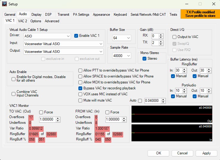

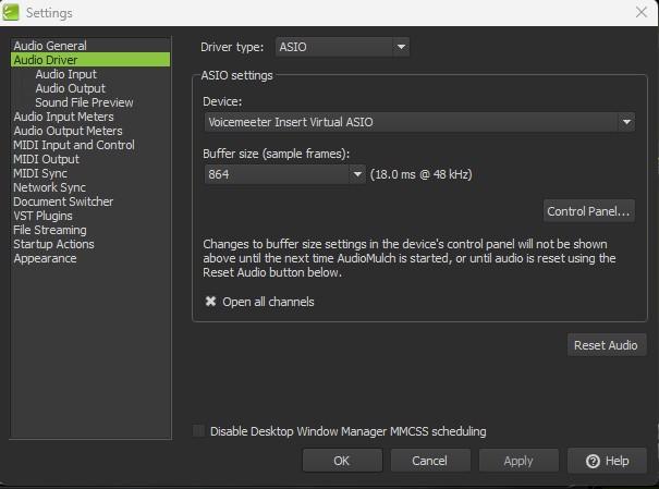

I try to figure how to make it but no success so far . I will surely need some help or screenshot or any example of CMASIO config i guess .
«As for the DAW, I assume you are using the Voicemeeter VAIO Insert driver to move audio between Voicemeeter and the DAW» Yes i use Voicemeeter Insert Virtual ASIO on AudioMulch

- setting audiomulch.jpg (48.08 KiB) Viewed 99 times
- Voicemeeter Virtual ASIO.jpg (109.99 KiB) Viewed 99 times
