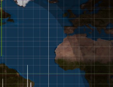

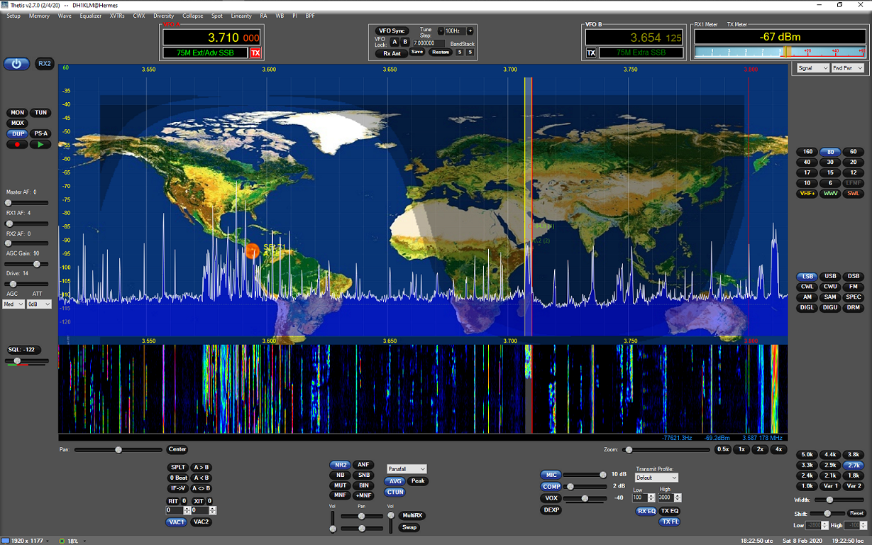

is there a way to remove the grid in the worldmap pic which is shown if "Track" is active in DX / SWL Spotter?
I always see both grids, the one from Thetis and the other one from DX/SWL Spotter.
I assume the shown grid is part of the pic itself and can not be removed.
Maybe it is possible in a newer version from KE9NS.
Of course it is also possible to deactivate the grid in Thetis, but I don't like that.

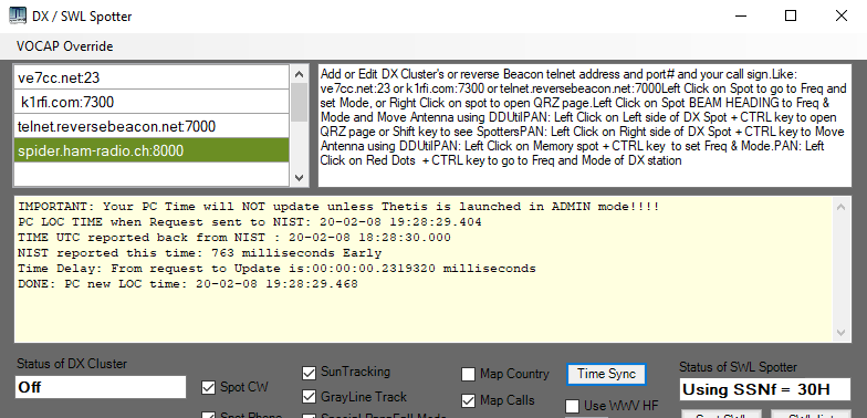

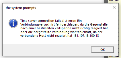

I also noticed that "Time Sync" is not working.
Obviously NIST Time Server cannot be reached.
But it doesn't bother me, since the time is synchronized via Windows anyway.

I assume you misunderstood something.
Deactivating picDisplay does not hide the grid on the DX/SWL Spotter worldmap, the worldmap pic completely disappears. Also adjusting the Alpha of Appearance> Grid> Background is not useful because it only changes the grid in the RX display and not that of the worldmap.
It's just a purely cosmetic thing, I just don't like the fact that the worldmap pic has its own grid, which also has no real benefit.
I think the worldmap pic could be replaced, but apparently it is embedded directly in Thetis.
At least I couldn't find it in the skin directory or anywhere else.

The grid is part of the actual photo used for the map
Perry

Already replaced it with another one. I have to test a few others as well.
I also changed the non working timeservers in DX/SWL Spotter.
It's not really important, but it annoyed me that the function didn't work.
