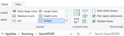

Thanks Scott
Minor point -- 'AppData' is a hidden file, so in File Explorer click View Tab then , if needed, check 'Hidden Items'
C:\Users\username\AppData\Roaming\OpenHPSDR\Thetis-x64
Delete Thetis-x64
Re: File is not in the correct format
If you type the path manually into the File Explorer path box you don't have to change For Explorer options.
