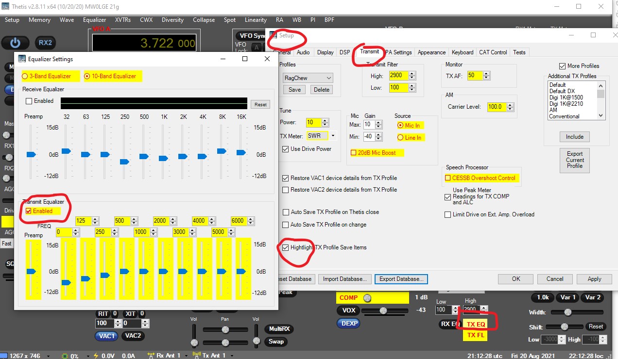

Hey,ramdor wrote:TX EQ on/off state is stored in the tx profile
You can select an option in setup to highlight everything that is stored in a TX profile, for checking purposes.
I don't see the parameters below at all behind the Transmit tab.
- These Transmit Tab Parameters are missing.jpg (11.52 KiB) Viewed 5695 times
Re: Why does TX EQ revert to ON?
JJ4SDR wrote:Hey,ramdor wrote:TX EQ on/off state is stored in the tx profile
https://apache-labs.com/community/viewt ... f=9&t=3817

The link was to the beta/patched version of Thetis which can run P1 or P2. The beta includes the check box for highlighting TX profile items, amongst many other things.JJ4SDR wrote:Richie,
Not sure if this has anything to do with my observation but I am using P1 and will only start using P2 once I am much more familiar with Thetis.

thetis 2.8.11 and the patches that follow can run both Protocol 1 and Protocol 2.JJ4SDR wrote:Richie: Does this patch work with Protocol 1 or is it tied to Protocol 2? I am just learning how to walk and won't upgrade to Protocol 2 until after I have learnt how to run? Will need to learn how to run patches too.ramdor wrote:JJ4SDR wrote:
