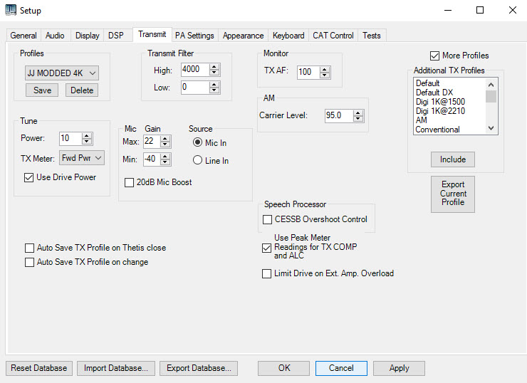

I have no such option on the Transmit tab. See screen-shot below. Perhaps that is something that running a patch would get me (I will need to learn how to do that first)? Thetis 2.8.11 (not sure which "flavor" ) under P1.
JJ
- Transmit Tab.jpg (96.97 KiB) Viewed 2673 times
Re: Can I “toggle” between Thetis and DAW processing in same Data Base
Which version of Thetis? This feature was recently added as noted in the release notes. 21g is the latest and has a fair amount of bug fixes.
