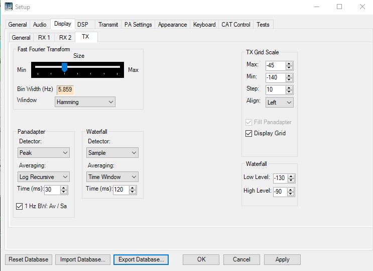

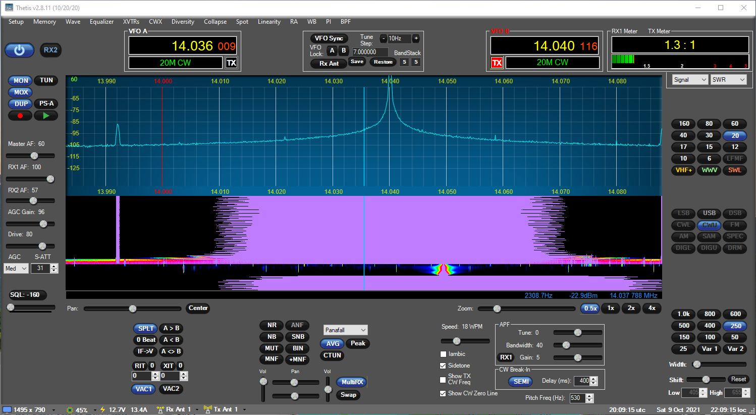

I would like to view the transmitted signal in the panadapter, mostly when I am working in split.
I enabled the DUP and MultiRX functions but the signal shown is actually huge, about 60 KHz, as you can see in the picture below.
I am wondering if i am missing some config parameter or there is a way to reduce the TX signal bandwidth.
display tx settings.jpg (49.51 KiB) Viewed 2893 times
Re: Unreadable receive display on mox
Change the TX Grid Scale to max 15, min -17, step as desired.
Change the waterfall low level to -70, and the high level to -20.
Any energy below -70 is simply a "don't care", no one will ever see it or hear it.

w-u-2-o wrote:Change the TX Grid Scale to max 15, min -17, step as desired.
Thank you very much dr Scott,
now it is far better.
73' Enzo
