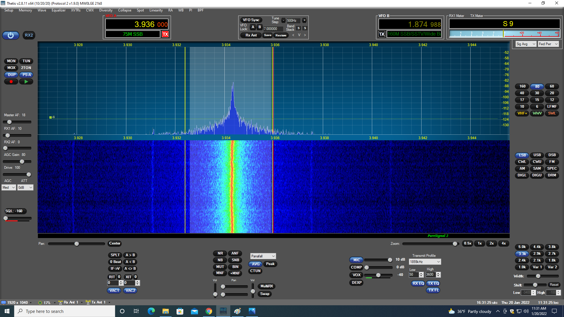

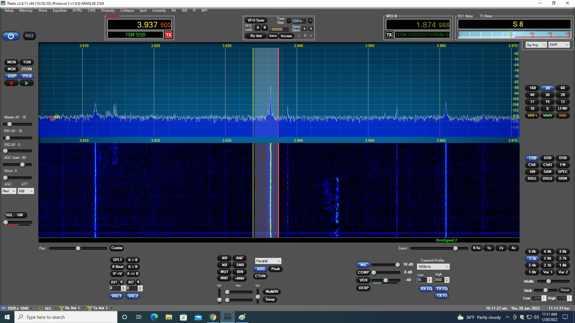

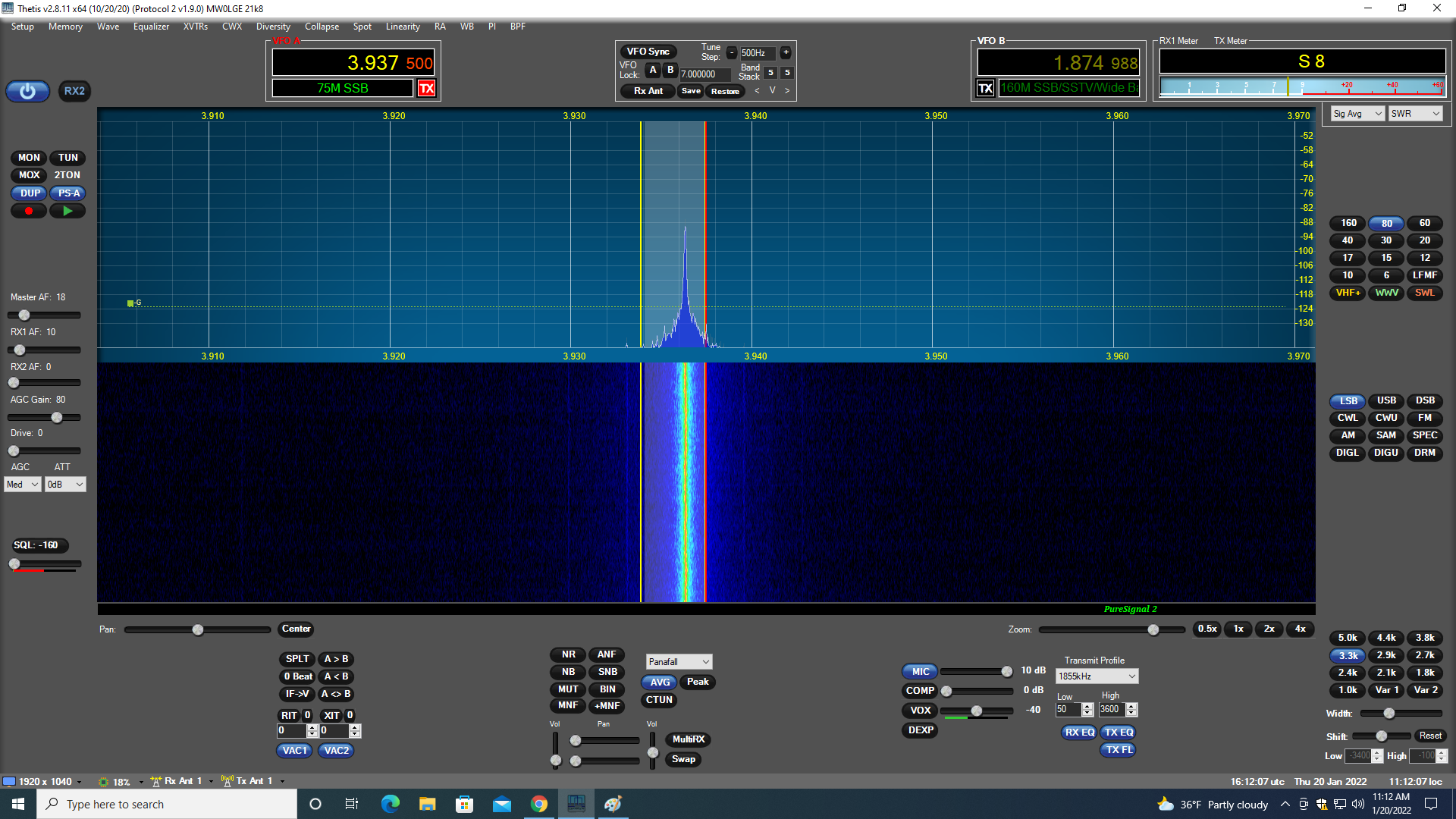

I thought it was from my temporary desktop, but it appears it's within my 200D. It's a steady S-8 (-79dBm) at about 3938.5kHz and ever so slowly drifts low in frequency. I found a few more similar ones, on 2624kHz, 3283kHz and 4591kHz.
Any thoughts as to a remedy? Screenshots are attached.

The 6M preamp will have no bearing on this problem given that it is on 80M.
As far as I know, nobody has ever experienced an S9 birdie (internally generated spur).
I see you have run the unit into a dummy load. Have you also tried running the unit off a battery instead of a power supply?

On my 200D I do not see any of these spurs with a dummy load in place. There are no spurious emissions at all that I can see in this range. Peaks of that size are more likely to come externally rather than from the rig. Or possibly a fault in the rig?
