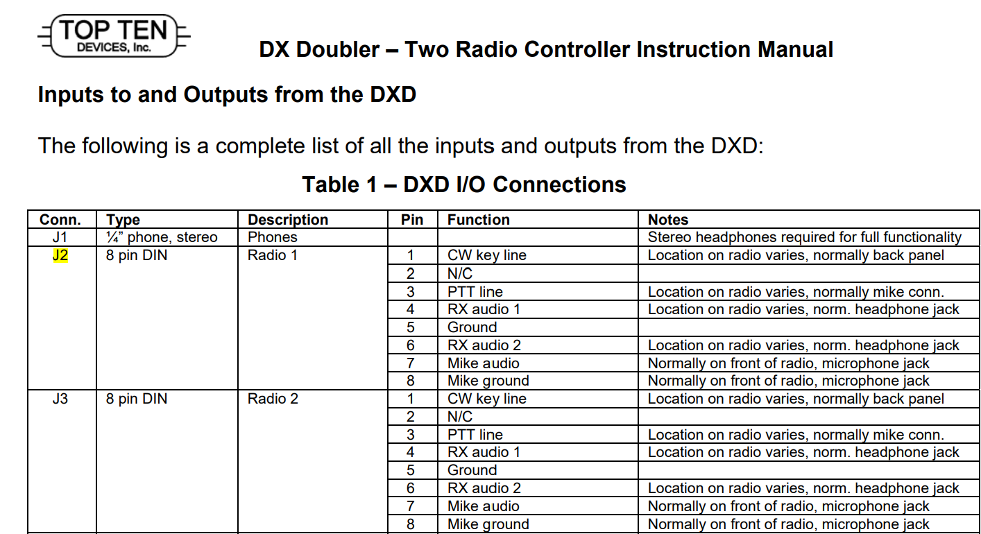

I have read the manual. I thought that it will have an entry for setting up Anan type of radio but this device is from the Flintston's era!
J2 / J3 are the 8-pin DIN. I will work in figuring out what pins to connect the Anan lines,

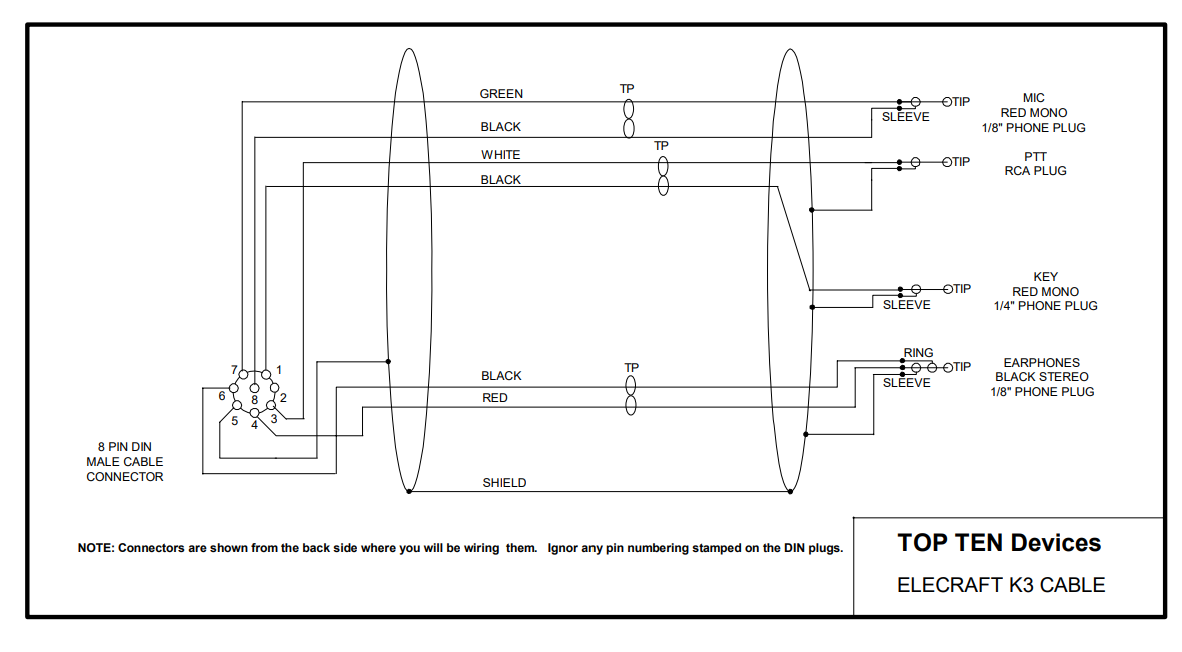

I think I can use the Elecraft diagram,

Other than it's prehistoric style LPT port for software control it's not really any different than any other two radio/four receiver mic/key/audio switchbox sold for SO2R op's.
The Elecraft cable pictured will not work. However, it does provide a nice schematic to mark up with a red pencil based on the actual pinouts of a 7000. You do have the necessary 7000 documentation to work from, I hope?

Thanks. Yes, I'll use the Elecraft as a reference.
