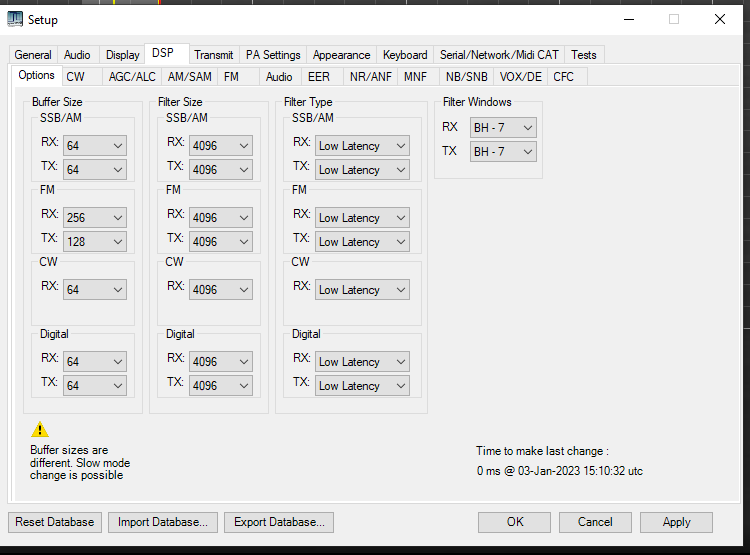

I have Cpu I7 (10)
ANAN directly connect to PC.
- Capture.PNG (34.11 KiB) Viewed 15480 times

Then your problem is probably that your specific Orion MKII in your 7000 does not close timing properly with 2.1.18. Try a different/earlier version of P2 firmware (links in the first post of the firmware topic where you got 2.1.18).
