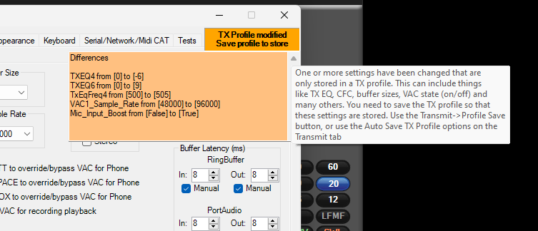

With regards to the orange box that appears in setup if a TX profile related setting has been changed and the profile has not been saved. In the final release of 2.10.2 you will be able to click that orange box to get a report of what has been changed.

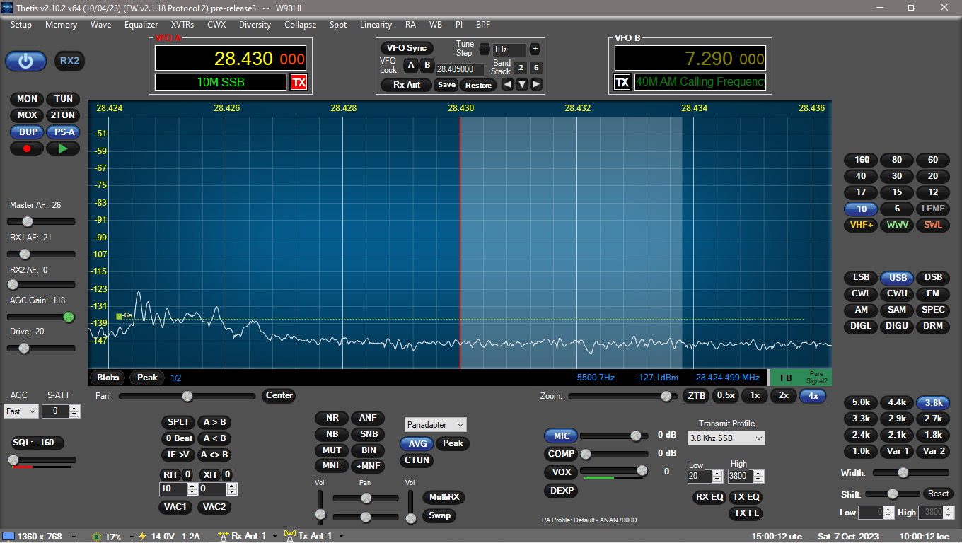

I think I found a bug in the pre release 3.
When you go to collapsed mode and back to expanded mode, the meters disappear. Restarting Thetis brings them back.
Screenshot (206).png (252.9 KiB) Viewed 27873 times
I am including a screenshot.
Thanks Don W9BHI

@don, was this from a fresh start into collapsed? and then you went to expanded? what was the order of things for it to happen? and did you use the checkbox at all in setup to turn them off?
EDIT: yes replicated, for now, just tick on the box in setup form under setup->appearance->Use legacy meters

BTW, the checkbox for Use legacy meters was already checked.

Interesting...when the meter goes away, if you toggle the use legacy meters checkbox tick mark of then on, the meter comes back.

yeah, line of code entirely missing to put them back, it was either a CTRL-Z moment, or lack of sleep, or both ;)
Will update the msi shortly.
