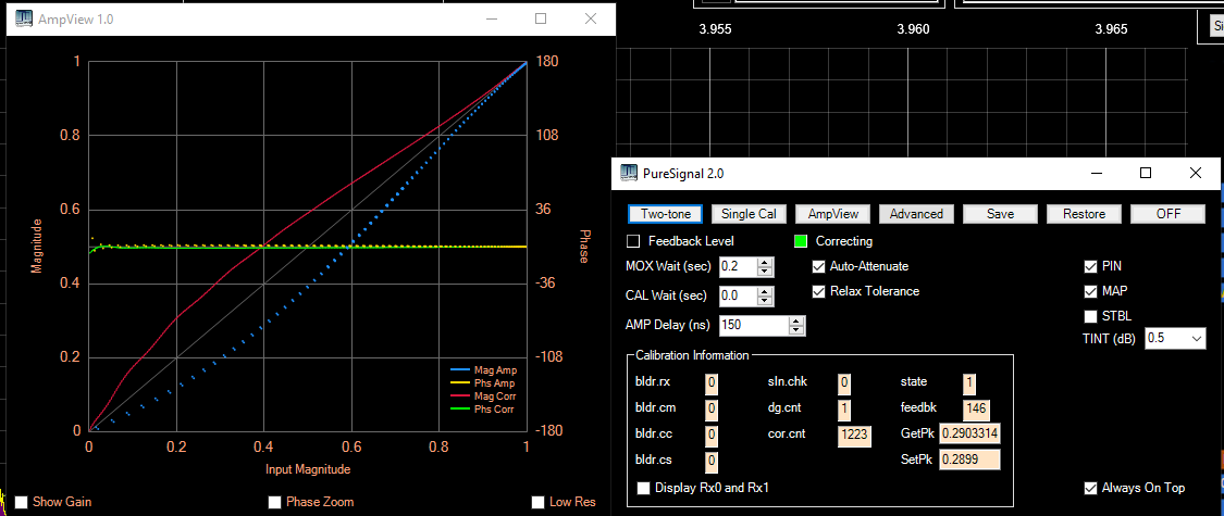

I just got the new coupler from WaveNode Inc. This is the first try with PS running the amp.
Amp is a Acom 1500 running 500 watts output. Looking at the AmpView window, it appears we are ready to roll.
Any comments good or bad?
Larry

It looks fine. What step attenuator value are you getting during transmit at 500W?

w-u-2-o wrote:It looks fine. What step attenuator value are you getting during transmit at 500W?
14-15db

That's fine. It looks like you are in business.

I too am just starting with Pure Signal. Using Thetis with a 7000dle.
Where do you read the step attenuator with Pure Signal?

When you are transmitting the ATT (or S-ATT if you've switched it to that mode) indicator at the lower left part of the main console will show the step attenuator value being used.
